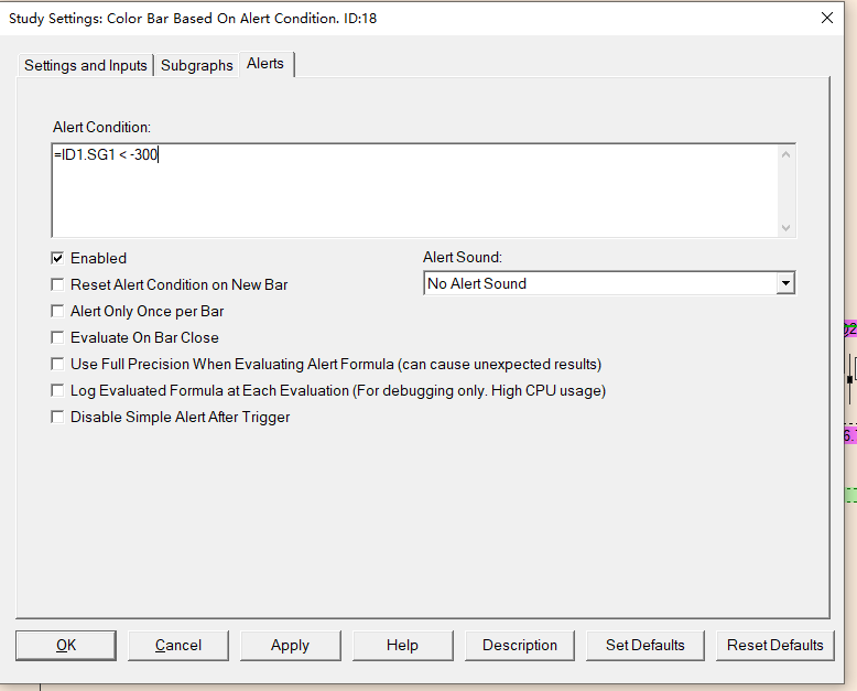

thank you for your clarification. It works on the candlestick when I set the value >500 and the color matches but won't work when i set the value <-300, no color changes. can you help me with that?
imagepic.png / V - Attached On 2024-11-21 19:43:34 UTC - Size: 22.72 KB - 222 views

Do you have bars in which the delta is less than -300? If you have a bar that meets this criteria (you see the value in the Numbers Bars Calculated Values) and the Color Bar is not working then we would need to see an image showing the Numbers Bars Calculated Values and the bar not colored. Refer to the following for how to get us an image:

sorry that was my bad, turn ID7.SG1 to ID1.SG7, wrong number. Thanks!
