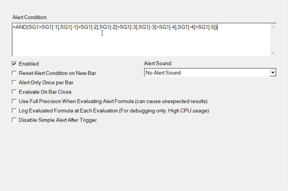

imagehull slope alert.PNG / V - Attached On 2014-09-16 11:58:11 UTC - Size: 58.13 KB - 770 views

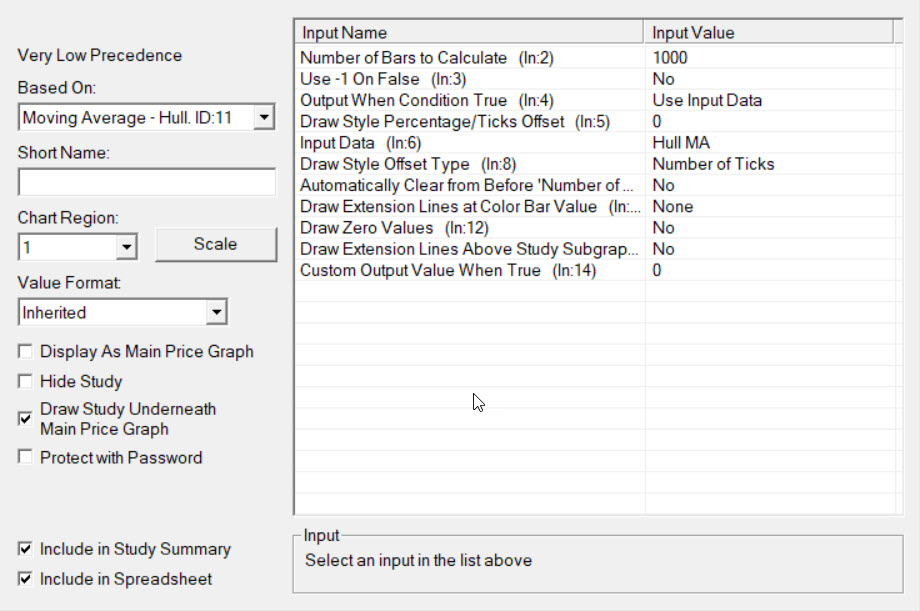

[2019-11-14 04:20:57]
madness99 - Posts: 35
Hi Tom,
I try using your alert formula but I don't see lines on my chart like yours.
I have attach couple screenshots.
Jerome
imagePicture1.jpg / V - Attached On 2019-11-14 04:20:36 UTC - Size: 135.7 KB - 632 views
imagepicture2.jpg / V - Attached On 2019-11-14 04:20:42 UTC - Size: 74.38 KB - 610 views
[2019-11-14 04:38:26]
Sawtooth - Posts: 4361
The line you see on my chart is the Hull MA, colored for slope.
The colored price bars you see show where the formula is TRUE.
What 'lines' are you expecting to see?
