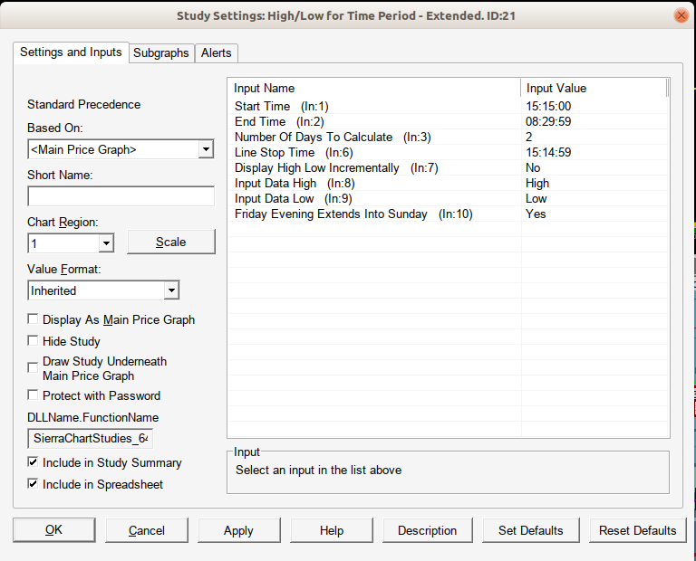

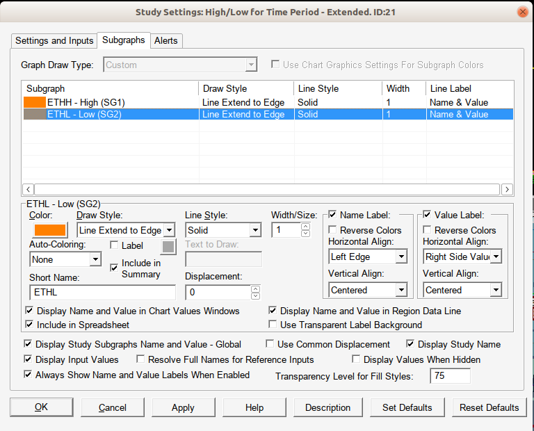

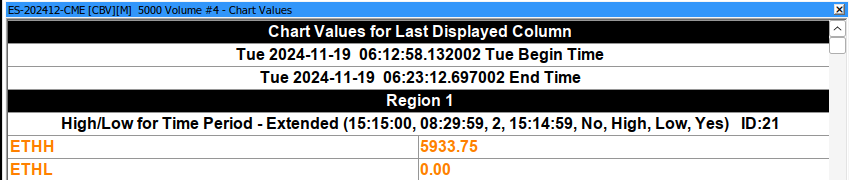

I changed the study to 'High/Low for Time Period - Extended'
The High is displayed correctly, but the Low is set to zero?!?!?!

I experimented with the settings.
The problem disappeared after I changed the 'Number of days to calculate' to 0, which SC converted to the default (10000). After that the Low line was correct. It stayed correct when I changed this setting back to 2.
Maybe there is a problem in the initialization of this study when 'Number of days to calculate' is set to something non-default when adding the study and before it is applied/visible on the chart? Just a wild guess.
Anyway, problem disappeared here.

[2024-11-25 13:44:03]
User512353 - Posts: 198
Had the same problem again today (Monday) after loading the chartbook. The Low was zero, as shown in post #3 above.
Setting the 'Number Of Days To Calculate' to zero, which SC changes to 10000, and then back to 1 solves the problem.
Maybe this has something to do with the weekend, because I have not observed this during the last weekdays.
