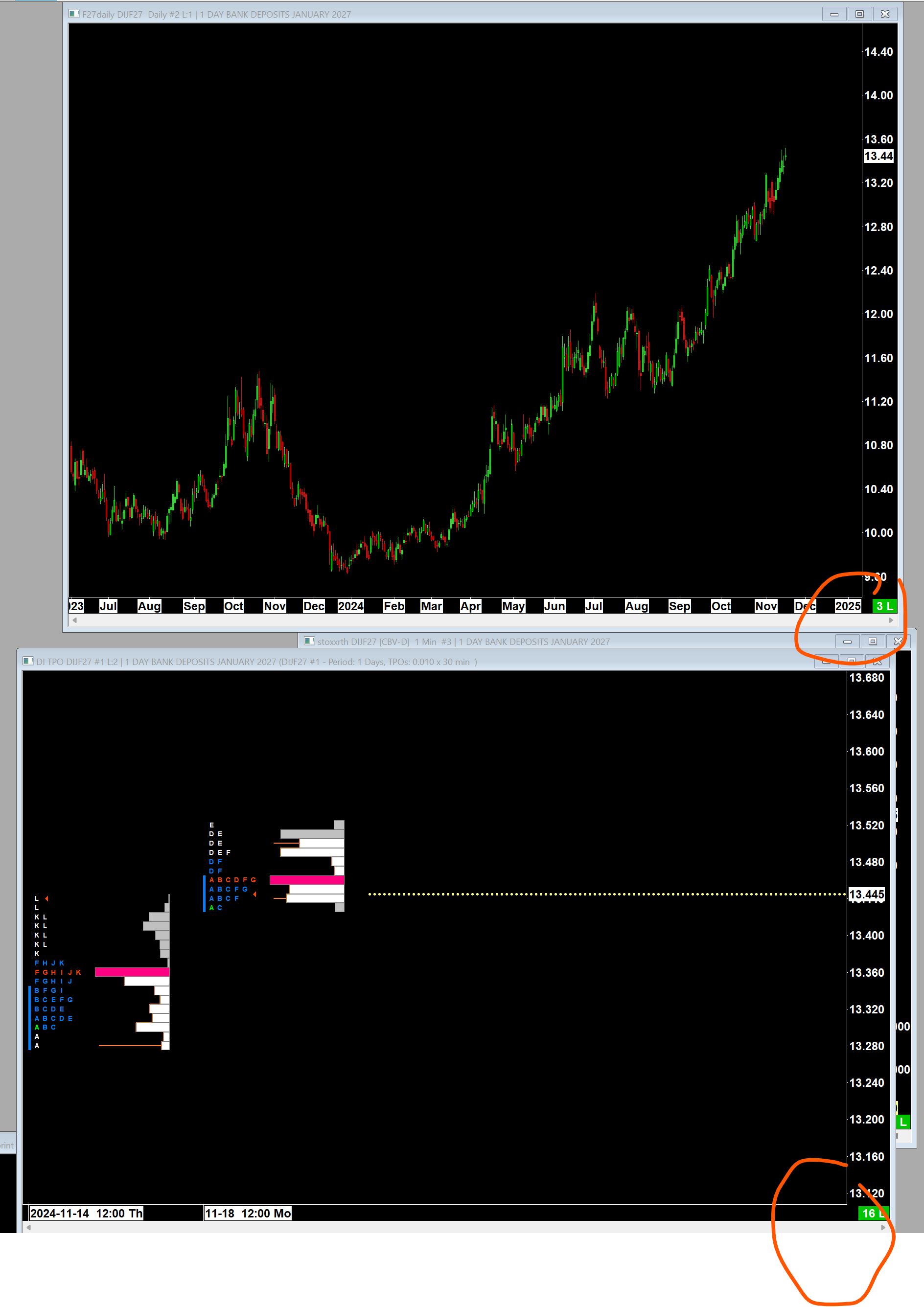

Hi John,
I knew you'd be mad if I sent another email, so am sending this update thru the normal route. Everything is so out of whack with my charts. I took 4 charts and studies from my main setup and installed on this machine. I have changed all the symbols, the tick sizes, and the time zone(note you do not have a drop-down for Sao Paulo which seems odd as the exchange is pretty big) I custum made it for -3 UT. Here is a description of the 4 charts 1-tpo loads, but tho there are 100 days, that is what I get and nothing more 2- 60 min seems ok 3-this should be a one minute chart with moving median on zone 2 but it won't load at all 4-the bottom chart should be a delta footprint with a study from Prop Alpha. Instead it's a mess.
Some is NO bueno, I am trying but it's all bad.
Karen
imagesc.PNG / V - Attached On 2024-11-17 13:47:13 UTC - Size: 258.64 KB - 297 views

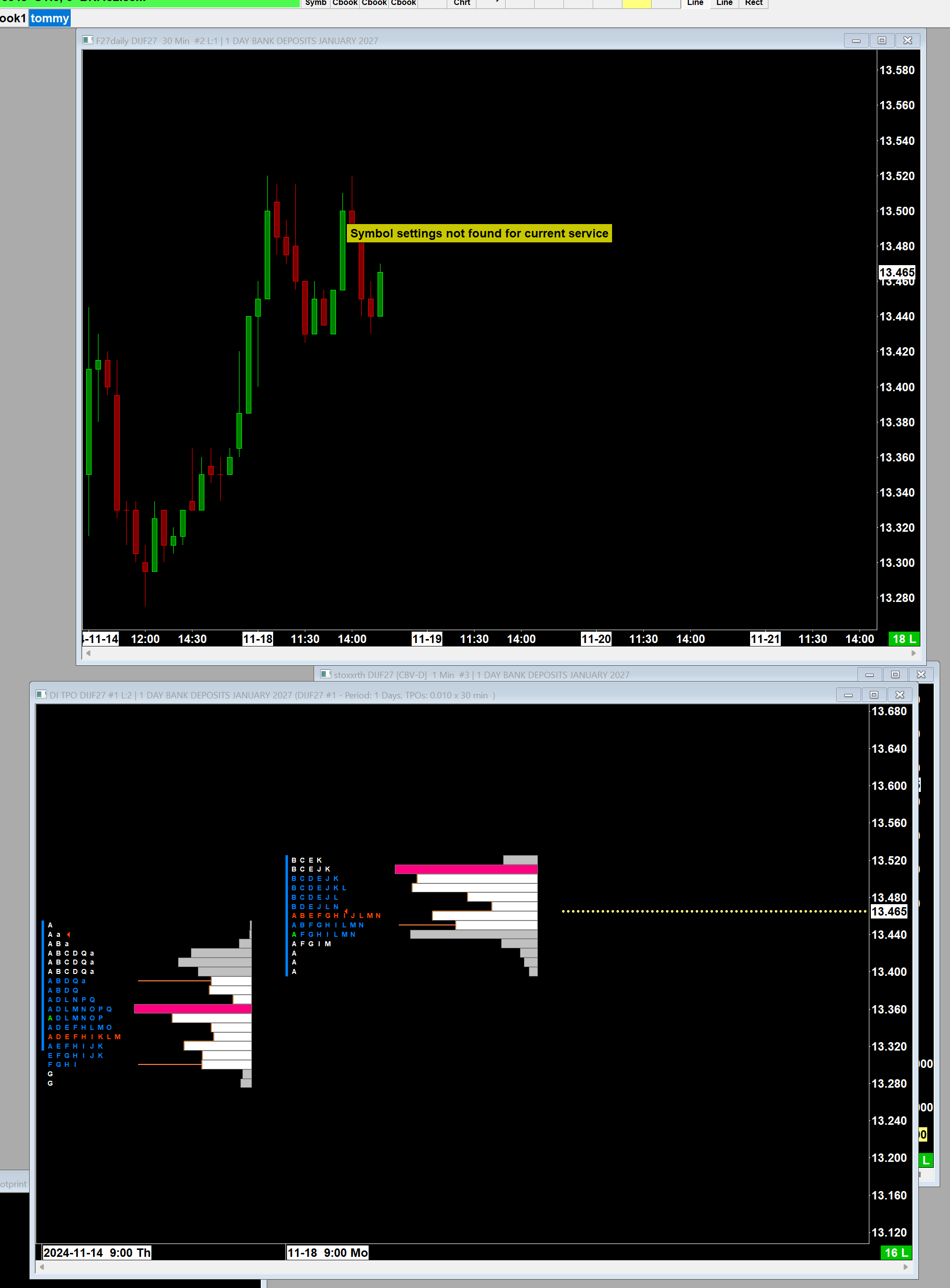

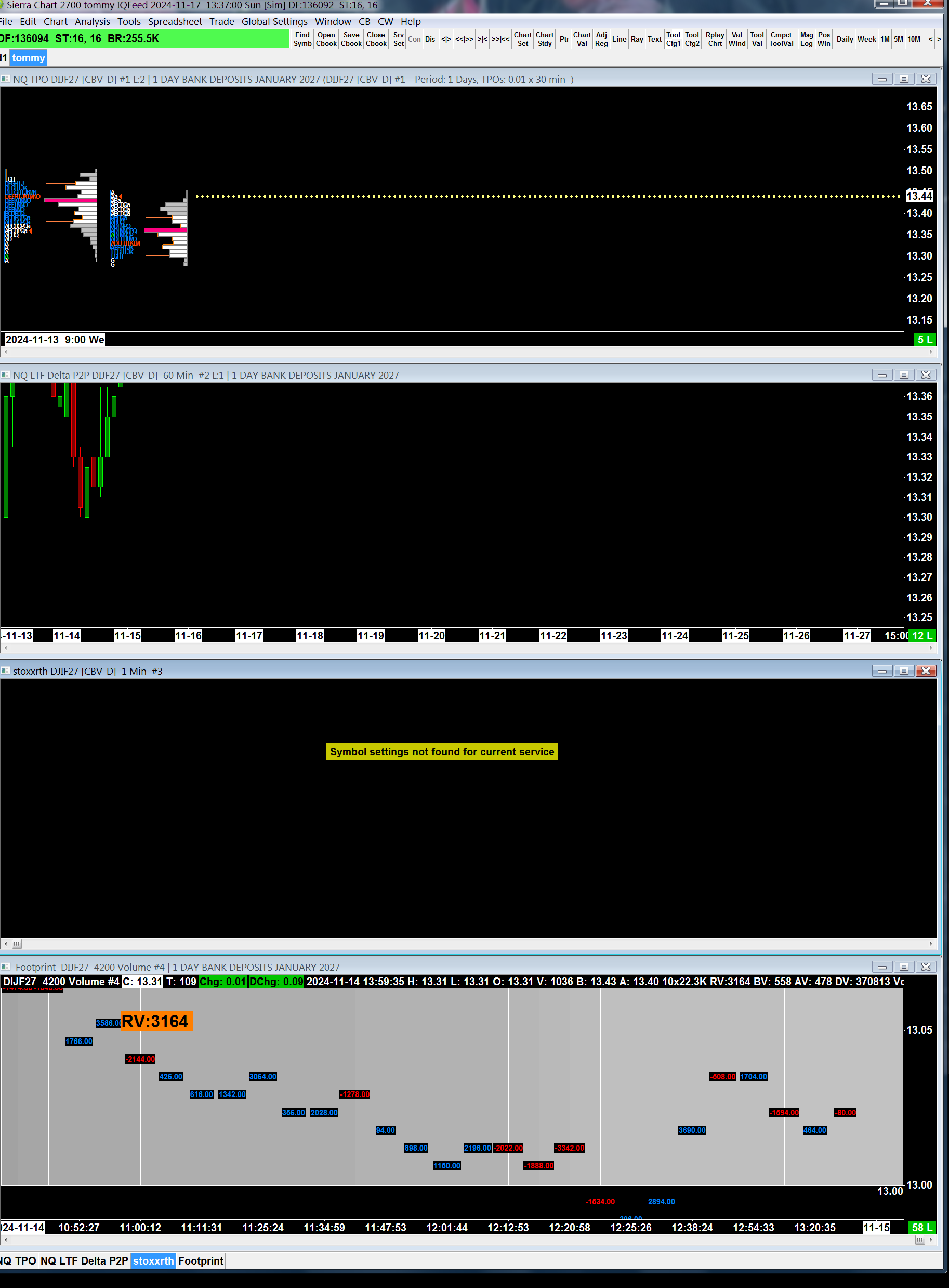

John,
thank you for your reply. I have downloaded a new version of SC into my big computer that runs All Service and Teton. I just successfully connected to IQ. I created a new chartbook and a brand new chart with nothing on it. First, every chart I create with DIJ...comes up with yellow 'symbol settings not found...' see 1st attachment. The chart appears to work but this banner comes up for the first 2min. Second, I created a tpo which has 150 days but it is stuck on 4 days only, and won't obey the number of days to load. Do I have to switch on something? I am sorry I did try googling but nothing comes up. So how do I get this to give me all the days please?!
Sorry to bug you, I am trying soooo hard. Karen
imagedi.png / V - Attached On 2024-11-18 16:12:32 UTC - Size: 106.44 KB - 248 views
imagetpo.png / V - Attached On 2024-11-18 16:31:38 UTC - Size: 404.13 KB - 250 views
[2024-11-18 16:38:44]
User849502 - Posts: 485
John,

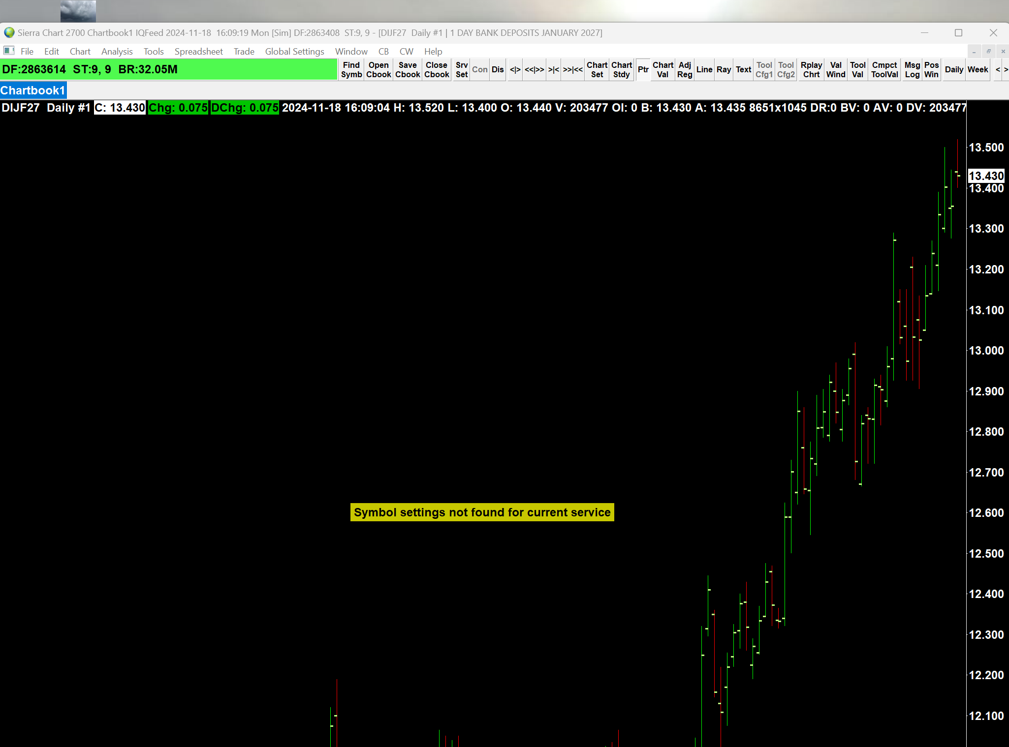

[2024-11-18 16:58:11]
User584084 - Posts: 347
Is there a reason why your charts are set to January 2027, more than 2 years in the future? There won't be much data that far out. Try looking at DIJF25 January 2025.
[2024-11-18 18:12:24]
this is a stir product, trust me I know what I am doing here. The Jan 25 is now just spot. These contracts go out many many years. You know what a STIR is right? So there is something wrong with tpo settings.I can a plain daily bar chart for this '27 contract and it's fine back 2 years. It is an issue with the tpo.
so you can all see here is a daily chart going back to july of last year. A STIR contract trades for YEARS... ok now that is clear notice how I can slide the chart on the bottom? There is no slider on bottom of these DI charts. Obviously, I have done something wrong with this new product as all charts are affected.
image2charts.png / V - Attached On 2024-11-18 18:26:18 UTC - Size: 131.3 KB - 239 views

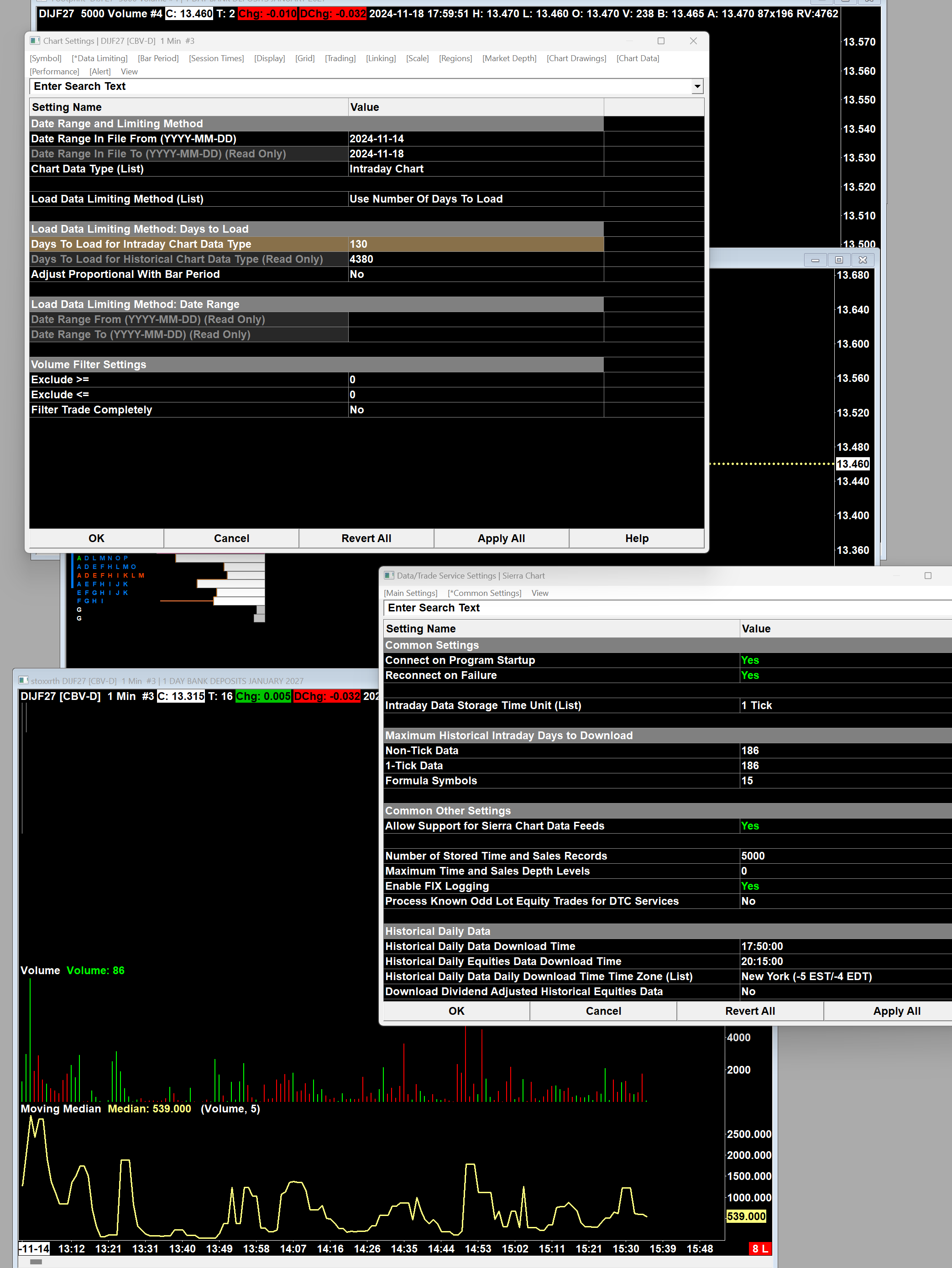

[2024-11-18 18:31:32]
and the data trade settings is set to a high number
image1tick.png / V - Attached On 2024-11-18 18:31:19 UTC - Size: 102.7 KB - 240 views
[2024-11-18 18:45:09]
it has to do with intra day vs daily. I took the daily chart and made it a 30 min and you can see same issue. I cannot scroll back(there is no scroller) and it stops on 14th. Please can anyone tell what is wrong here? thank you for you time.
imageintraday.png / V - Attached On 2024-11-18 18:45:05 UTC - Size: 131.07 KB - 244 views

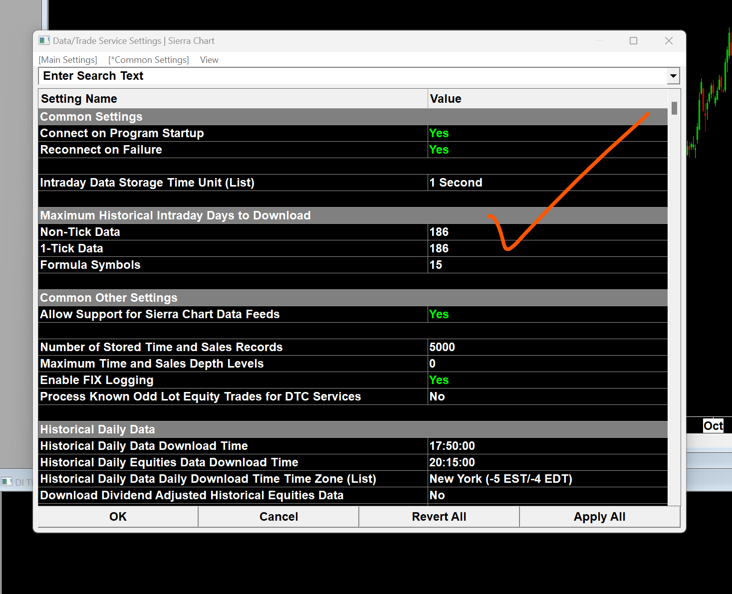

John, I have done all your instructions asked this morning(I actually did it all yesterday, but to make sure I didn't make an error I did it again). 1- the data limiting is set to 'use number of days to load' 2-days to load are 130 3-I then went to Global Trade service and I have non tick data set to 186 4- I also have set 'allow support for SC data feeds' to NO as per instruction I found on google (I tried it both NO and YES and neither work) 5-finally I did the green highlighted necessary step and I deleted and downloaded all data. As you can see from screenshot I hopefully have followed your instructions to the letter and still it is stuck at the 18th of Nov! This is a simple one-minute chart with nothing but 2 SC studies on volume. Again the daily historical data loads but NOT the intraday.
Please advise as I have done, I think, all you instructed. THANK YOU, Karen
imagejohn.png / V - Attached On 2024-11-19 10:21:19 UTC - Size: 281.23 KB - 200 views

[2024-11-19 14:54:37]
John, do you realise this firm only offers 186 days of tick data? So even with a full sub you only get a half year. Think of cme data-you get years and years...Just thought I'd let you know
Date Time Of Last Edit: 2024-11-19 14:55:12
[2024-11-19 17:15:52]
I did not personally know this, but others within Sierra Chart probably do. We are sorry you have not had the best experience with them.
