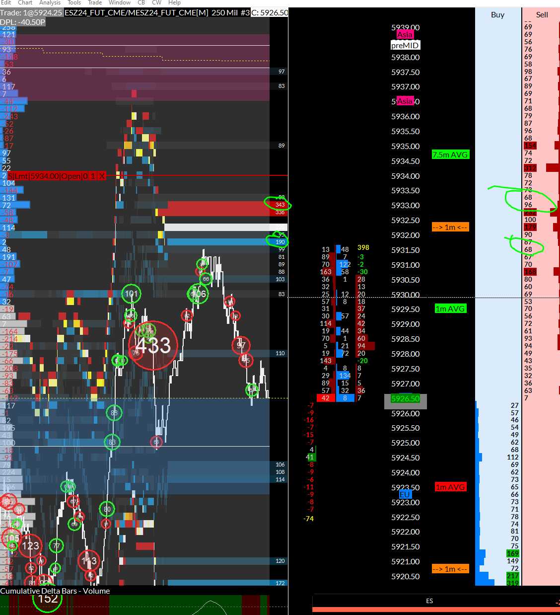

Hi, I had not had the depth turn off with newest pre release until today. Then it came back on its own but so many levels shown don't match the DOM. None seem correct actually.
imageCapture.PNG / V - Attached On 2024-11-21 14:43:02 UTC - Size: 156.58 KB - 222 views
[2024-11-21 15:46:08]
In the Market Depth Historical Graph, the Input for "Depth Data Type to Display After Last Bar" needs to be set to "Last Depth". Otherwise the data will not match up, as the Maximum Depth is the largest depth value seen at that level. Refer to the following:
Market Depth Historical Graph: Depth Quantity Type to Display After Last Bar
Even then, it can be hard to see the numbers as they change. You may want to select "File >> Disconnect" in order to actually be able to match up the data.
