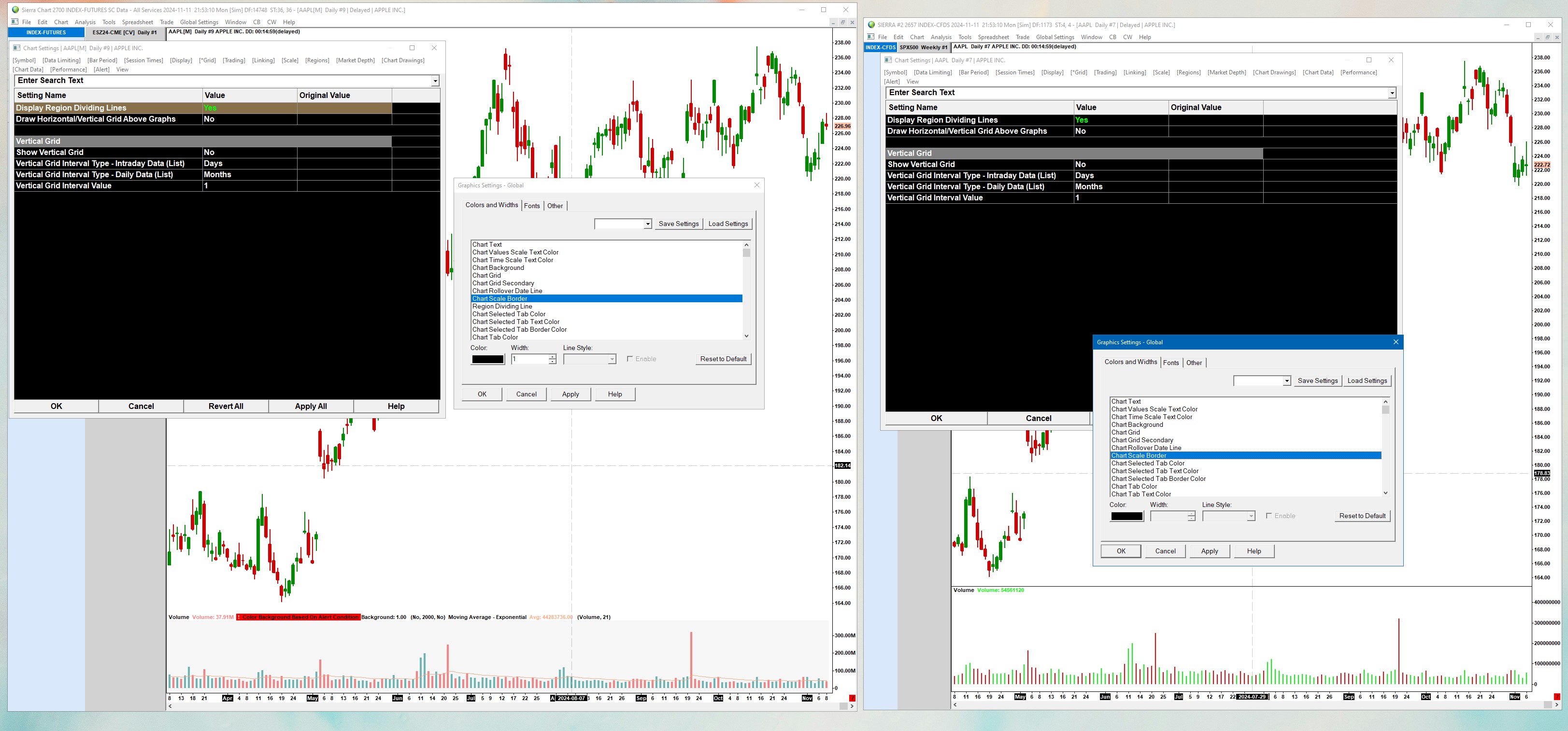

Hi, a very negligible issue / question -
I have just updated Sierra from 2657 to 2700. It seems like in this new version the region dividing line doesn't show.
I have two instances of Sierra and up until now I thought the Update function would update both instances. Luckily it didn't and second instance remained at an older version which allowed me to check the performance on older version.
I have "Display Region Dividing Line" = YES and also colour of the line not matching the chart background colour - see screenshot of both versions side-by-side.
The new version also has the frame line width adjustment (whereas the older Sierra doesn't) so I assume there has been some updates made to this function but for some reason the line now doesn't show at all in the new version. Any advice why could this be?
imageRegion line.jpg / V - Attached On 2024-11-11 22:29:24 UTC - Size: 689.68 KB - 238 views
[2024-11-12 15:17:33]
We are not seeing any issue with the Region Dividing Line in the current Pre-Release. Please update to the latest Pre-Release (v 2704) and make sure the "Region Dividing Line" in the Graphics Settings is set to the color you want it to be. In the image, you do not have the Region Dividing Line selected, so we do not know what color it is set to.

[2024-11-12 21:06:07]
WyckoffSleuth - Posts: 36
John
thank you for the support - it is now sorted. The problem was that I had the same colour for the region dividing line as the background.
Can it be that "Region Dividing Line" is a completely new setting in 2700 onwards in colour settings?
Please note that documentation says I should be using "Chart Scale Border" to set the colour (see the quote below from documentation) which I was following and wasn't aware of "Region Dividing Line". After your message I changed the colour and it now works fine. You may want to consider updating the documentation in the link.

[2024-11-13 16:28:48]
The "Region Dividing Line" is a new entry. We will have to update the documentation. Sorry for the confusion on that.
