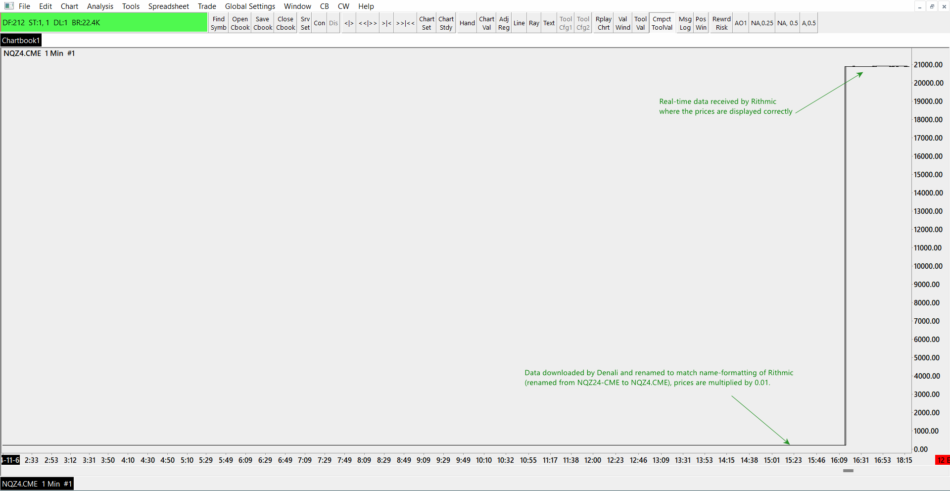

Hello Sierra Chart Support,
I’m experiencing an issue with multiplier settings after switching from Denali to Rithmic for real-time data. Here’s the background:
1. Previously, I used the Denali data feed, which stored my data files with the format NQZ24-CME.
2. Recently, I switched to the Rithmic data feed, where the same files are named NQZ4.CME. I renamed the data files downloaded with Denali to match the Rithmic naming format to avoid re-downloading all historical data.
3. I expected to see the historical data from Denali on the chart, supplemented by real-time data from Rithmic. However, I noticed that the historical data appears with a multiplier of 0.01.
To address this, I tried the following:
• I set the Historical Price Multiplier to 1 in the Chart Settings, which correctly displayed the historical data.
• However, this change unexpectedly also affected the real-time data, making it appear 100 times larger than expected. I did not adjust the Real-Time Price Multiplier in Chart or Symbol Settings(default value is 0.01), but it seems linked to the historical multiplier setting.
I’m seeking a way to have the Historical Price Multiplier set to 1 (for Denali historical data) and leave the Real-Time Price Multiplier as default, i.e. 0.01(for Rithmic real-time data) without them affecting each other. Currently, adjusting the historical multiplier seems to automatically impact real-time data on the same chart.
Could you please advise on how to configure these multipliers independently for each data source, or if there’s an alternative method to ensure historical and real-time data display correctly? If this requires a specific configuration or workaround, I’d appreciate any guidance.
Thank you for your assistance!

In the end, you can not do what you did in Step #2. Each service uses different raw data, which is why you are having the problem you are.
You need to delete the data and redownload it. Since you are getting your data from our Denali Exchange Data Feed, you will get the same data again, just stored properly for Rithmic. For each symbol, go to a chart and select "Edit >> Delete All Data and Download". You only need to do this one for each symbol and not for every chart.
[2024-11-11 17:43:31]
Yes you cannot rename data files like this. It will not work.
And you keep the multiplier settings as default.
Fully re-download the data:
Re-download all the data in the chart by going to the chart and selecting "Edit >> Delete All Data and Download" from the main Sierra Chart menu. You just need to do this once per symbol and not for each chart. This command is on the main Sierra Chart menu at the top. Only use it from that location.
