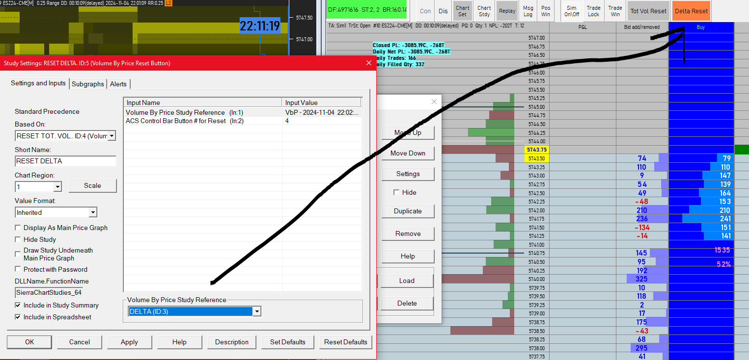

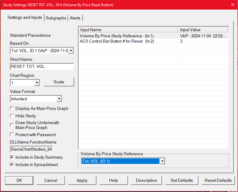

VDB Tot. Vol. = ID 1
Custom Study Button 3 = VDB Tot. Vol.
Delta Vol. = ID 3
Custom Study Button 4 = Delta Vol

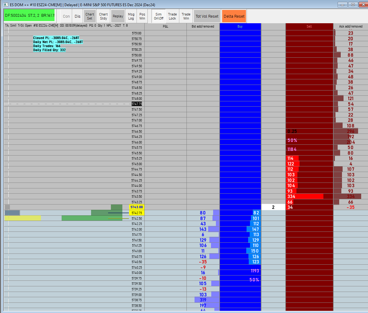

I don't know why, but only the first time I press one of the reset button it properly works. Then, when one of 2 VbP is resetted, if I press one of the buttons both VbP reset. And so on. I just want each button work properly everytime I press it.
So, when I manually reset the start time and both VbP are counted from 00:00:00, again, only the first time I press one of the button they properly work. I can send a video to explain everything.
