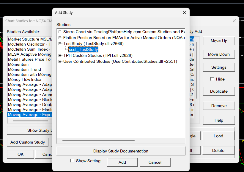

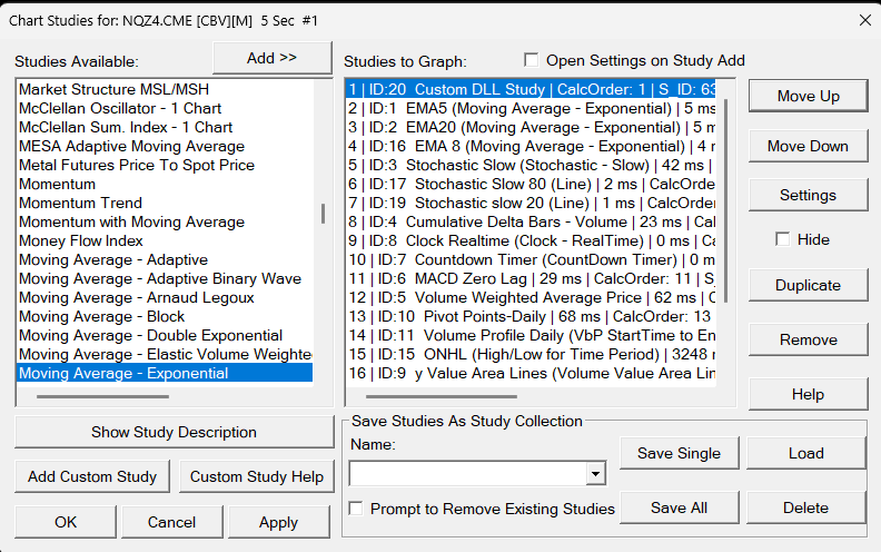

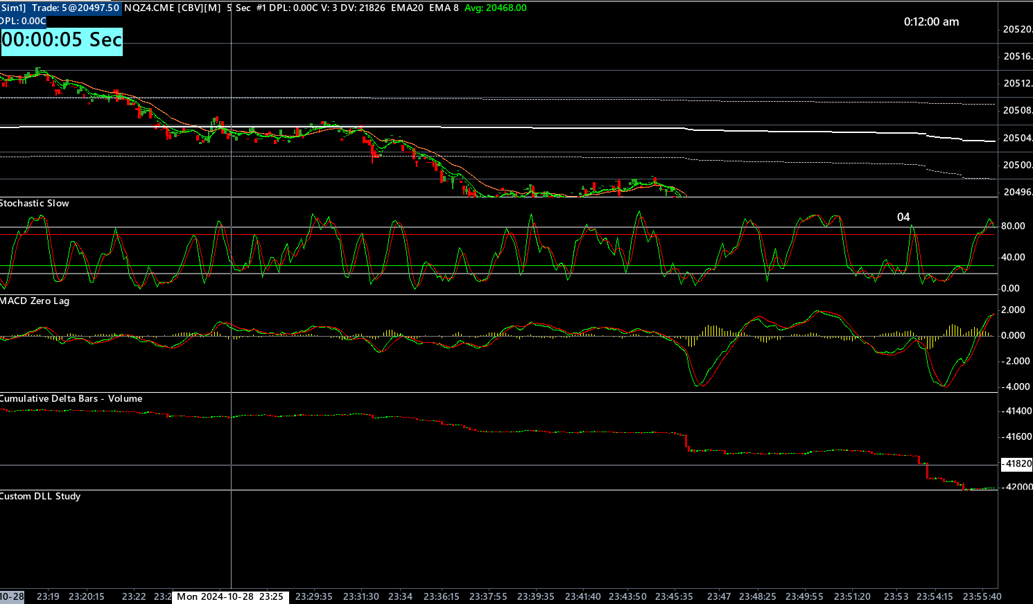

After compilation of custom study cpp file, the study added to the list of studies always shows as "Custom DLL Study | CalcOrder". Even though SCDLLName and function name are completely different and modified multiple times, the name of study in the list remains same. Screenshots are attached.
Full description of problem: Everything has been working fine for couple of days as I was developing custom study. I was able to test and make changes numerous times and was almost done with the study. However, today a peculiar problem started. Once I compiled and added study to chart it showed up as name "Custom DLL Study | CalcOrder". Even though I do not have that name in my file. So, to eliminate any other problems, I created a small sample study with just couple of lines of code. It gives the same result. I also installed local cpp compiler and tried using that. Same results. I do not know what to do. Additionally, the study I was developing stopped showing inputs when the study was loaded on chart. So, something is definitely wrong.
Please advise.
(In image attached AddedStudy.png, the added study is #1)

ondafringe - Posts: 343
It's been a long time, but my ancient memory seems to recall whenever I saw the scsf_ prefix in the study list like you are showing, it indicated a corrupt DLL (or something was wrong with the DLL).
Just to check, you might try closing SC (or Releasing that particular DLL)... then go to the SC Data folder and delete that particular DLL... then restart SC (or Allow Load DLLs)... then rebuild the DLL and see if that helps.
Date Time Of Last Edit: 2024-10-29 21:14:10
[2024-10-29 22:19:50]
User321619 - Posts: 26
So many thanks ondafringe. Those sequence of steps followed exactly fixed the problem. I tried all of those before except deleting the dll. So, I believe that is what really fixed the problem, along with other steps.
Ah, I see. So, I installed C++ components in Visual Studio which was already on my system. By installing that, it automatically populates the drop down in Analysis -> Build Custom Studies dialog box. The field "Visual C++ Path" drop down has this populated automatically to path of VC++ compiler. So, all I have to do is select menu Build -> Build with Visual C++. And it automatically places new dll in SierraChart\Data folder. You probably know all this but wanted to mention. So, still believe old dll was stuck and that is why I kept getting error.
