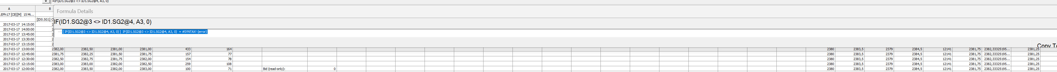

[2024-10-29 20:44:21]
TraderBake - Posts: 63
I entered it in k3 of "Spreadsheet Study".
You mean "Spreadsheet System for Trading"?
imageSierra Chart.jpg / V - Attached On 2024-10-29 20:19:24 UTC - Size: 173.43 KB - 200 views
[2024-10-29 23:36:09]
You do not need the "Spreadsheet System for Trading" for this. The "Spreadsheet Study" is fine. Unless you want to use the Spreadsheet System for Trading for some reason, that is also OK, but you do not want to use cell K3 in that case, as that is the Buy Entry column.
There is no reason for you to be getting the #SYNTAX error that is showing. This is very odd. Do you have the "Daily OHLC" study on the chart? If so, what is the ID of that study? That study should be showing in Column AA (or right by there, depending on how you have a few different things setup for your Spreadsheet Study). Is the data for that study showing there?

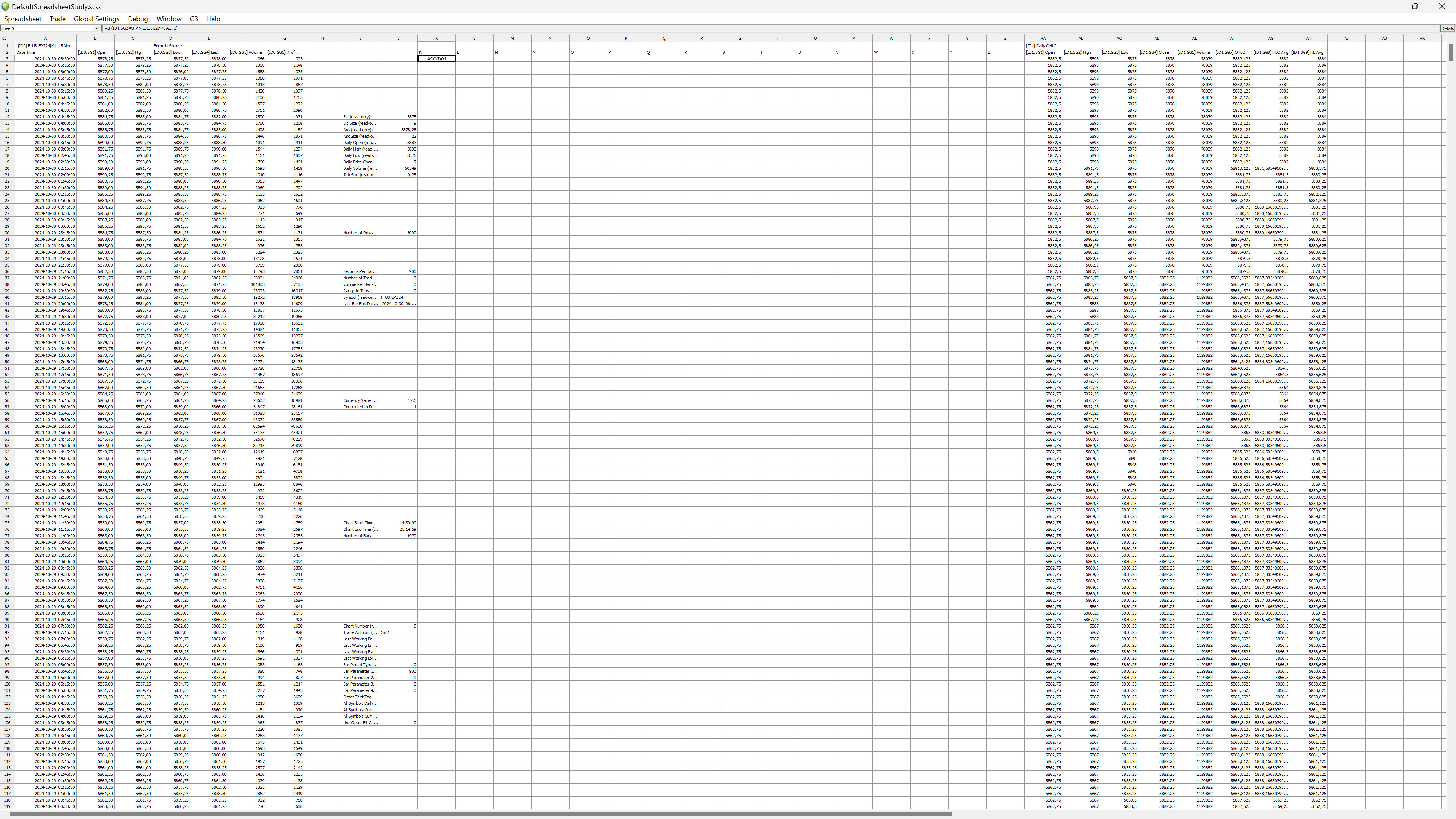

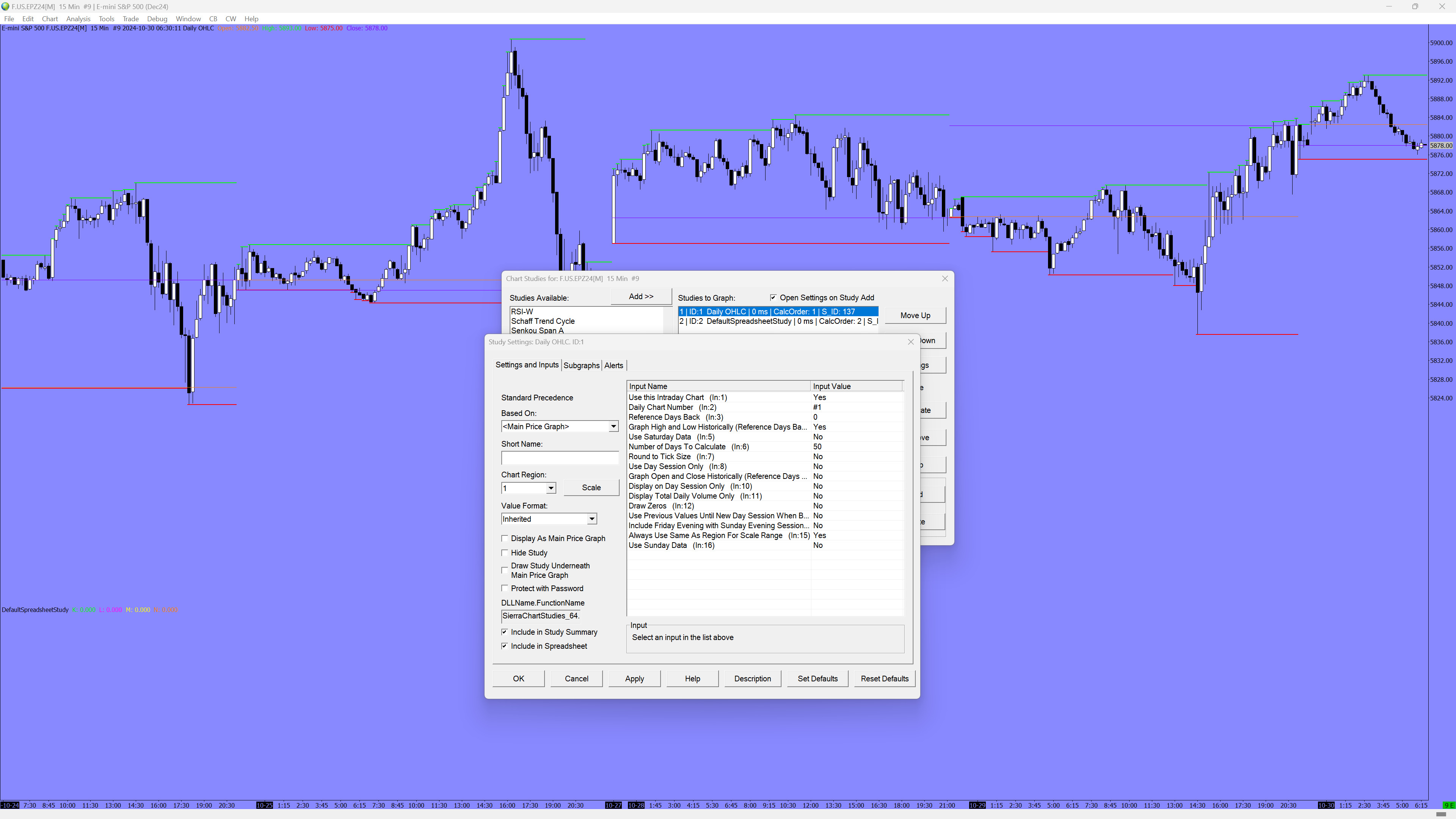

[2024-10-30 05:35:31]
You can see both the chart with daily OHLC and the spreadsheet in the attached files now.
Maybe you can now see what I did wrong?
imageSierra Chart Daily OHLC.jpg / V - Attached On 2024-10-30 05:33:08 UTC - Size: 908.32 KB - 240 views
imageSierra Chart Spreadsheet.jpg / V - Attached On 2024-10-30 05:33:23 UTC - Size: 2.63 MB - 253 views

[2024-10-30 15:40:08]
The Formula Sheet being different is definitely a problem.
Is that Spreadsheet being used for any other purpose? If not, then we recommend removing the Spreadsheet Study from the chart and then deleting that spreadsheet file by selecting "File >> Open Spreadsheet", finding the name of that spreadsheet in the list that comes up and selecting it, then select the "Delete Files" button to remove it.
Then add the Spreadsheet Study back on that chart and you should be fine. But, make sure the Input for "Formula Source Sheet Number" is the same as the Chart Number. You can also force this by setting the Input for "Always Set Formula Source Sheet To Chart Data Output Sheet" to "Yes".
