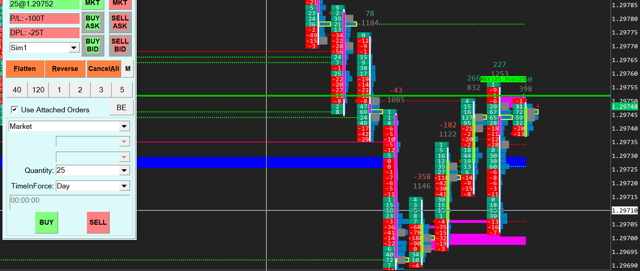

[2024-10-25 17:49:01]
awakef - Posts: 72
Hi again,
I'm using the replay on Forex data and went I do a market order always shows a difference of 0.00005 between the real price I enter.
I thought the problem was the currency value per tik of 0.00005 on chart settings I changed to 0, also on the global symbol settings I changed it to 0 and still the market position line still shows that difference after adjustments.
There's something I missing out to fix that?
I doing market replay with 5 charts only 1 I made the adjustment since is the one I'm using to enter the market orders.
Thanks,

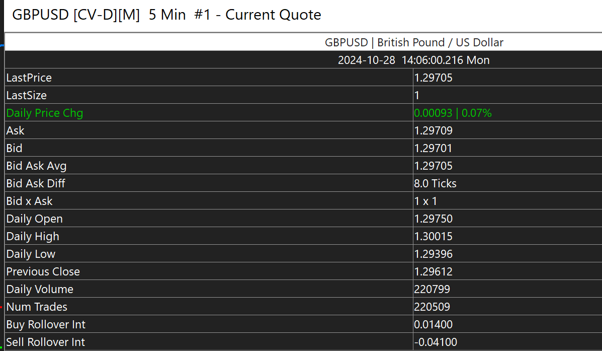

awakef - Posts: 72
Hi John,
Thanks for the info I fixed.
But on live data is still is 0.00005 difference.
On the current quote screenshot I uploaded the bid/ask difference is 8ticks but on sierra is 5ticks.
I want the trade position lines market orders to be on the last price so there's no difference.
How I can do it?
Thanks.
imageScreenshot 2024-10-28 142959.png / V - Attached On 2024-10-28 18:30:09 UTC - Size: 49.39 KB - 237 views
[2024-10-28 20:24:57]
We are not sure what you are trying to show.
Keep in mind that any order is going to be filled at either the Bid or Ask (depending on whether is is a Sell or Buy order respectively). This is true in our simulation environment as well as with most exchanges.

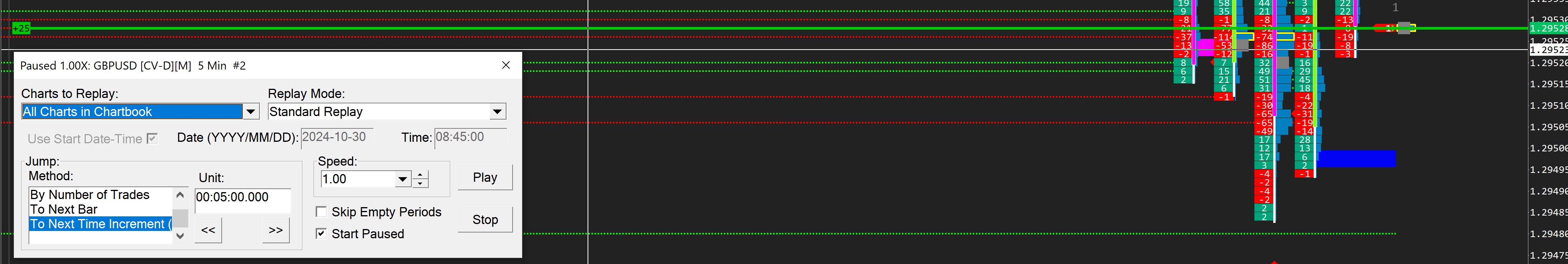

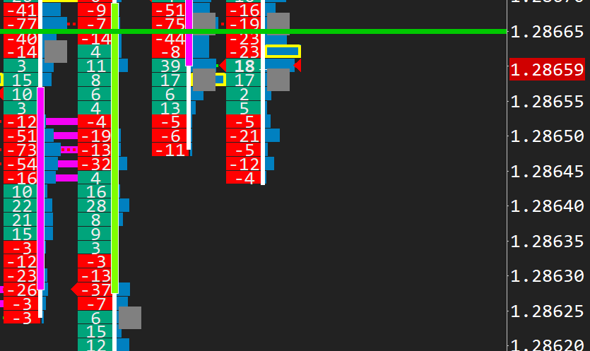

awakef - Posts: 72
Here I uploaded a screenshot on market replay with the trade position line fixed with this setting that the trade position is created on the last price.
Then another screenshot real live market with the same settings but the trade position line is created with a difference of 5 ticks.
How I can make the trade position line be created on the last price in real live market data?
Btw I have trade simulation mode on.
Thanks John like always,
Date Time Of Last Edit: 2024-10-30 19:50:23
imagereplay.png / V - Attached On 2024-10-30 19:48:38 UTC - Size: 121.68 KB - 203 views
imagesettings.png / V - Attached On 2024-10-30 19:48:50 UTC - Size: 5.41 KB - 232 views
imagemarketlive.png / V - Attached On 2024-10-30 19:50:19 UTC - Size: 178.4 KB - 236 views
[2024-10-30 21:43:16]

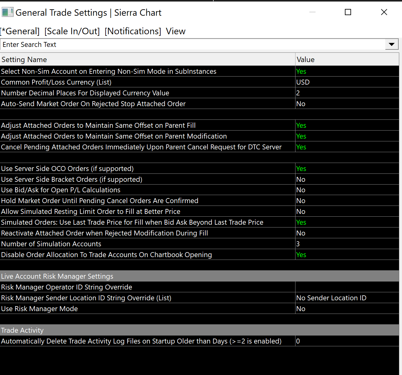

awakef - Posts: 72
Hi John,
I downloaded the latest release and still on live market the trade position is created with a difference of 5 ticks.
I uploaded screenshots of the settings and also of the trade.
imagesettings1.png / V - Attached On 2024-10-31 17:28:25 UTC - Size: 106.68 KB - 233 views
imagesettings2.png / V - Attached On 2024-10-31 17:28:28 UTC - Size: 81.86 KB - 193 views
imagetradeline.png / V - Attached On 2024-10-31 17:28:42 UTC - Size: 40.01 KB - 226 views
[2024-10-31 18:09:12]
What you are seeing makes perfect sense. We do not see any issue.
GBPUSD generally has a spread of 0.0001. So when the Best Ask is at 1.28651 the Best Bid is at 1.28641 and the Market Price is at 1.28646 (in between the two).
When you place a Buy order, it will get filled at the Best Ask price, which is approximately 0.00005 points away from the Market Price.
[2024-10-31 18:10:39]
There is a study called "Bid and Ask Prices" that will show you where the Best Bid and the Best Ask are currently as well as historically. You will see that you are getting filled at either the Best Ask or the Best Bid depending on whether you are Long or Short (respectively).

imageScreenshot 2024-11-12 140133.png / V - Attached On 2024-11-13 03:02:28 UTC - Size: 105.68 KB - 233 views
[2024-11-13 16:57:14]
For live trading or Simulated trading in real-time (i.e. not during a replay) you can not change this. This is how orders are placed with exchanges. Your order is put at the Bid or Ask, it is never actually put at the Last price.
