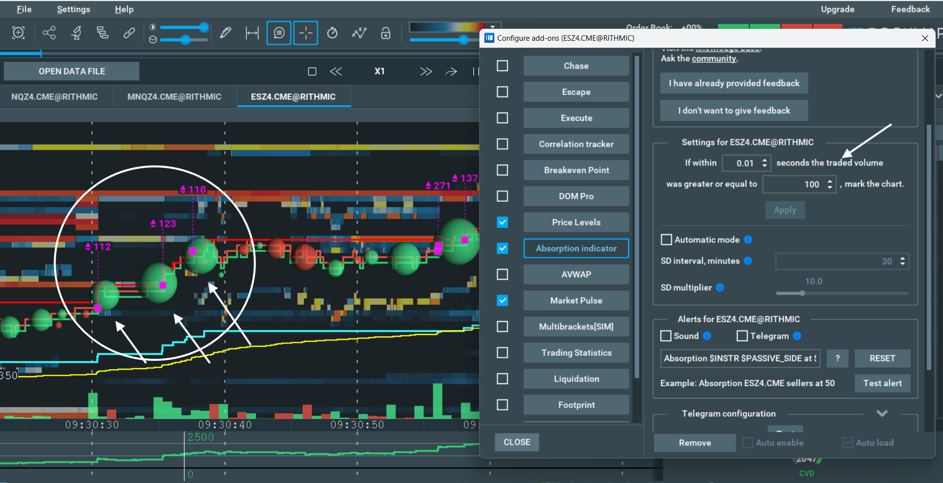

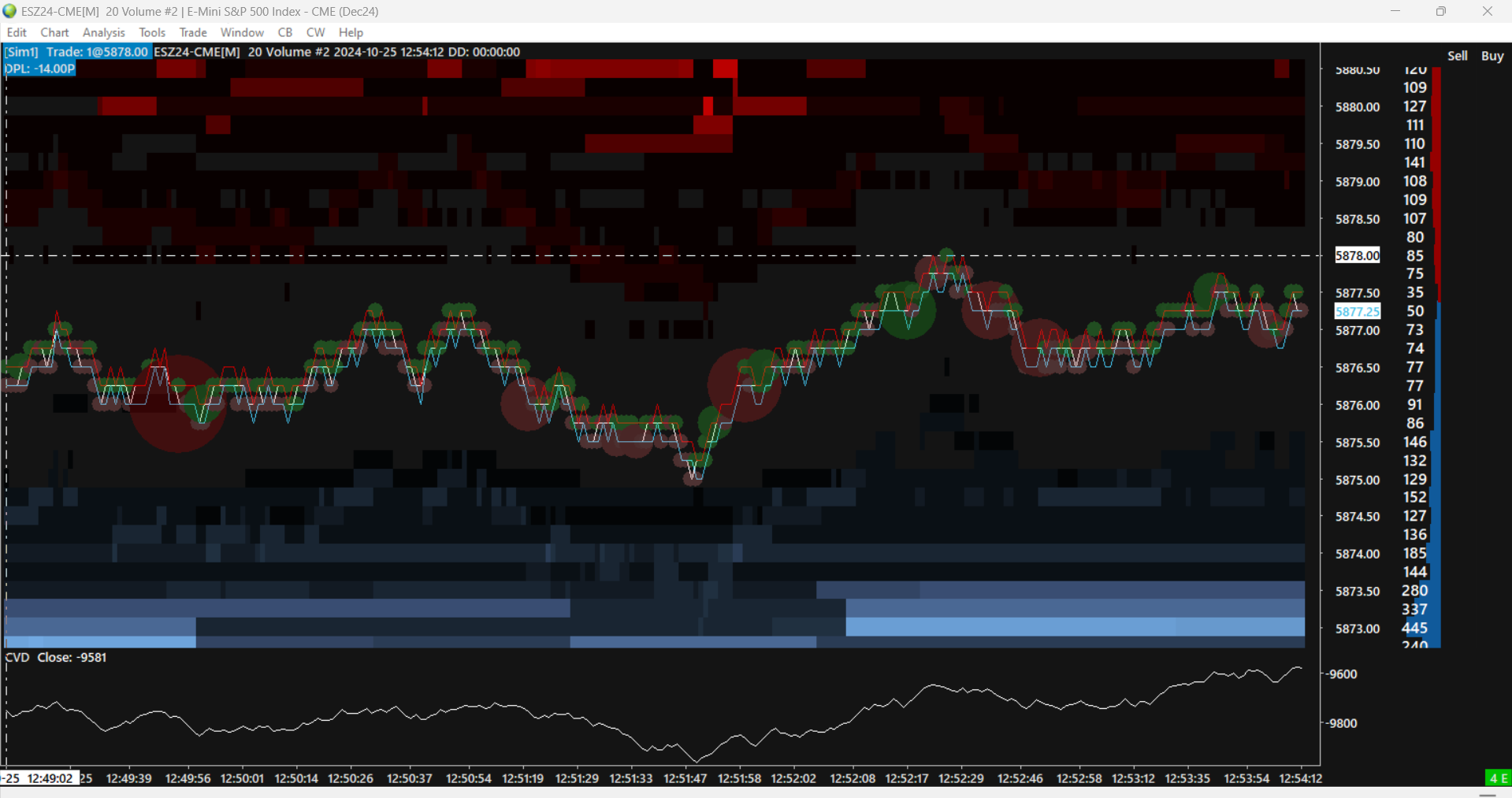

Hello, I am trying to add the absorption alert when sellers or buyers are being absorbed. I am setting the volume number to maybe 100 and setting an alert to it as well with text in the absorption area of total traded volume. Please check the attachment of the Heatmap. Also on the far right of the chart I used chart DOM and there is a buy-sell column I like to remove those buy can't do it in the chart DOM columns settings.
We do not know what the question is here.
In the list of columns, there will always be one of either the "Buy Order" or "Bid Size/Buy" column (and the same for the Ask side). To not have these showing in the DOM, you need to set the column to be the "Buy Order" (and Ask Order) and then turn off the option for "Trade >> Trading Chart DOM On" and then turn on the option for "Trade >> Show Market Data Columns". Refer to the following:

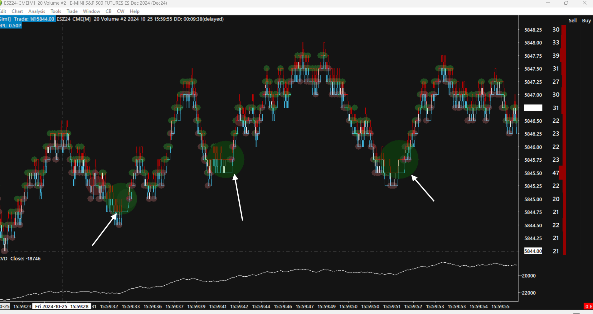

Thanks John, for the first question I am looking for a way to show on the chart that at any given time there's a large number of volume is being traded. Please check the screenshots for a better understanding, if you see in bookmap screenshot highlighted by the arrows shows there were more than 100 contracts traded at with in 0.01 seconds. Now If you look at a Sierra Chart Heatmap where there is a large green bubble's means the volume traded there is more and I would like to add the text on that for how much volume is traded if greater than 100 or 200.

We assume you are using the "Large Volume Trade Indicator" to get the bubbles. In which case you need to enable the "Draw Volume Text" Input for how you want to view the numbers. There are also other Inputs that affect the text. Refer to the information at the following link:
Large Volume Trade Indicator: Inputs
