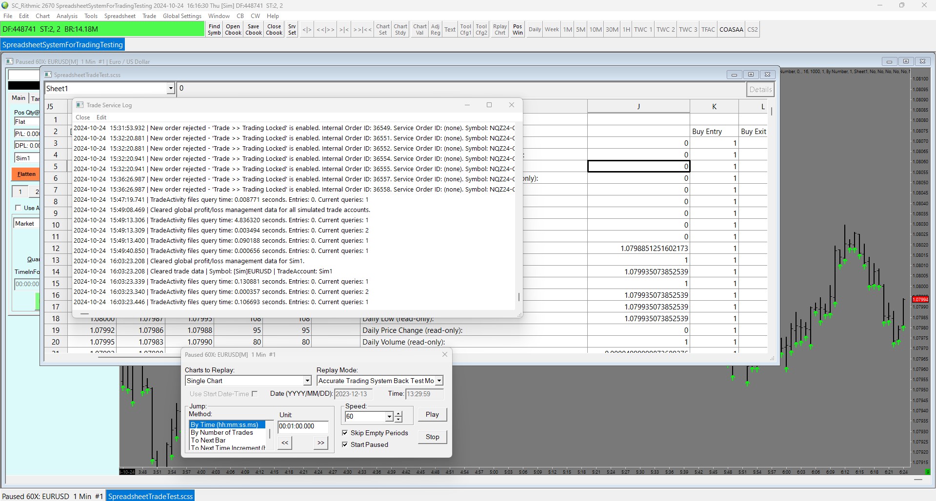

Hello! I have been trying to backtest my strat, but it would not work. So I decided to go through these steps here Spreadsheet System for Trading Test Procedure: Testing
But this did not work either. Here is what I have after inputting 1 for K3 cell - see the pic. The Trade service is SC All services.
imagefailed backtest.jpg / V - Attached On 2024-10-24 20:17:16 UTC - Size: 468.18 KB - 193 views
[2024-10-24 22:09:36]
You have the option for "Trading >> Trading Locked" enabled. This locks you from being able to do any trading. Select the option to remove the checkmark next to it and you will then be able to make trades (including backtesting).

Yuri_T - Posts: 21
OMG, this is so embarrassing... Sorry for taking your time and thank you!
