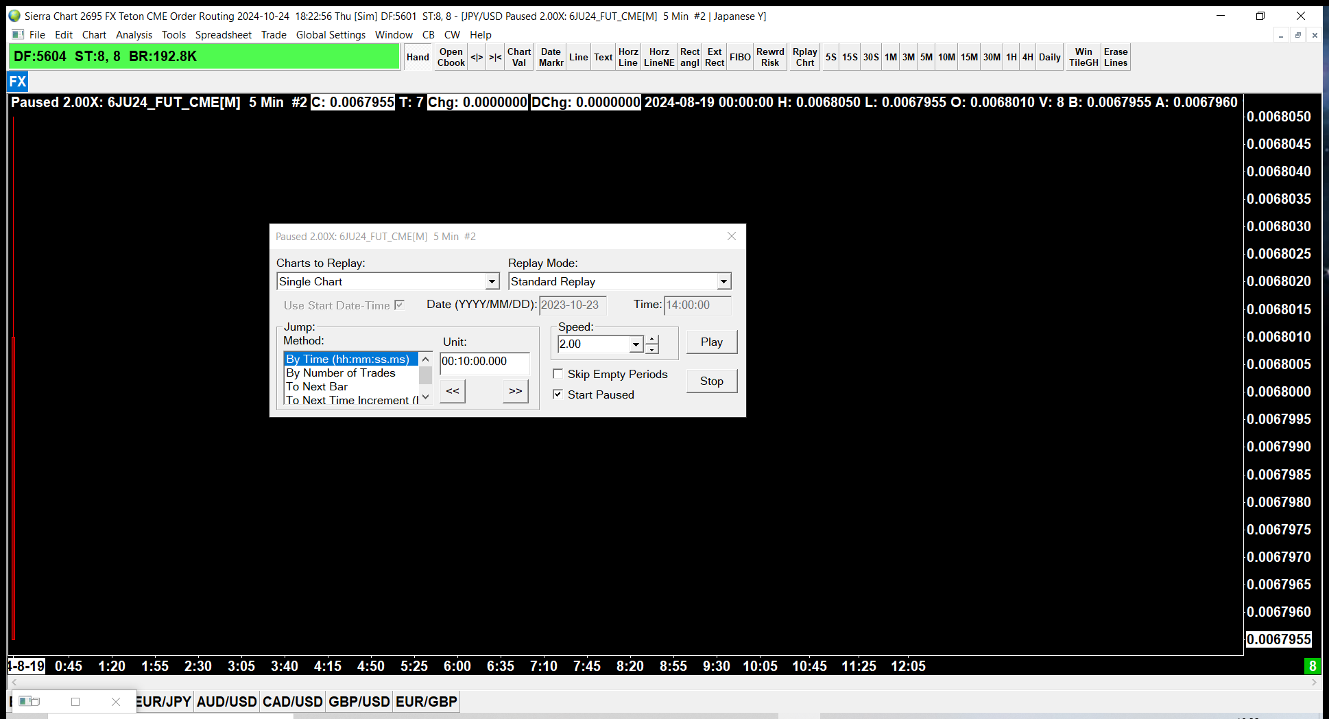

I have a problem when using the replay chart feature. It does start the replay, but all the left side of the chart is erased so you can see how the chart have developed from that moment.
Is there a way to make Sierra load the previous events too?
https://www.sierrachart.com/image.php?Image=1729786976753.png
Screenshot was taken on 24/10 to it is not a days to load option issue.

This absolutely is a "Days to Load" issue. You are trying to start the replay based on a set date and time, which is set to 2023-10-23 at 14:00:00, but you do not have data loaded that far back. The earliest date in your chart is 2024-08-19.
You need to have the data loaded going back as far as you are wanting to start the replay.
