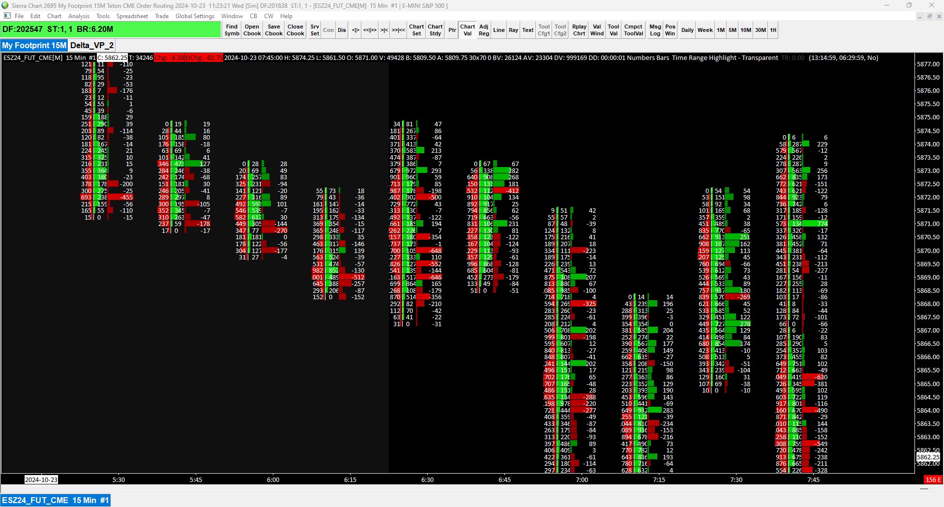

I want to add a threshold for my delta to be 300. I do not want to see any numbers unless it 300+. Is there anyway to do that? You guys only have an option to threshold askxbid not askxbid difference.
imageScreenshot 2024-10-23 112322.jpg / V - Attached On 2024-10-23 18:23:48 UTC - Size: 440.02 KB - 248 views

The only way to do this would be to set the following for the column with the delta displayed:
- Text Coloring Method: either "Based on AskVol BidVol Difference - Actual" or "Based on Diagonal Dominant AskVol BidVol Difference - Actual" depending on whether you are doing diagonal comparisons or not.
- Column n Range 3 Up Color: The color you want the +300 deltas to show as
- Column n Range 0 - 2 Up Color: Same as the background
- Column n Range 0 - 2 Down Color: Same as the background
- Column n Range 3 Down Color: The color you want the -300 deltas to show as
- Column n Actual Value Thresholds: 0, 0, 300
Note that you could also use the "Range n Up/Down Color for Text" options if you are using a specific background for that column.
