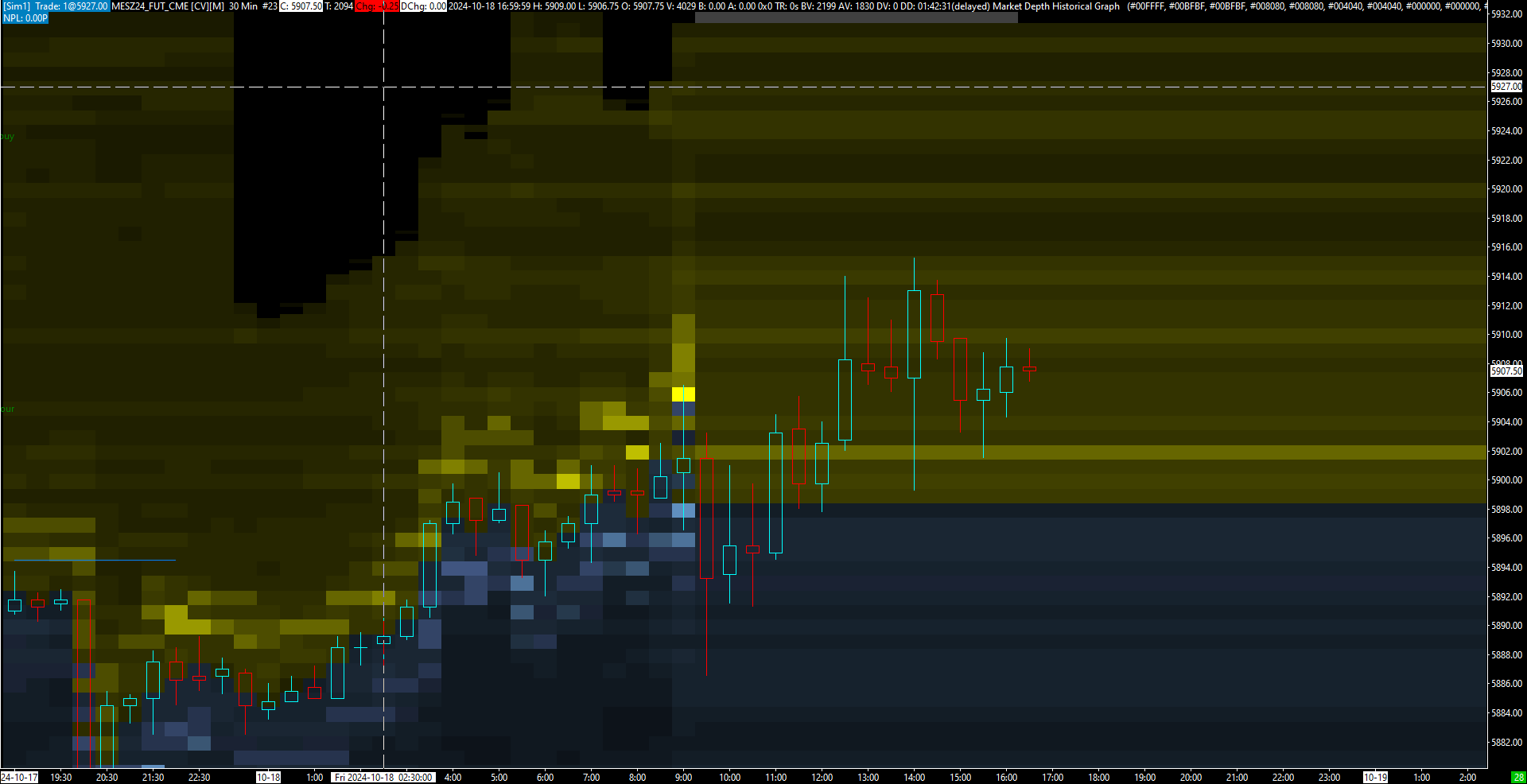

Had a feeling that was going to be the response, thats really not a big issue for me right now but this other market depth issue is more bothersome. I now have market depth set up on a 30 minute candlestick chart. I have it set to show the previous 10 days of data. Today I went to take a look at fridays (most previous trading day, 10/18) market depth data and I notice that it does not appear anything like the previous 9 days of data. Its like fridays data has not been processed yet? Im looking to be able to view market data, processed for each 30 minutes( or each bar) right as it happens, do i really have to wait untill next trading day for this to process in order to view this market data?

[2024-10-21 14:03:31]
The Market Depth Historical Graph is going to show the information as it comes in.
We can not say exactly why you are missing the data for that day - the most likely reason is that you did not have Sierra Chart running at that time, so the Market Depth was not recorded and therefore there is nothing to display at that time.
To force a download of historical market depth data, refer to the instructions at the following link, specifically step #8 after you have setup the other items:
Market Depth Historical Graph: Downloading Of Historical Market Depth Data
Also, keep in mind that the Market Depth data is not recorded unless you specifically setup the symbol to do so, or if you have the Market Depth Historical Graph displayed on your chart. Refer to steps 1-8 at the following link:
Market Depth Historical Graph: Step by Step Instructions
