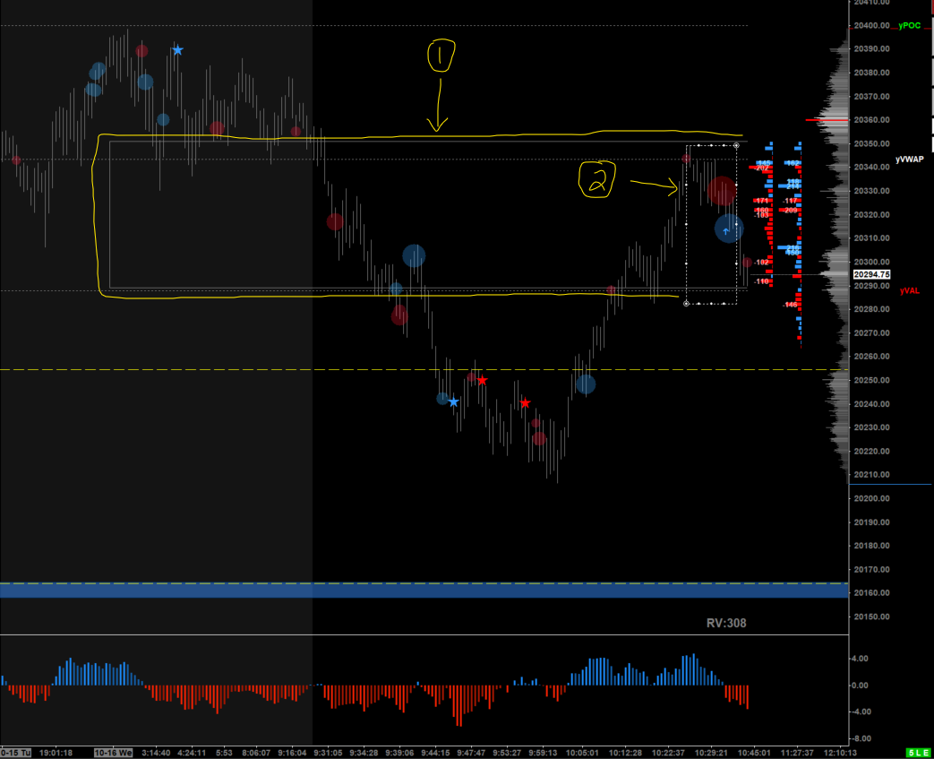

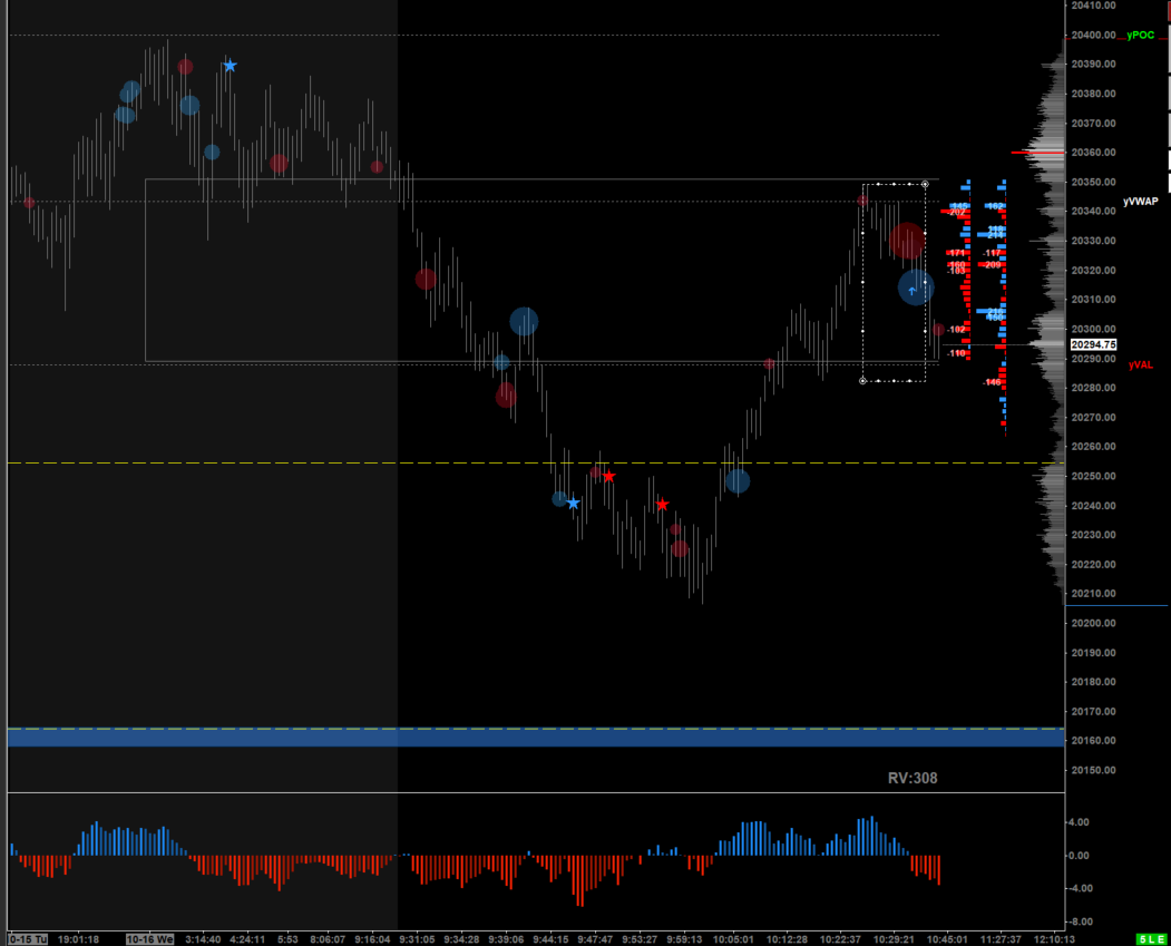

I just started using the draw volume profile tool to draw leg-to-leg delta profiles. How do I align the 3 side outline with the bars actually being calculated? As you can see in the attached photo, the gray outline goes all the way back to the day's start when it should line up with the white dotted line. I've gone through all the "Volume Graph Period Type" options, but none appear to be aligning.

We are not understanding the image. In particular, there is a box toward the right side that has dashed lines (or dotted) and dots in it. That is a typical box you would see when you have a Drawn Volume Profile selected. We are not sure what the other box you are referring to is.

See updated image with markups.
1.) When "Draw Profile Outline Enclosing Bars" is set to "3 Sides", this is the gray box that gets drawn (highlighted in yellow).
2.) This is the box when selecting the drawn profile.
I would have expected box 1 to match box 2, however the Outline appears to be starting at the beginning of the day (time 0:00) instead of where I have it drawn at (~10:29).
