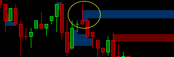

I'm using the Volume At Price Threshold Alert V2 study to show imbalances in Ask Volume/Bid Volume. The output is a blue (buy imbalance) or red (sell imbalance) extension line at the price level of the imbalance.
What I'm looking to do is highlight bars where there is divergence, i.e. a down bar that has a buy imbalance or an up bar that has a sell imbalance.
I've tried using the Color Bar Based On Alert Condition study to facilitate this using this alert condition: =AND(ID1.SG1 > 0, C > O) however the bar coloring isn't correct.
Any ideas that could help?
Thanks in advance
imageScreenshot 2024-10-12 at 17.03.42.png / V - Attached On 2024-10-12 16:22:48 UTC - Size: 4.51 KB - 378 views

Yes more specific. So for the alert condition to color the bar when either:
There's an up bar with a sell imbalance.
There's a down bar with a buy imbalance.

Ok let me explain more clearly.
I'm using 2 instances of the "Volume at Price Threshold Alert V2" study. It's set up to compare 'Ask Volume/Bid Volume Diagonal Ratio', one instance with a +300% Percentage Threshold, the other with -300% Percentage Threshold.
The subgraph 'Extension Line Properties' colours are set to blue for the +300% Percentage Threshold instance and red for the -300% Percentage Threshold instance.
What I'd like to do is color fill candles where it's an up candle and the "Volume at Price Threshold Alert V2" study has a -300% Percentage Threshold showing via the red extension line. Then also color fill candles where it's a down candle and the "Volume at Price Threshold Alert V2" study has a +300% Percentage Threshold showing via the blue extension line.
So just using the Color Bar Based On Alert Condition study for these 2 states.

User993440 - Posts: 26
Yes its targeting stacked imbalances. So I only want to highlight candles where there has been a buy imbalance on a down candle or a sell imbalance on an up candle. These imbalances can be at any price within the range of the candle.
I think its SG60 on Volume at Price Threshold Alert V2 as this is the extension line.
So I only want to highlight candles where there has been a buy imbalance shown via SG60 on a down candle or a sell imbalance on an up candle shown via SG60. These imbalances can be at any price within the range of the candle and can be single or multiple.
Currently using either:
=AND(ID1.SG1 > 0, C > O) or =AND(ID1.SG60 > 0, C > O) doesn't give the intended output of a coloured candle for the above conditions
Ok thanks I've attached the chart, examples of the condition I'd like to highlight are the candles at these times:
15th Oct 20:50:13 UK Time
15th Oct 20:55:05 UK Time
