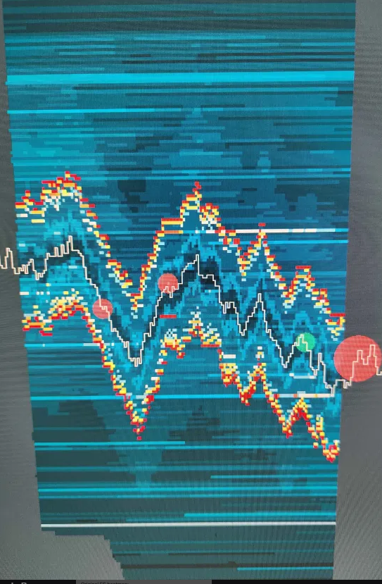

[2024-10-30 01:26:08]
User168203 - Posts: 3
I think the "auto straddle" referred to is the market maker noise/algo that is above and below the price line. I would love to know how Bookmap figured it too!

[2024-10-30 10:05:51]
Cesium - Posts: 179
Its not from market makers, despite what erroneous garbage bookmap claims in an effort to peddle and sell overpriced, buggy, and slow java code, it is not from "Market Makers"
You have bright red and yellow colors on your Market Depth Study. Sierrachart provides the ability, completely built-in, to change the colors of Market Depth Historical Graph. This function works as intended.

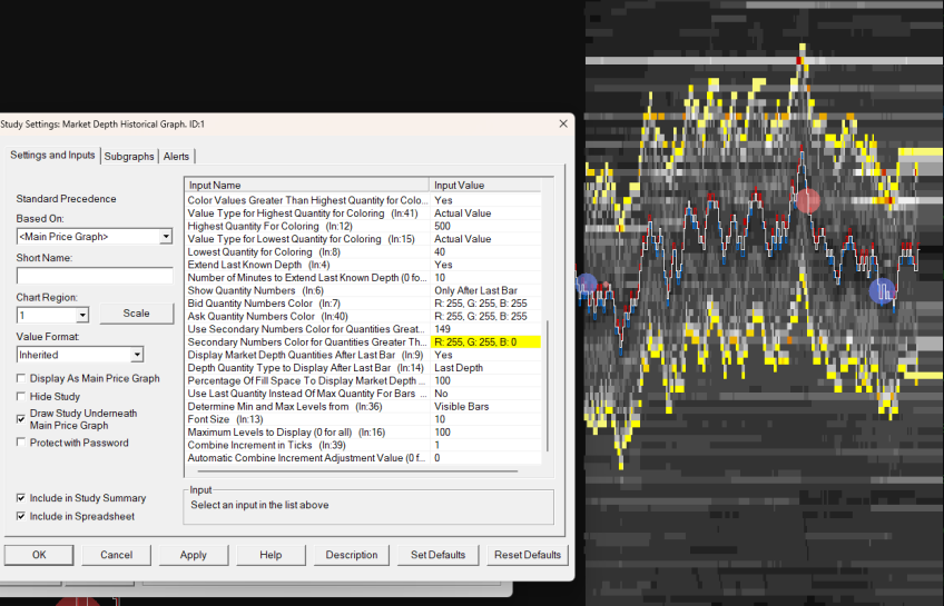

[2024-10-30 15:48:10]
We see you have the Input for "Highest Quantity for Coloring" set to "500", but you also have the Input for "Color Values Greater than the 'Highest Quantity for Coloring'" set to "Yes". If you do not want to see those blocks colored, then you would want to see the latter Input to "No".

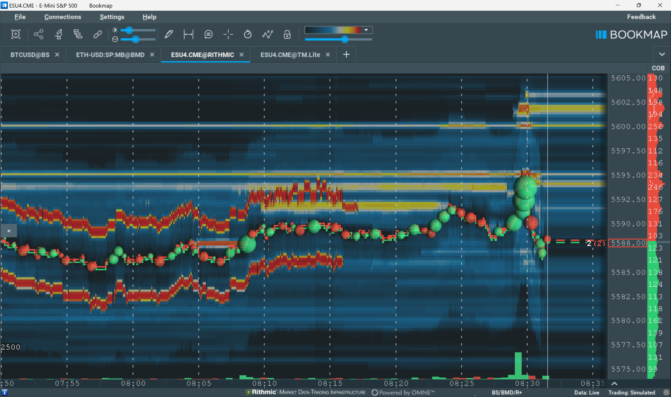

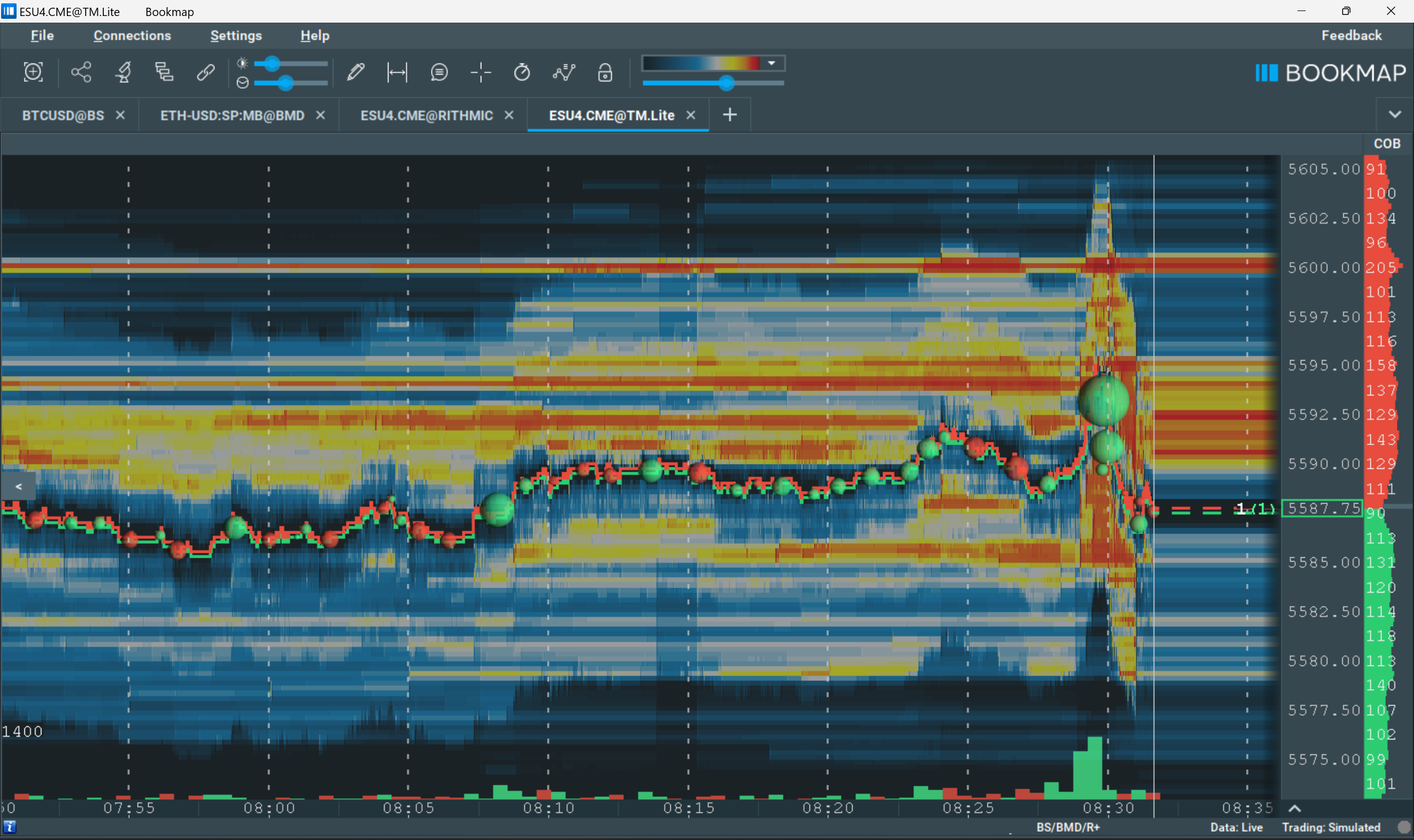

[2026-08-26 15:41:09]
cmet - Posts: 747
Older post, but the original request would be valuable.
Their filter is probably using MBO to detect/classify those offset liquidity bands, since they track price but rarely/never execute. They would have to determine how much of that is algo noise, then filter it out from the heatmap.
Could probably do a "less precise" filter with the aggregated data. 3 levels with fixed/persistent offset to BBO on both sides, estimate total liquidity that's noise, etc and filter out.
Definitely reveals more detail as far as resting liquidity goes.
