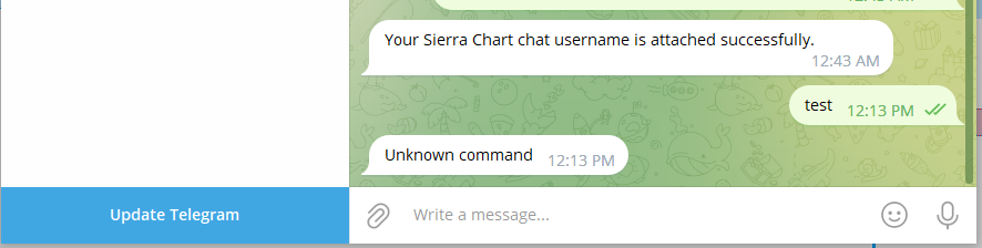

I am trying to setup telegram alerts. I have setup Sierra Chart Chat and alerts are going into chat, also have set up SierraChart Bot with the attached code and it says Sierra Chart chat username is attached successfully, but alerts are not going thru from Char Chat to the telegram?

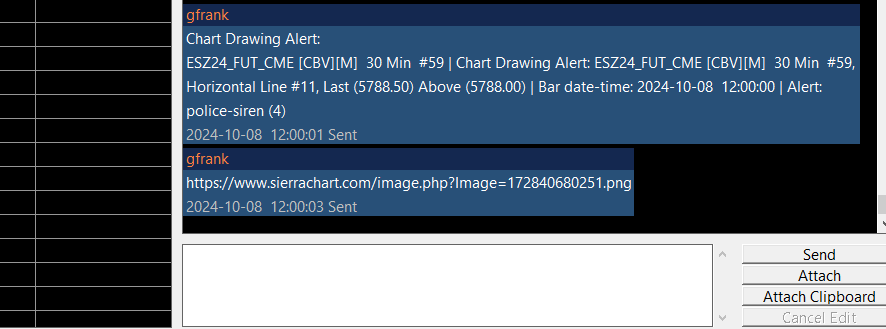

Alerts are going into my Sierra Chart chat window, but not getting them in my telegram messenger on the SierraChartTelegramChat.
Date Time Of Last Edit: 2024-10-08 17:18:59

[2024-10-08 20:21:35]
In the Chat window select the Group that you setup for the alerts to forward to Telegram and then select "Commands >> Edit Chat". On the window that opens make sure the option for "Relay to Telegram" it set to "Yes".

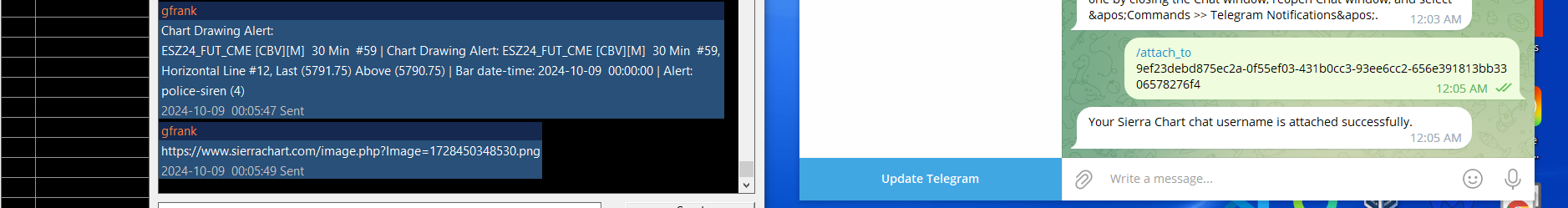

Did that, still not getting alerts over telegramchat.
image10-9-24.PNG / V - Attached On 2024-10-09 05:12:00 UTC - Size: 81.37 KB - 242 views

Make sure you have enabled, the necessary Telegram options for the chat:
Chat and Communications Platform: Telegram Integration
Here are the complete instructions.:
Chat and Communications Platform: Using Chat for Remote Alert Notifications
Be sure to go through them to see if you have missed anything.
[2024-10-09 16:17:41]
User841161 - Posts: 357
Yes, I did find something I missed, not it seems to be working, excellent. Thank you for the support.
