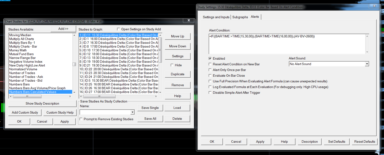

I'm working on a script to color my 30-minute candles based on specific AV-BV criteria, but I'm encountering some issues.
Here's what I'm trying to achieve:
Between 3:30 PM and 4:00 PM: color the candle if AV-BV > 2600
Between 4:00 PM and 4:30 PM: color the candle if AV-BV > 2000
Between 4:30 PM and 5:00 PM: color the candle if AV-BV > 1500
And so on.
The problem is that when I apply my formula, it also colors candles outside the defined time ranges, which is not what I want.

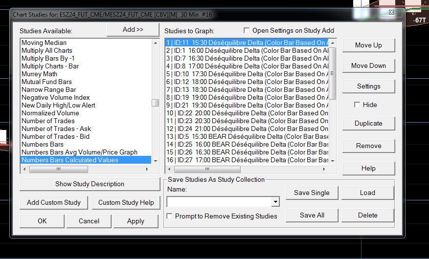

Additionally, I've created a separate study for each different time interval, but I'm not sure if that's the right approach (see screenshot).
Here’s the code I’m using: (LOOK SCREENSHOT)
=IF((BARTIME >TIME(15,30,00)),(BARTIME<TIME(16,00,00)),(AV-BV>2600))
=IF((BARTIME >TIME(16,00,00)),(BARTIME<TIME(16,30,00)),(AV-BV>2100))
…etc
Do you have any suggestions on how to ensure each time interval is correctly colored based on its specific AV-BV condition? And is using a separate study for each time interval the right way to go?
Thanks in advance for your help!
imageCapture.PNG / V - Attached On 2024-10-07 07:13:35 UTC - Size: 81.97 KB - 249 views
imageCaptssssure.PNG / V - Attached On 2024-10-07 07:13:46 UTC - Size: 151.93 KB - 251 views

And you do need to have a separate "Color Bar Based on Alert Condition" for each coloring that you would want.

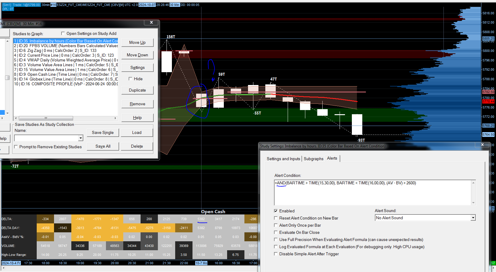

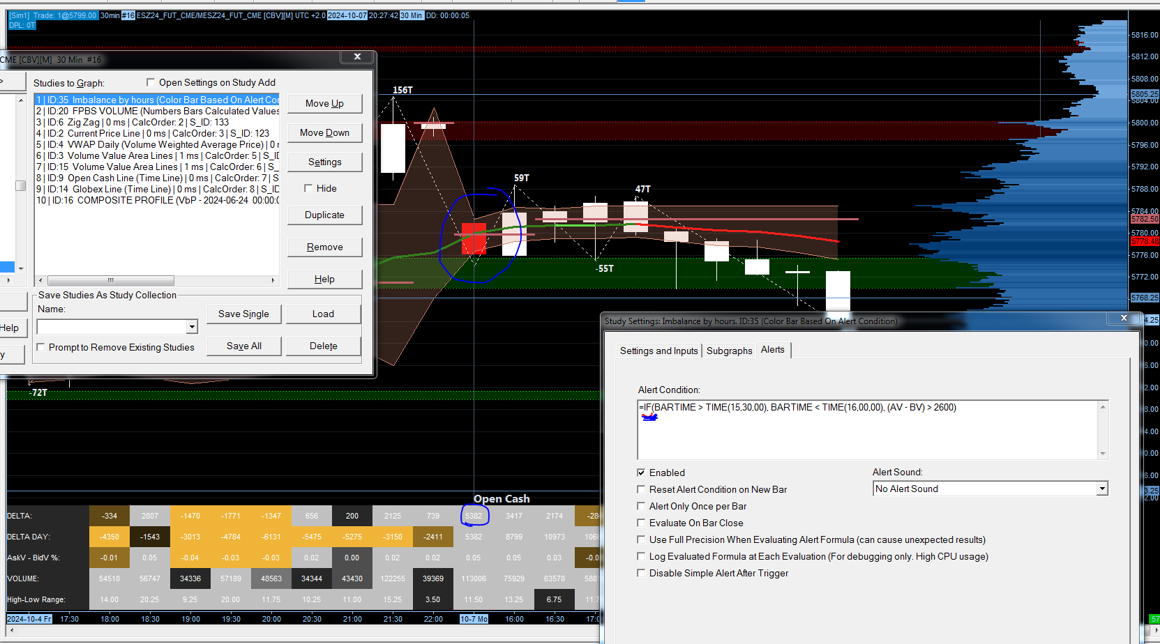

I tried using the AND() function as you suggested:
=AND(BARTIME > TIME(15,30,00), BARTIME < TIME(16,00,00), (AV - BV) > 2600)
However, when I use "=AND()", it doesn't color the candle. On the other hand, when I use "=IF()", it does work, although it's not entirely correct because it's affecting other time ranges as well.
Do you know why using "=AND()" doesn't trigger the candle coloring, but "=IF()" does? Is there a difference in how these functions are interpreted by the tool?

[2024-10-07 20:27:41]
The particular bar you are referencing in your image probably has a start time of 15:30:00. and according to your condition, the bar time needs to be greater than 15:30:00. To have this test for greater than or equal, you would change your condition to be the following:
=AND(BARTIME >= TIME(15,30,00), BARTIME < TIME(16,00,00), (AV - BV) > 2600)
