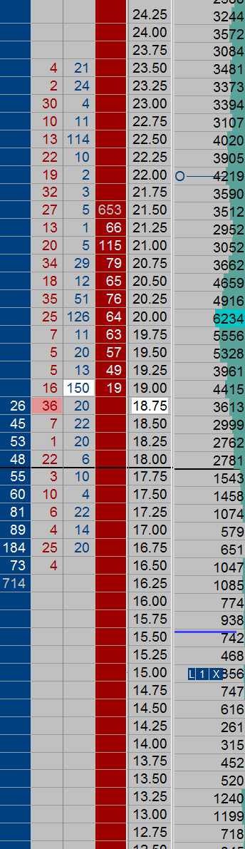

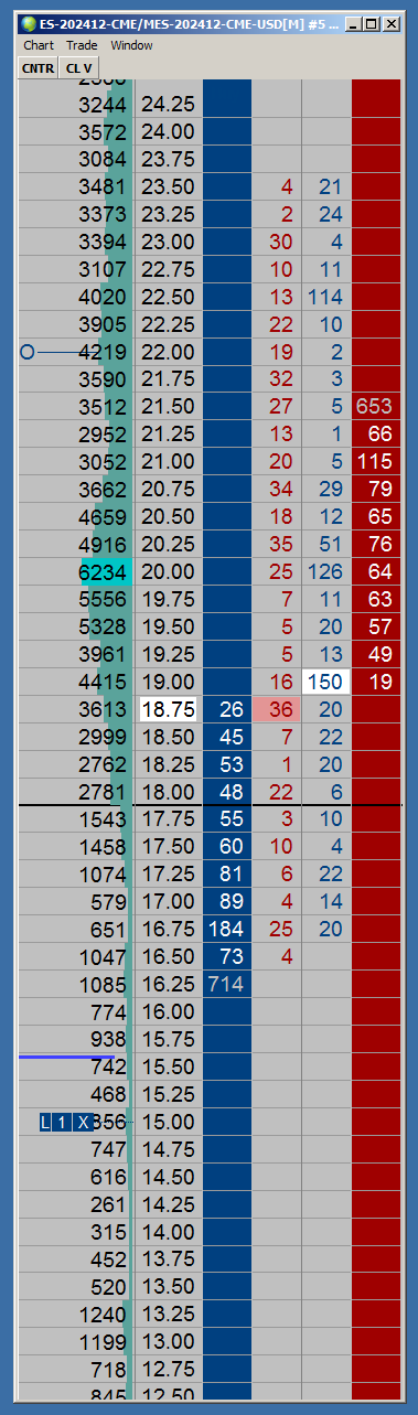

I would like to move the volume profile on my DOM to the right side. Is that possible? I could not find a way to move anything to the right of the ladder. I attached two images below, one of them being the DOM I use now, and the other being how I would like to have the DOM look (if possible).

imagemydomsept.png / V - Attached On 2024-09-27 15:46:30 UTC - Size: 59.82 KB - 307 views
imagedesired-dom.png / V - Attached On 2024-09-27 15:49:18 UTC - Size: 74.77 KB - 347 views
