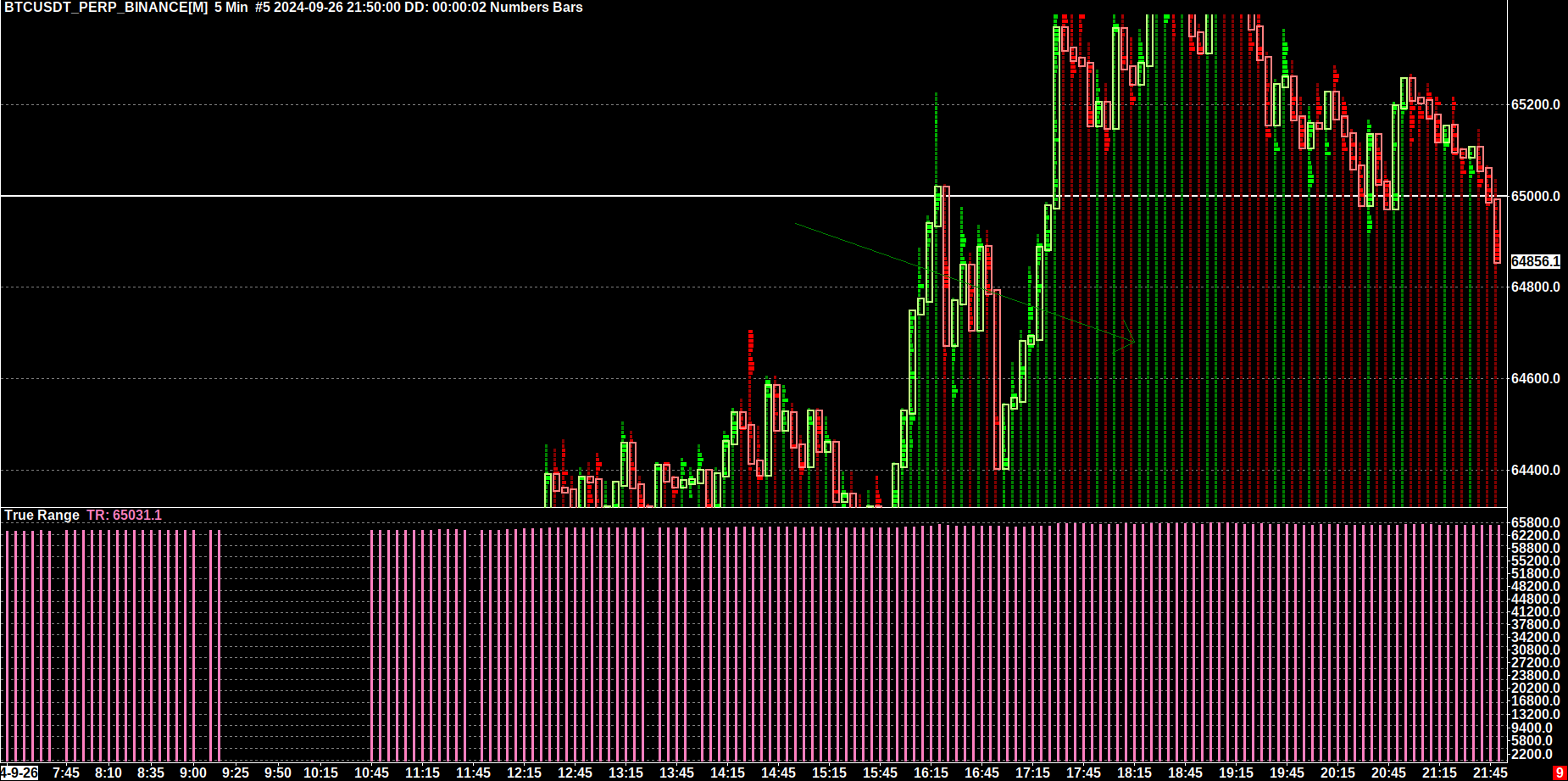

I have an issue with the BTC_USDT_PERP_BINANCE symbol.
Using the number bar study, bars are stretched from scale value 0 to the current market value.
This makes the visual complex and the Sierra Chart instance extremely slow.(see image)
https://www.sierrachart.com/image.php?Image=1727419873797.png
If I remove the numbers bar study, the bars have the right size,
but the "true range study" still shows extremely high value
as if the bars were of height (0, $CURRENT_MARKET_VALUE)
I deleted my local data and re-downloaded. Problem stays.
The problem seems to starts on Wednesday 2024-09-25 in the 0800 - 1200 UTC area.
I don't remember changing my configuration. Did I do something wrong or is it coming from Binance please?

In regards to the incorrect range, we are definitively not going to spend time looking at that when it comes to substandard data like Binance. There is no support here at all regarding that Binance data.
Date Time Of Last Edit: 2024-09-27 11:52:02
[2024-09-27 13:12:46]
Actually we just realized what the problem is. Binance is sending zero values for this symbol. We are going to do an update on the servers now, to filter these values out. This will not correct the past existing data for the last several days this has happened. But it will be correct going forward as of about 30 minutes from now.
[2024-09-27 14:18:48]
We are confirming the issue is resolved with the Binance data and zero values.
[2024-09-27 15:26:29]
valk - Posts: 5
I also confirm the problem is solved. No problem for the past data.
Thank you for taking the time to investigate.
It's much appreciated.
