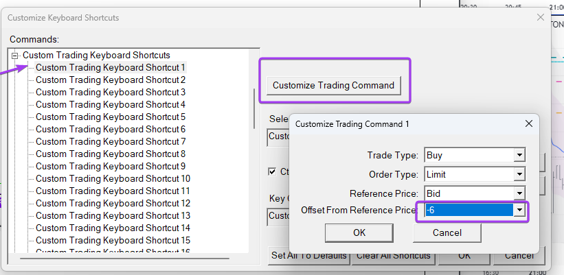

TopGunTrader, did you use the custom trading keyboard shortcut and then assign that to a hotkey ?
That allows you to eg have a bid minus 99 ticks so should be plenty of scope for what you are looking for
See attached image

Acro thank you wasn't aware of that option! Appreciate it SOO much this will be so great during high volatility times and for NQ need wider entries.
