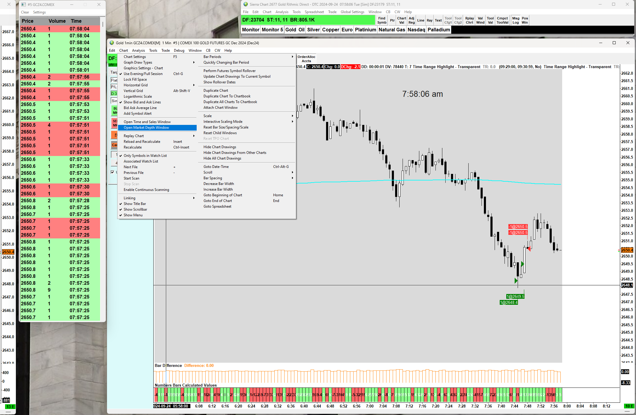

when I open SC the market depth window is not visible (black arrow in the attached image). So I need to reopen the market window any time that I open SC.
Can I fix this in some way?
imageScreenshot 2024-09-13 164643.png / V - Attached On 2024-09-13 20:52:47 UTC - Size: 279.18 KB - 191 views

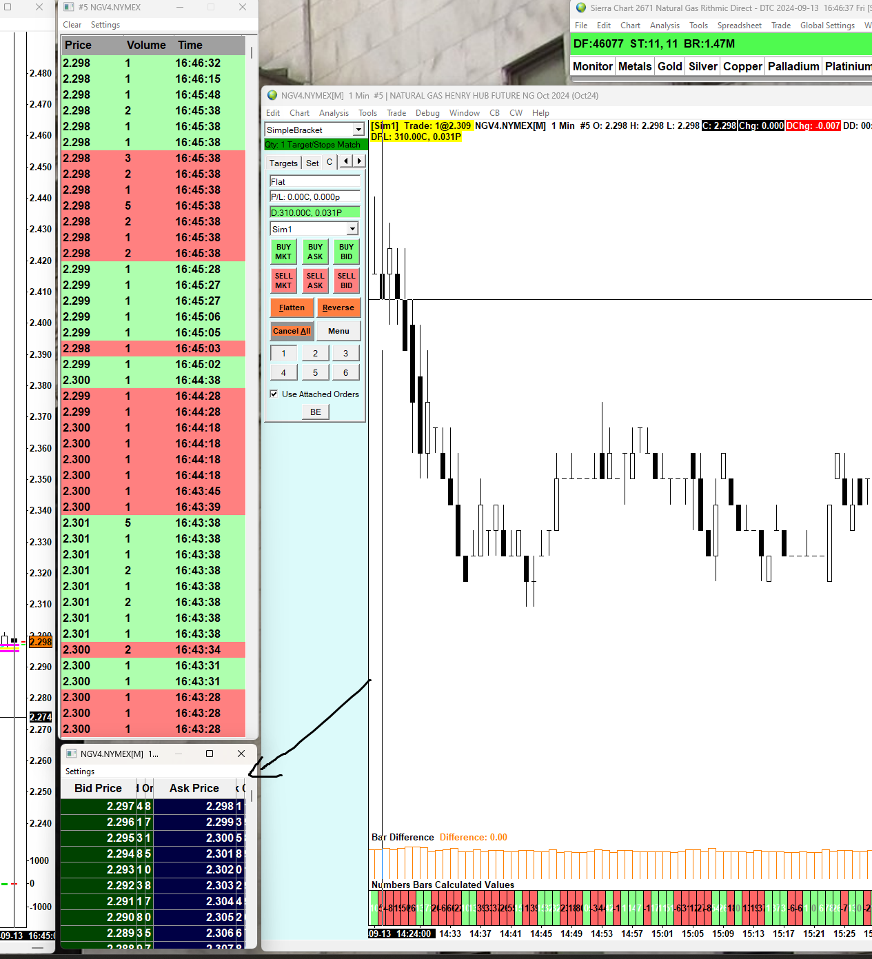

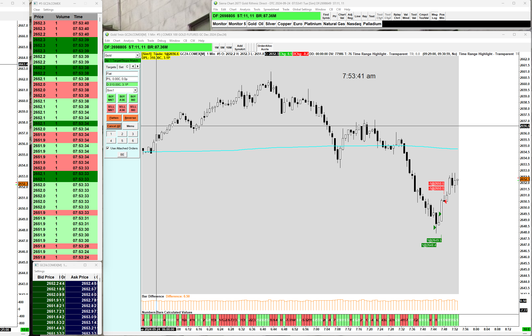

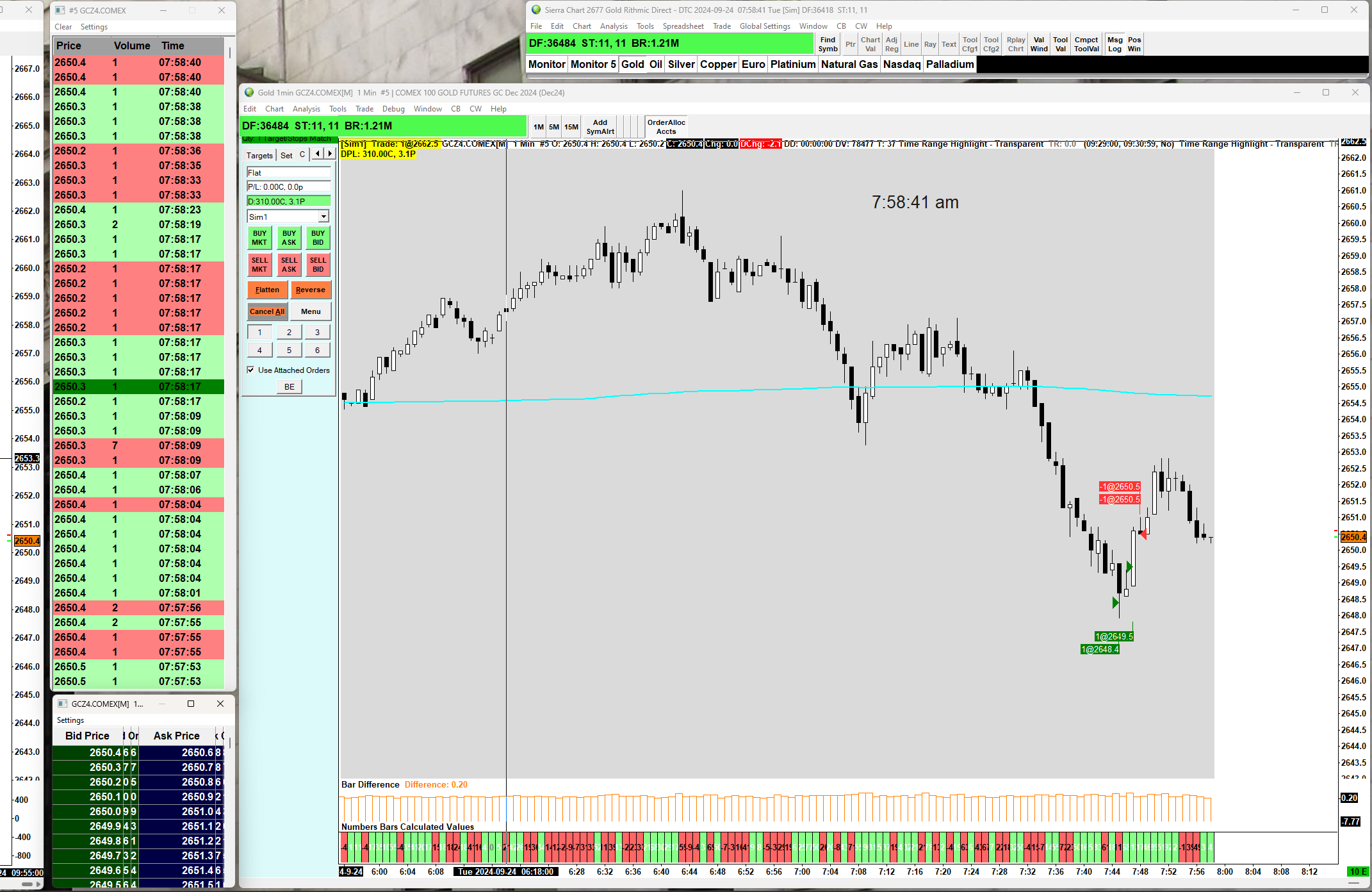

Example:
- screen1 is the status of the window when I close SC
- screen2 is how is visualized on reopen SC
- screen3 is the action that I need to do anytime to show the window (I need to do this for every chartbook that I have in the upper right corner)
- screen4 is again as screen1, but if I close SC and reopen it, market depth window is not there.
Thank you,
Ervin

[2024-09-24 12:06:04]
User474110 - Posts: 12
File attached
imagescreen 4.png / V - Attached On 2024-09-24 12:06:00 UTC - Size: 390.73 KB - 161 views
