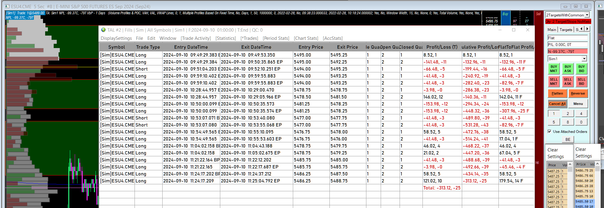

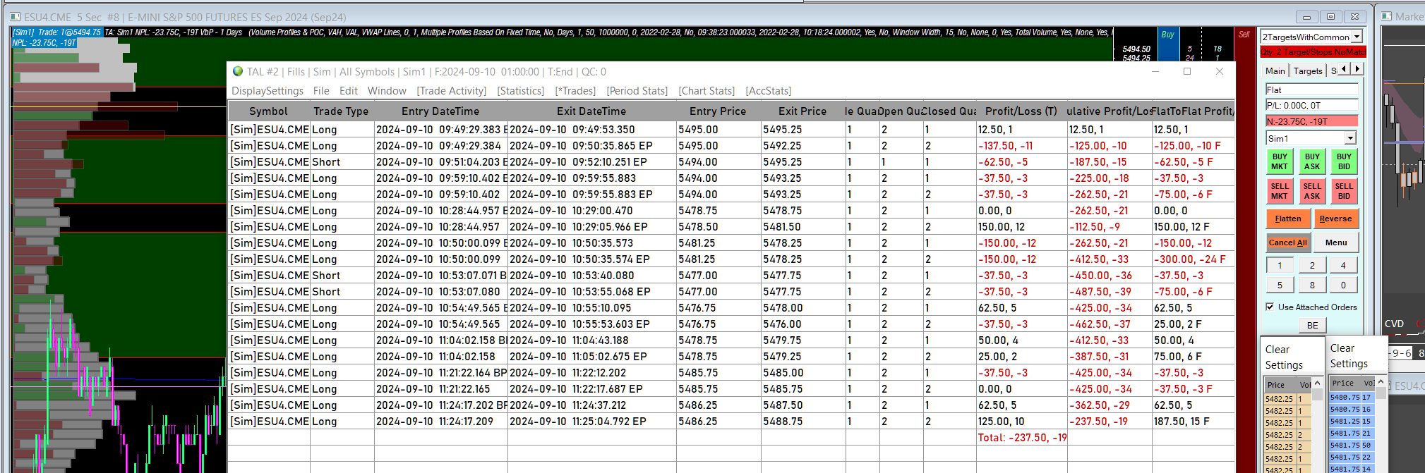

User715828 - Posts: 61
When I set the "Chart >> Chart Settings >> Trading >> Use Symbol Commission Settings in Trade List and Statistics Calculations". the profit and loss are way off. It does not agree with what shows in the Trade activity log. It seems that the symbol commission being used in the trade window is much greater that the commission being used in the Trade activity log.
When i set use commission to "No" in both places the profit and loss agree but when I set the use commission to "Yes" in both places the trade window shows a much larger loss than the trade activity log.
I am sending 2 images that show the profit and loss in the trade activity log and the trade window. One is with commissions and one is without commissions. You will see that the image without commission are the same except that the trade window is off by a factor of 10. this is another issue that I would like to fix.
This image with commissions are totally different and the Trade window loss is much greater making me believe that the commission being used by both windows are different.
This is with trade simulation mode turned on.

[2024-09-10 22:02:58]
Sierra_Chart Engineering - Posts: 25094
What is the commission that you have set in Global Settings >> Symbol Settings and for what exact symbol?

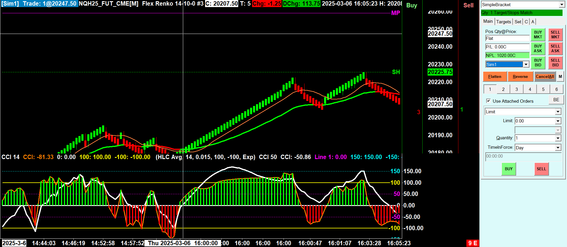

[2025-03-06 19:07:25]
m27trader - Posts: 3
Hello Sierra Chart,
Please note that the commissions listed in the Trade Activity Log are calculating incorrect (almost twice the 3.8 per round trip as listed in the Global Settings > Symbol Settings in the Other Settings for "Use Global Round Turn Commission".
In addition, the Trade Activity Log show a negative P/L number and the listed NPL in the Trading Window shows a positive number?
Also note that the "Use Custom Symbol Setting Values" is checked (also tried unchecked).
Also note that "Use Symbol Commission Setting in Trade List and Statistics Calculations is YES (also tried NO).
Also note I am siming under Sim1 and using the NQH25_FUT_CME[M] symbol
Any additional info to obtain accurate trading stats is greatly appreciated. Thank you.

[2025-03-06 23:21:17]
Hello Sierra Charts
Please screen shot of the NPL showing $1020
https://www.sierrachart.com/image.php?Image=1741302394640.png
Cannot figure out how to print/attach Trade Activity Log files... however, the Profit/Loss (C) is showing -1932.60 in the Trade Activity Log under *Trades.
In *Statistics the Total Commission listed is 2952.60 with 441 Total Trades (commission is set at 3.8, Total Commission should be 1675.80 ??
I have confirmed all settings listed in this message.
Please help, thank you.
Date Time Of Last Edit: 2025-03-06 23:21:37
