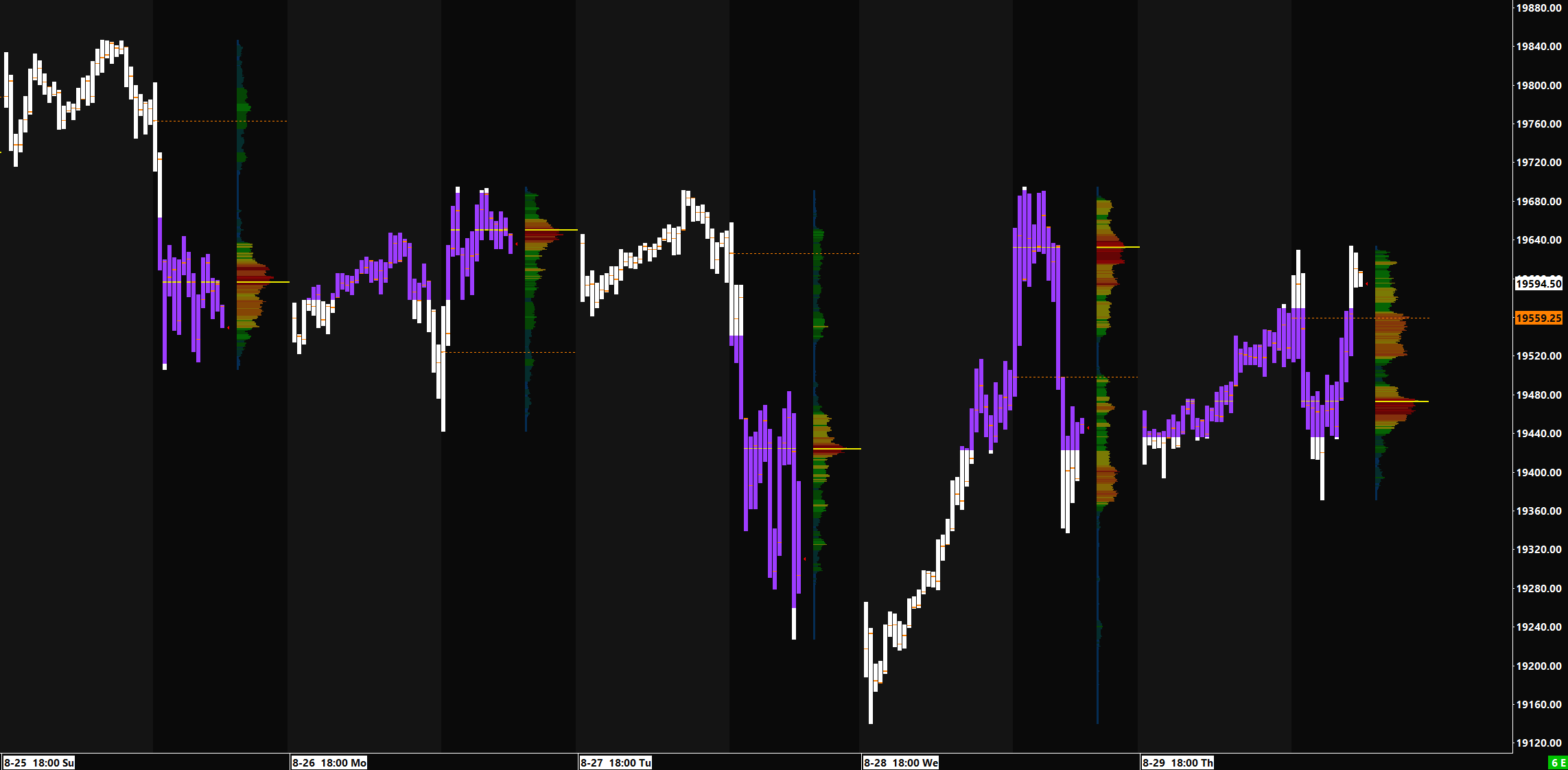

I have a TPO chart on which I want to highlight the ETH session to visually separate it from the RTH session. The desired result is shown on Screenshot 1.
I did this by creating another chart with a Time Range Highlight study (which highlights the time period 18:00 - 09:29:59), and using the Study/Price Overlay study to get this study onto my TPO chart.

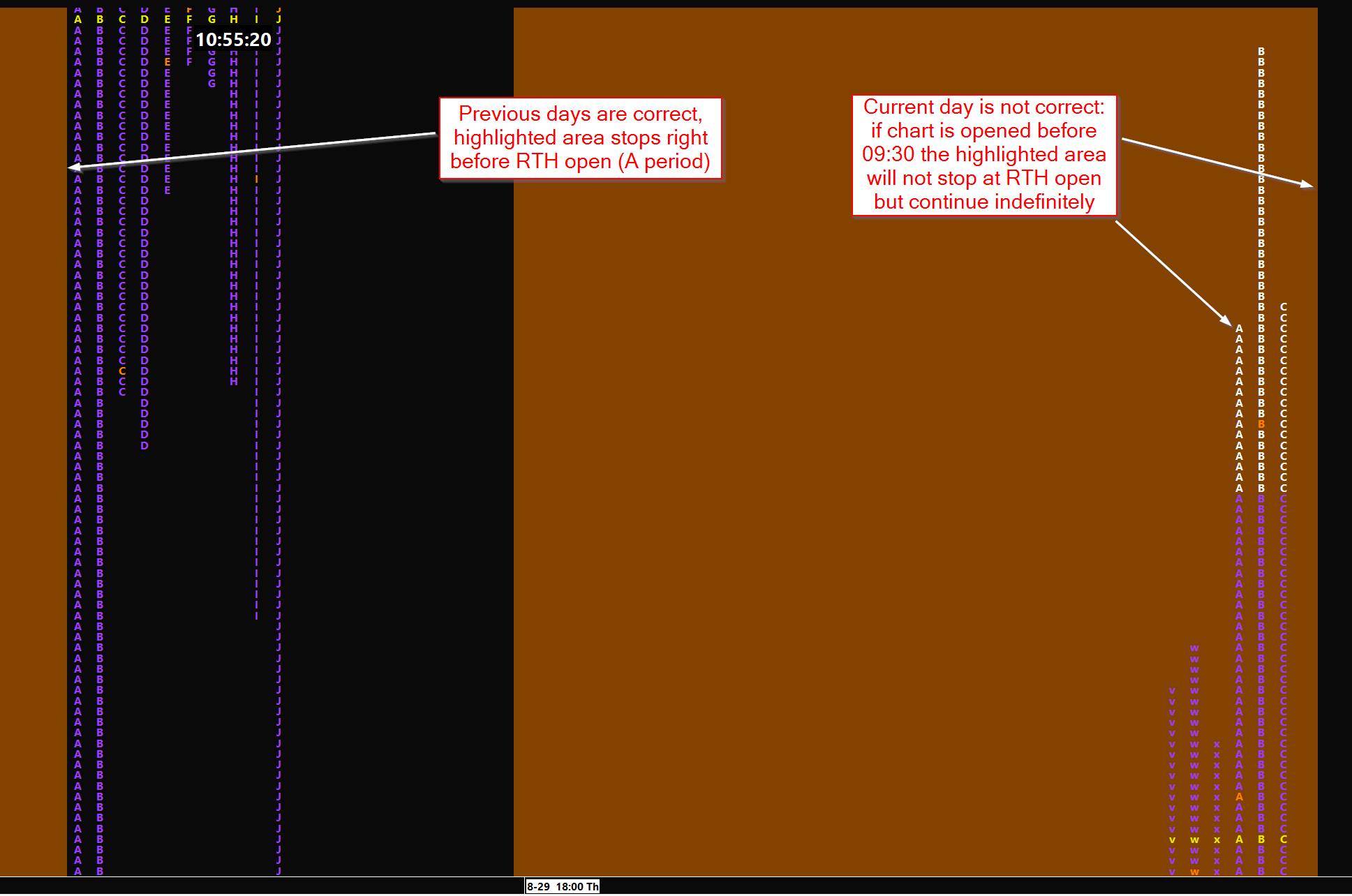

Screenshot 2: When I open the TPO chart after 09:30, everything looks fine and as expected (I used orange in this example for better visibility): The highlighted area correctly stops on the last ETH column and before the RTH opens with column A.

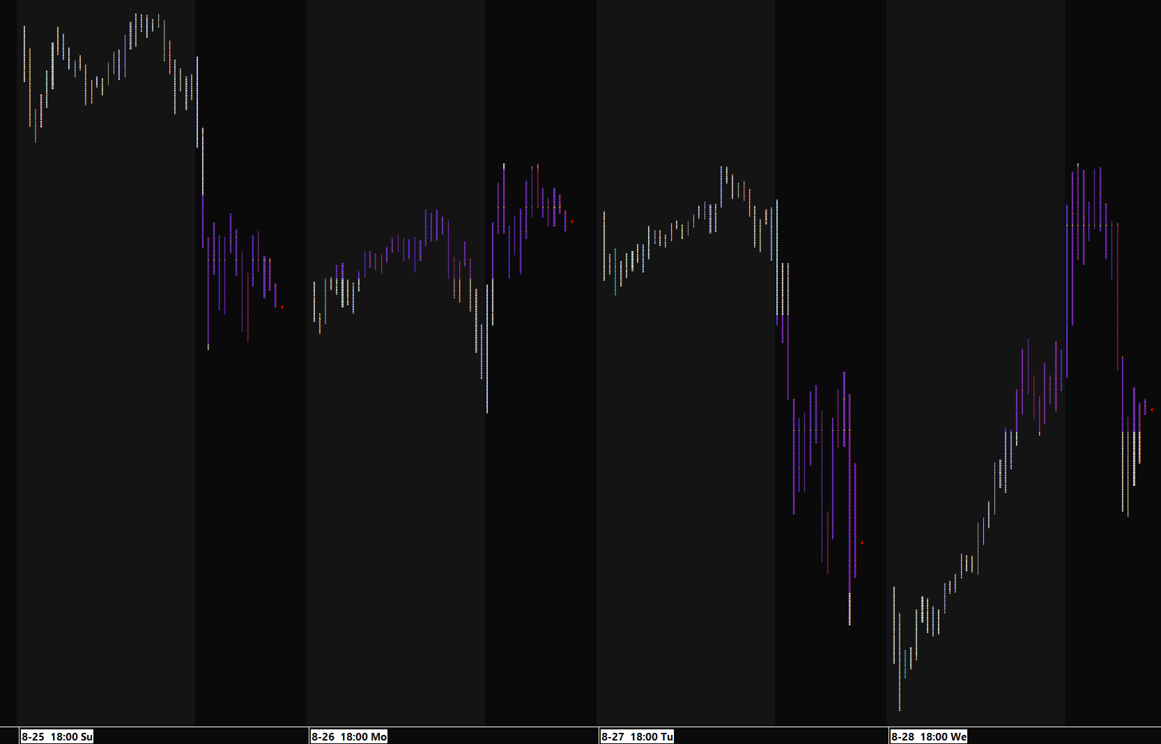

Screenshot 3: When I open the TPO chart at any time before 09:30, and then simply keep it open when the market opens at 09:30, the previous days are still correct (i.e., highlighted area stops before RTH open on these days), but the current day is not rendered correctly: the highlighted area for the current session does not stop before RTH open but rather continues indefinitely and eventually covers the whole day (ETH + RTH).
I can fix this "rendering issue" seen in Screenshot 3 by temporarily hiding the Study/Price Overlay study and then showing it again. This "refresh" will redraw the zone correctly, and afterwards it looks as shown in Screenshot 2.

TPO charts do not use a standard method of defining time, therefore an item like the Time Range Highlight is not going to work properly on this chart, even with a Study/Price Overlay.

But I rather need to see only one value area and one VbP per trading day. The attached screenshot shows how it currently looks in my chartbook.
The only thing I actually need is a way to mark the RTH open. I already use a "Horizontal Line at Time" study (orange line) to mark the opening price at 09:30 (which interestingly works fine if I copy that over from another chart via the Study/Price Overlay).
It just would be very helpful to visually mark the opening column A of the RTH session in the TPO as well.
I had hoped the Time Range Highlight would work because the Horizontal Line at Time works as well.
But if I understand your answer I'm probably out of luck here and there is no proper way to achieve what I want to do? In this case I guess I have to live with my previously described workaround, i.e., toggling the visibility of the study after RTH open to render it correctly.
