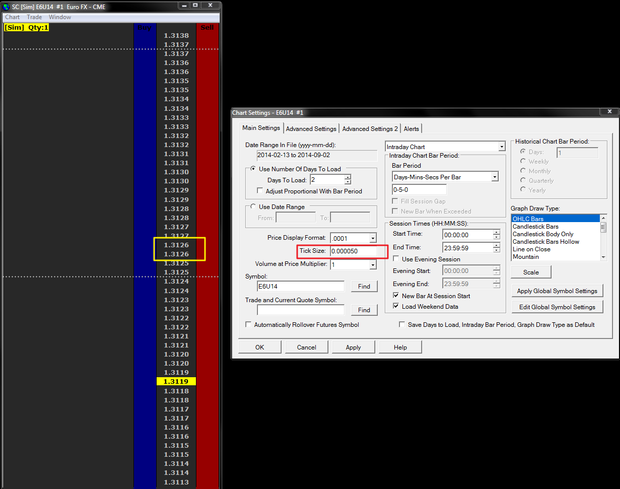

User30668 - Posts: 108
The Tick Size is set to 0.0001 (Default).
I have already tried to change it before (for 0.00005), to see if it would allow the Grid to be set the way I need. However changing the tick size this way causes the duplication of the price values on the Trade Dom ladder.
(Please see the screenshot attached)
Date Time Of Last Edit: 2015-07-05 02:36:38

[2014-09-03 01:13:08]
To avoid the duplication of prices, you need to set the Price Display Format to .00001
[2014-09-03 10:14:41]
Sorry, I think you are missing my point.
If I set the Price Display Format to .00001 and keep the Tick Size set to .0001 then the Trade DOM will show one more figure (0) at the end of each Price (i.e. 1.31560 instead of 1.3156). I could manage to trade like that but this way the Horizontal Grid lines still keep "jumping" up and down anyway, the same way as I described in post #1.
If I set the Price Display Format to .00001 and set the Tick Size to .00005 (in order to get the .5 tick) then the Trade DOM will show one more figure (0 or 5) at the end of each Price (i.e. 1.31560 / 1.31565).
This way the Horizontal Grid will be stable every 25 ticks (not 12.5) and half of the Trade DOM prices will be false figures because the instrument doesn't have them available.
This option is obviously not a solution as I can't trade from a Trade Dom with nonexistent prices.
