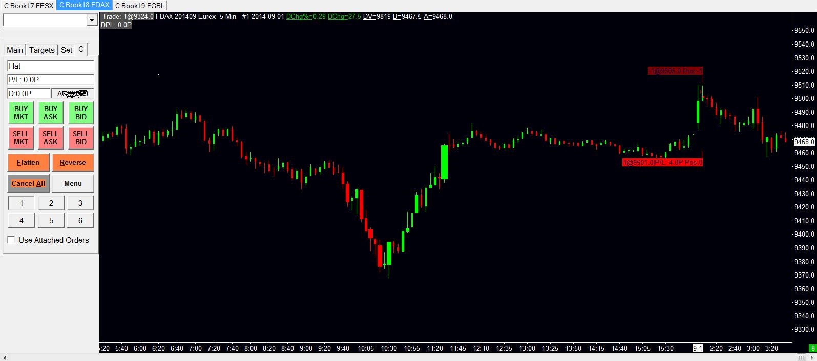

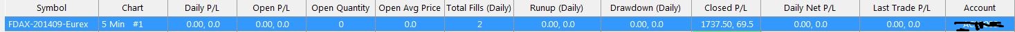

Hello SC Support,
Upgrade Issues Daily P / L on Trade Window
and on Trade Activity Log
I attach pictures to show the problem
waiting for reply
Thanks in advance
imagefdax.jpg / V - Attached On 2014-09-01 08:00:43 UTC - Size: 148.63 KB - 617 views
imageSC 1182 Trade Activity Log.jpg / V - Attached On 2014-09-01 08:00:59 UTC - Size: 30 KB - 594 views

the problem is evident in the attached images.
This morning I had two operations on the dax
in fact shows on trade stats for chart (Total Daily Fills 2 position)
in the same table the Daily Net P / L is 0
the error in the calculation of profit daily ... the exact count must be 100.00 eur

salsem - Posts: 43
yes...I read
does not work
on Trade Statistics : total P/L for closed traders on Daily Traders is 0.00
i have FDAX 2 contract filled , the exact count must be + 100.00 eur (Daily Traders)

[2014-09-02 16:38:23]
We have looked into this, and have not identified a problem yet.
Could you please clear the non-simulated Trade Activity Data for the FDAX symbol following the instructions here:
https://www.sierrachart.com/index.php?l=doc/doc_TradeActivityLog.php#ClearingtheLog
After this let us know if you still see the problem.
[2014-09-02 21:24:57]
We now have identified the problem and will be resolving it.
Date Time Of Last Edit: 2014-09-02 21:25:05

[2014-09-03 05:46:33]
This should be solved in version 1186 coming out now.
While working on this problem we were not able to reproduce it, but we did find a spot that was not correct with the handling of time adjustments for order fills. This can lead to the problem. We think we have solved it but let us know if you still see it.
