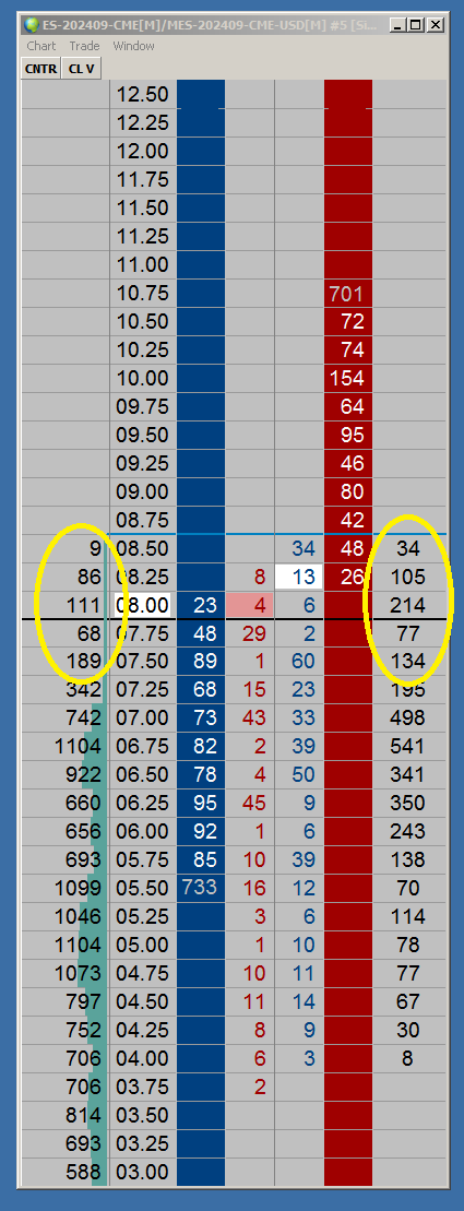

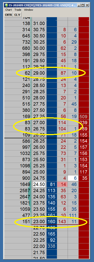

I currently have a volume profile study setup on my DOM. I noticed that not only is it slightly delayed, but that it's completely missing trades that occur at that price level. Here are some screenshots showing some examples of this occurring.

I did some tests and determined that the VBP study is not updating correctly, or that fast. here's an example of overnight trading for the ES. I added the "Current Traded Total Volume" column to the right hand side, to compare data. Notice the high of the day and how different the values are. Look at 08.50, it shows 34 contracts were bought at that price, and the column on the right shows the correct number, but the VBP study is only showing 8 contracts traded at that price.

imagevp-problem-4.png / V - Attached On 2024-08-23 02:49:21 UTC - Size: 51.59 KB - 195 views

[2024-08-27 13:07:04]
pinetrades - Posts: 19
Thank you for pointing me in the right direction. It looks like turning ON Use As Trade Only Symbol improved the accuracy, but it still didn't solve the problem. Once I changed Intraday Data Storage Time Unit to 1 Tick, it seemed to have 100% solved the problem. The combination of those two are what was needed.
