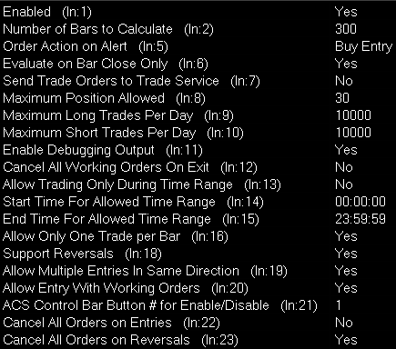

Hello, I looked in the documentation and support board but could not find the solution.
I attached screenshots of the complete Settings and Alert Condition.
Maximum Position Allowed : 30
Allow Multiple Entries In Same Direction : Yes
Allow Entry With Working Orders : Yes
Reset Alert Condition on New Bar : Ticked
Position should increase on the next bar since the formula is true, but this is not happening.
From the Trade Service Log:
"Trading is not allowed. Reason: Formula state has not changed. Current state: True."
Thanks for the support
imageSettings and Inputs.png / V - Attached On 2024-08-19 06:58:24 UTC - Size: 14.61 KB - 243 views
imageAlert Condition.png / V - Attached On 2024-08-19 06:58:31 UTC - Size: 8.15 KB - 175 views
[2024-08-20 01:45:46]
The formula state really does have to go back to False and then to True, in order to get another entry.
The source code for this study is available and you can modify it as needed:
How to Build an Advanced Custom Study from Source Code: Searching for Source Code for Sierra Chart Built-In Studies
