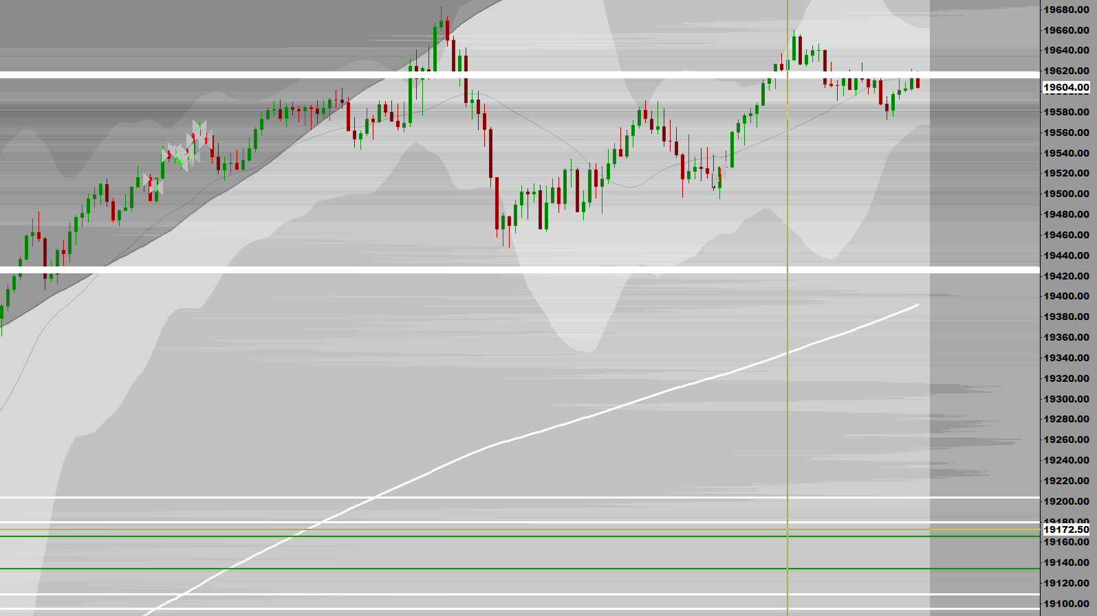

I altered the gradation in the color settings and POCs etc however, however after changing the maximum volume bar width percentage to 100, I still don't have the bars extend off the window. I'd like to see each bar essentially as a ray. I aligned the profile to the right edge which helps but I still see jagged outline of the VP which because of the variations in grey tones, I'm looking to do away with.

Cesium - Posts: 179
looks like the value can go up to 500 from testing, support team would know the exact value, but I think its 500 max
set *maximum volume bar width type* to window width
from testing it looks like this will do what you want
