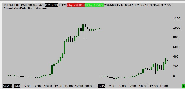

Hi there,
I have looked through the support board to try and fix my cumulative delta volume. I have gaps in between bars, I am unable to detect whether its a feed issue or settings issue. They both look correct to me.
Could you possibly advise? What I need to check? I can provide a message log if required.
Your assistance is appreciated.
Cheers
imageScreenshot 2024-08-15 160615.jpg / V - Attached On 2024-08-15 15:06:29 UTC - Size: 28.81 KB - 163 views
[2024-08-15 16:27:41]
In the "Cumulative Delta Bars - Volume" there are options for when the data resets. In particular, the Input for "Reset at Start of Trading Day". It looks like you have this set to "Yes". If you do not want the data to reset, then set this to "No". Refer to the following:
