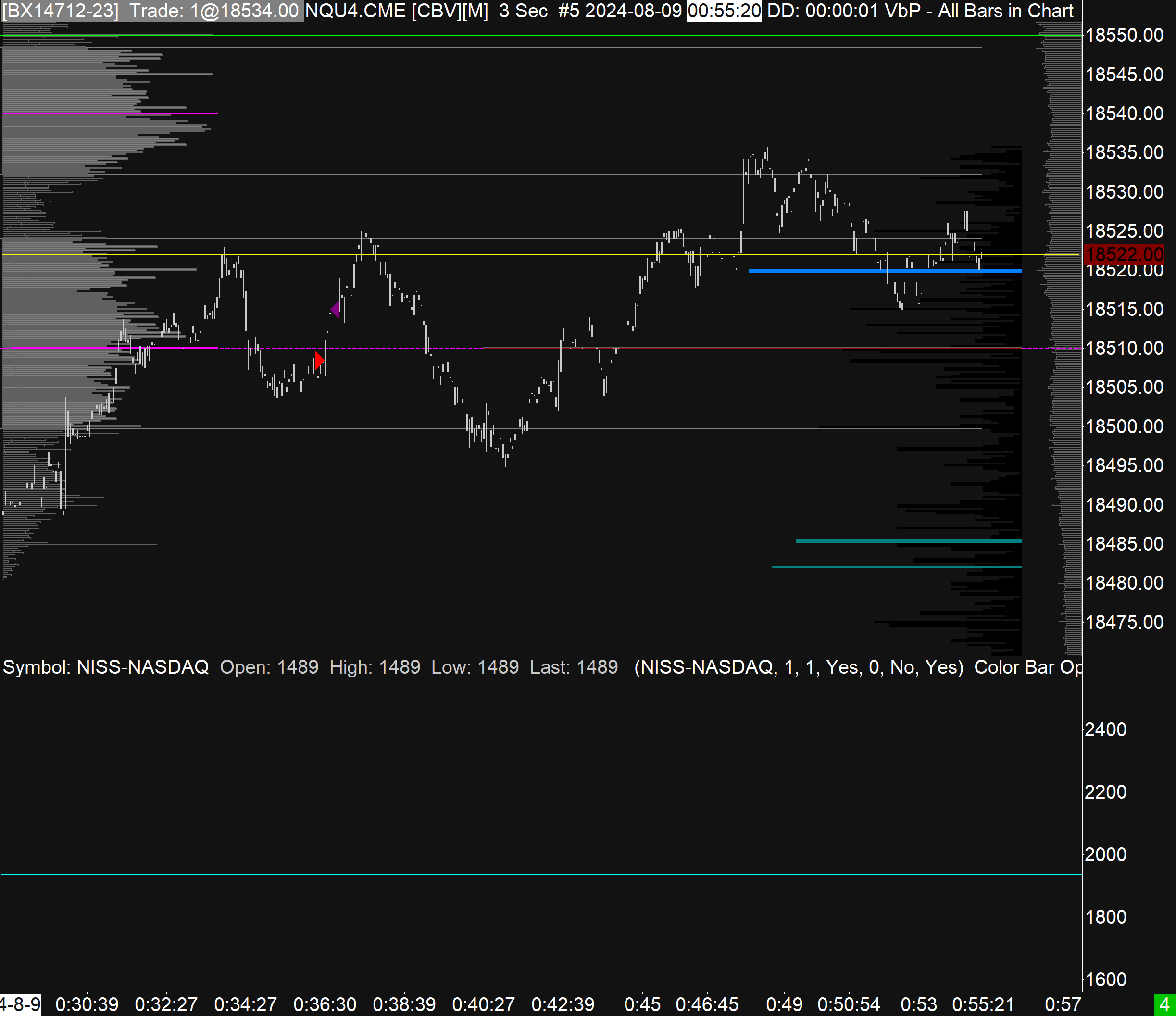

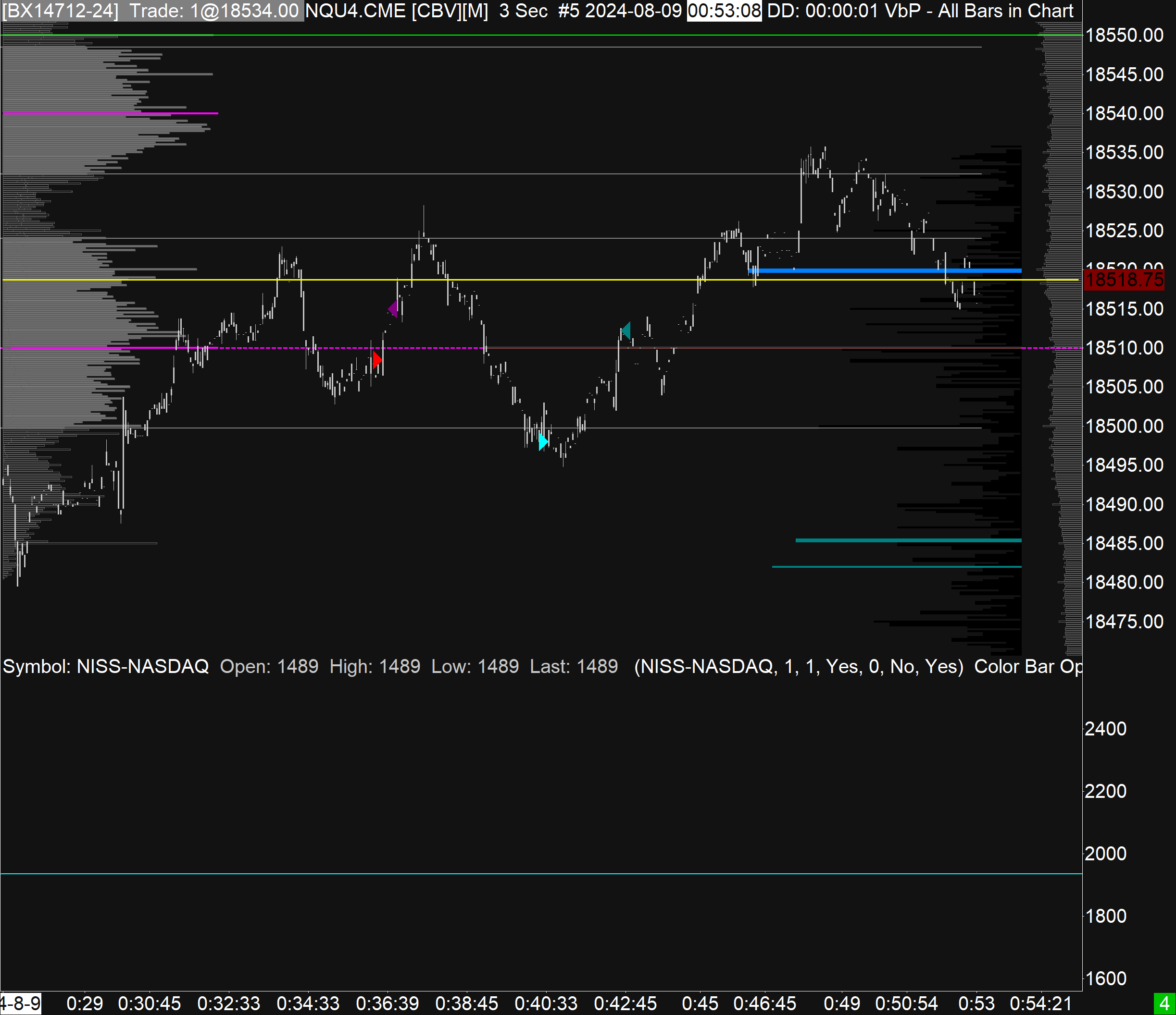

I have trade allocation setup for 5 accounts. It always works. Tonight I made two trades, for the first trade, trade allocation worked perfectly. On the next trade, trade allocation didn't work at all. I tested trade allocation by setting a limit order and it appeared as normal immediately after I noticed the discrepancy.
this image from my main account shows the two correct trades:
https://www.sierrachart.com/image.php?Image=1723182791880.png
this image from one of the secondary accounts shows the first trade, but the second didnt post, even though it obviously would have filled.
https://www.sierrachart.com/image.php?Image=1723182921873.png
I know there it nothing you can do about this, but I want to do what I can to make sure it doesnt happen again,
