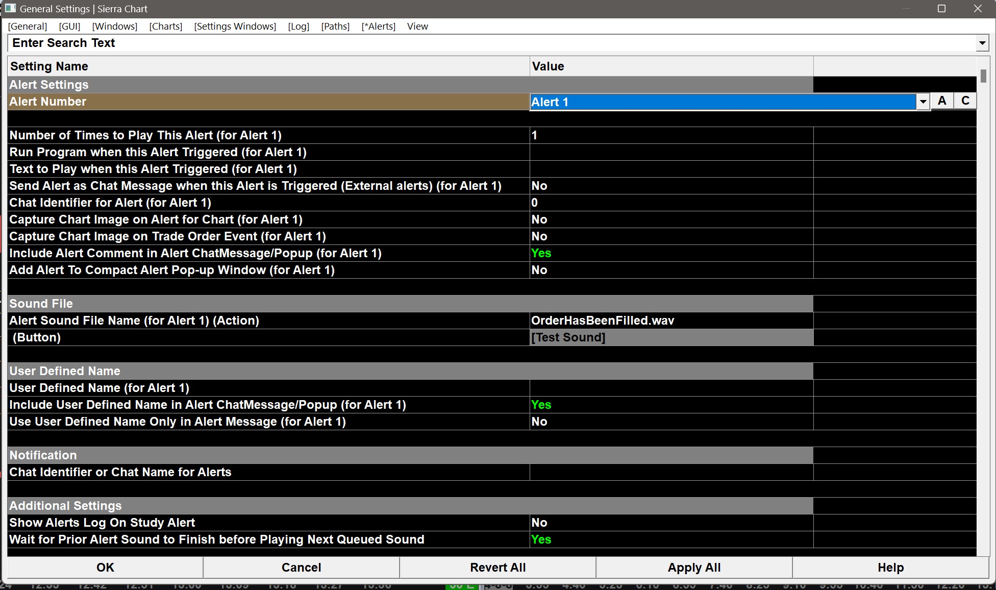

I have two alerts set up
general settings > alerts >
alert 1 = orderhasbeenfilled.wav
alert 2 = bulk.wav
I forgot the next step where I set where those alerts are triggered but I want it set up so that when an order is filled I get alert1 and when I cancel the bracket order (decided I didn't want to trade) I get alert2 sound.

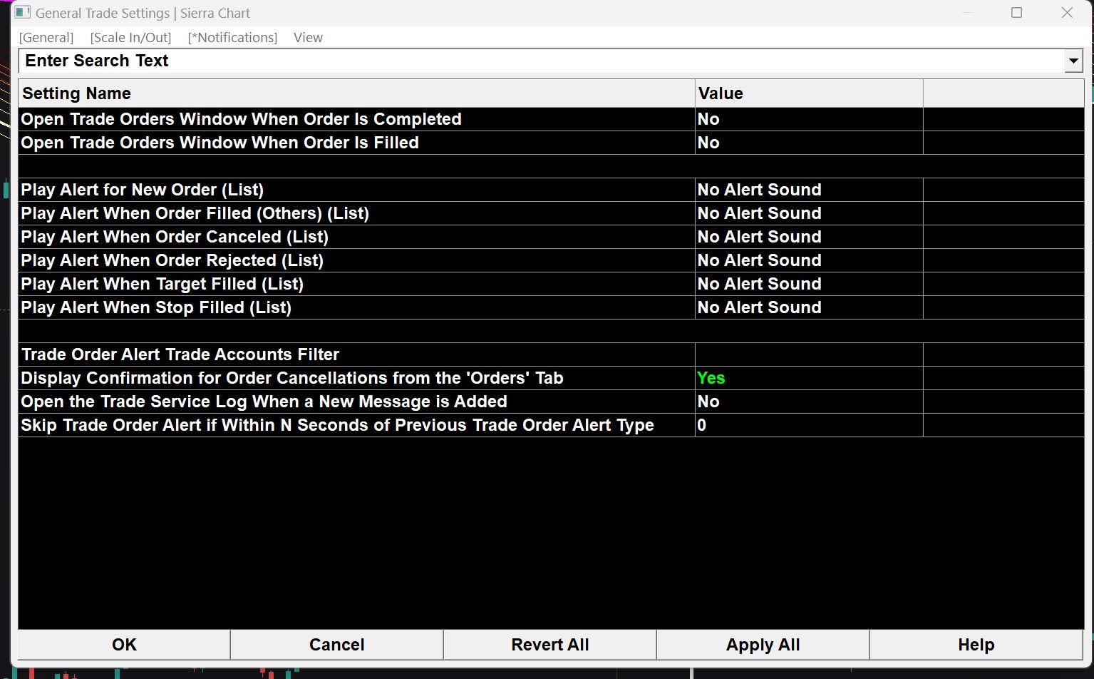

User429142 - Posts: 49
in the sub-instance, I set it back to no alert sound (see screen shot)
The problem is now when I make a trade in this sub-instance, I am not hearing anything.
imageScreenshot_5.jpg / V - Attached On 2024-08-07 21:03:53 UTC - Size: 259.52 KB - 251 views
[2024-08-07 21:48:07]
In the main instance is this same option set to a particular Alert Number?

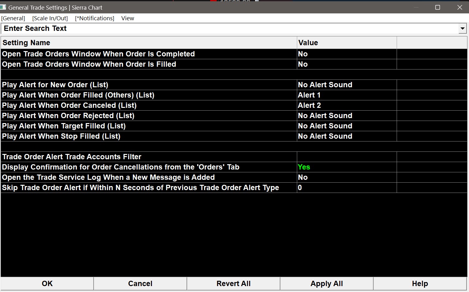

attached are the two screen shots that have to do with the alerts sounds.
Both are taken from the main instance.
Yes both were:
alert 2 = bulk.wav
