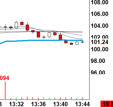

So I was comparing the VWAP to TradingView, DAS Trader etc. They have it spot on and it's all the same. But for some reason, it is most difference on Sierra Chart. How can I fix this?
I connected the images below to show you the difference. If you need any more information from me, just let me know!
imageTradingViewVWAP.png / V - Attached On 2024-08-06 17:25:10 UTC - Size: 7.17 KB - 403 views
imageSierraChartVWAP.png / V - Attached On 2024-08-06 17:25:36 UTC - Size: 8.67 KB - 444 views

We do not make comparisons to other systems. For information on how our VWAP is calculated, refer to the information here:
Volume Weighted Average Price (VWAP) with Standard Deviation Lines

I understand, but how do I make it similar. What exactly is the setting difference. I viewed the guide but couldn’t figure it out.
[2024-08-06 21:12:34]
We can not possibly answer this. We know nothing about how other systems perform their calculation. And this is not something we will look into. How we do our calculations is posted and tested.
The only thing we can state is that you might want to set the Input for "Base on Underlying Data" to "Yes". Refer to the information for this Input in the following section:
Volume Weighted Average Price (VWAP) with Standard Deviation Lines: Inputs

I looked into one of them.
How is the VWAP Calculated?:
Typical Price = Average of the High, Low and Close = (H+L+C)/3.
VWAP = Cumulative(Volume x Typical Price)/Cumulative(Volume).
How would I go around changing these to the ones above

Okay, news on this. I went with a custom VWAP study and the calculations are correct on that one compared to the one provided by default. I am going to test it further tomorrow. I will let you know how well it works when market opens.
If you don’t mind, can you look into the calculation I sent and how I can go around implementing that as it’s more correct.

The only thing we can tell you is to use the Spreadsheet Study to do create the VWAP that you want. Refer to the following:
Using the Spreadsheet Study

Aczero and for other readers, The reason tradingview vwap is different than sc calculations is even if tradingview claims to use the same formula, their data is not tick accurate and verified like sierrachart
i would not trust any volume based calculations from tradingview, even if they claim to use tick data
for that you always need tick data
if the tick data isnt stored on your machine it cant be trusted to not be aggregated
applies to volume profile, etc
