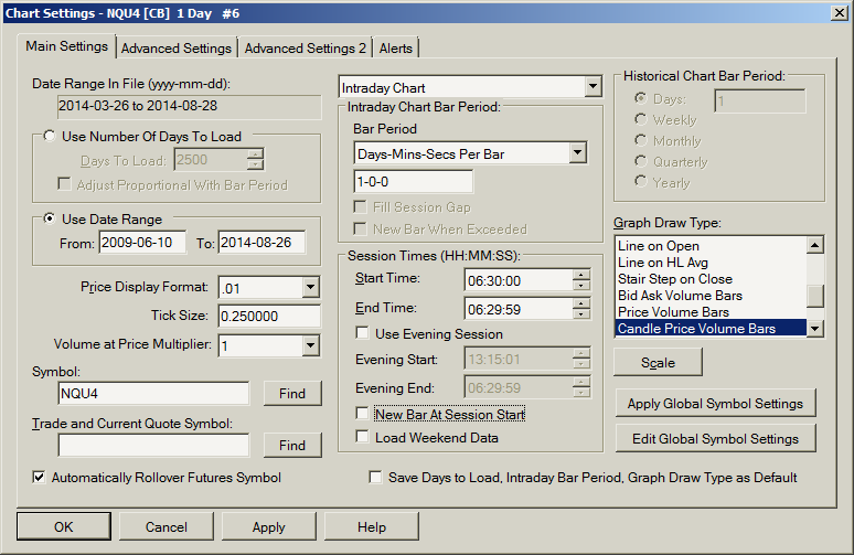

jivetrader - Posts: 410
hi, if my settings are as how the attached screenshot shows, then why am i seeing Sunday data in my data export (using the Spreadsheet Study) ?
imagechartsetup1.png / V - Attached On 2014-08-29 16:42:50 UTC - Size: 40.14 KB - 559 views
[2014-09-02 04:16:24]
The starting date for historical daily bars is what is considered the trading day date. Not the actual true starting date and time like Intraday charts will have.
You cannot reliably be making the kind of comparison you are.
