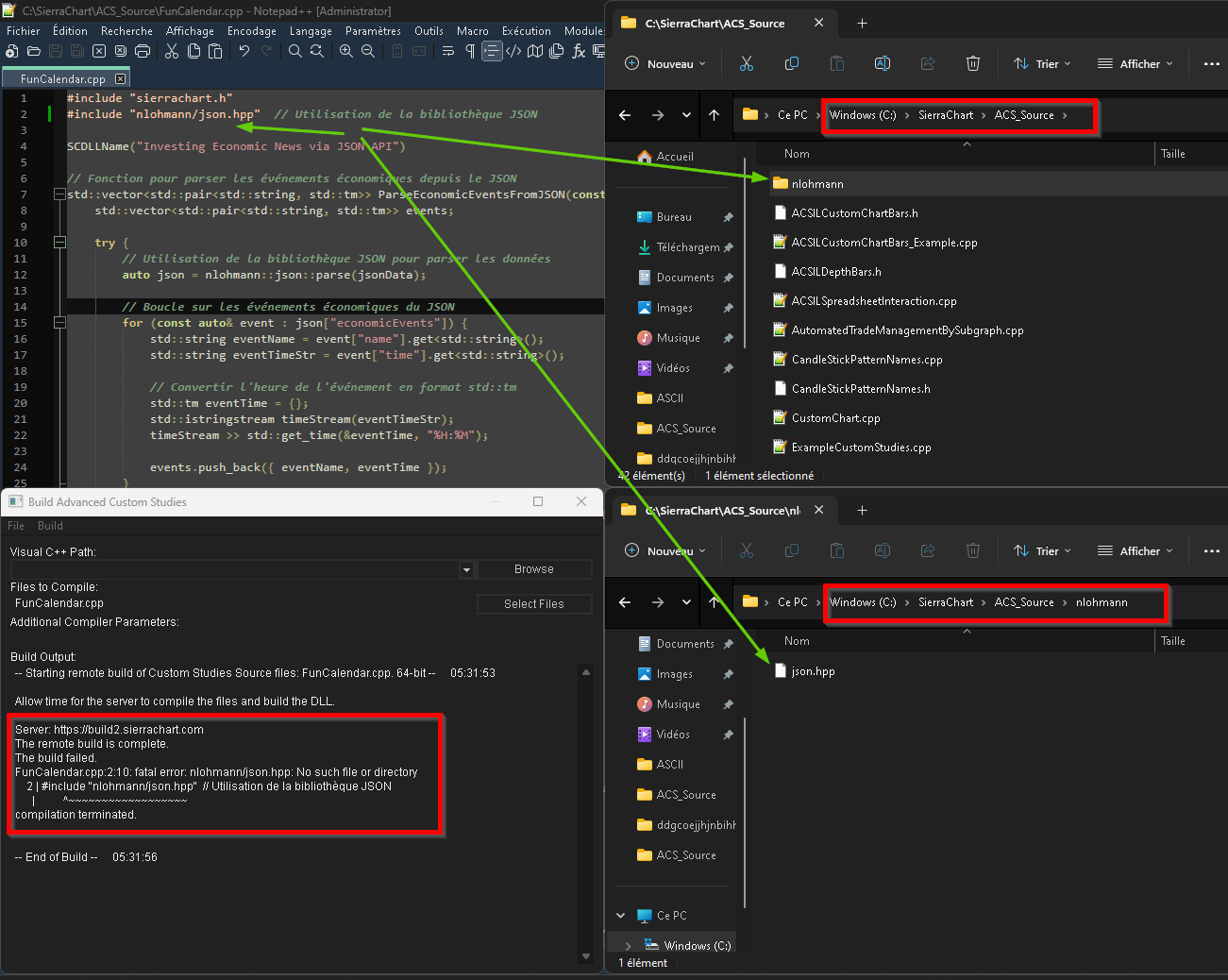

Hello, I also have this problem and I've tried several things but nothing changes. I always get this error.
I'll upload a screen to give you a better idea of the problem.
I even installed a new sierra to see if it was coming from my sierra installation.
-- Starting remote build of Custom Studies Source files: FunCalendar.cpp. 64-bit -- 05:42:55
Allow time for the server to compile the files and build the DLL.
Server: https://build.sierrachart.com
The remote build is complete.
The build failed.
FunCalendar.cpp:2:10: fatal error: nlohmann/json.hpp: No such file or directory
2 | #include "nlohmann/json.hpp" // Utilisation de la bibliothèque JSON
compilation terminated.
-- End of Build -- 05:42:57

[2024-09-24 12:00:32]
User431178 - Posts: 910
@Fungraphic72
Remote build won't work, "nlohmann/json.hpp" may well exist on your machine, but it doesn't on the server.
You need to use "Build with Visual C++ - Release" instead to build locally.

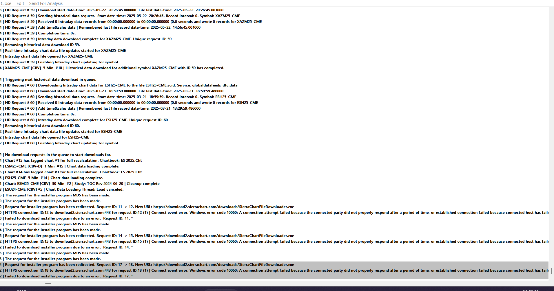

[2025-05-22 15:26:10]
User749673 - Posts: 28
Download current version not working Admin Team
Windows error code 10060 is coming while download is not allowed
imageScreenshot 2025-05-22 205230.png / V - Attached On 2025-05-22 15:23:12 UTC - Size: 139.76 KB - 322 views
[2025-05-22 16:22:33]
Please try performing an update again. We have multiple servers for this, so you should be able to get it work with one or two extra tries.
