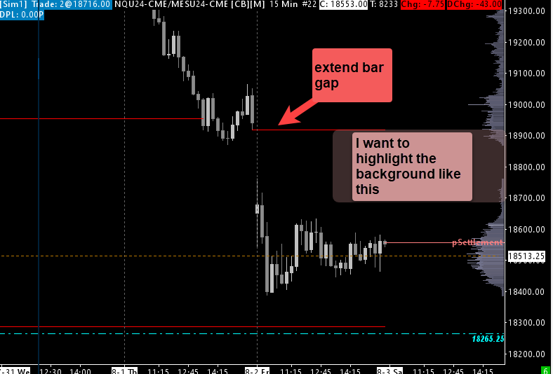

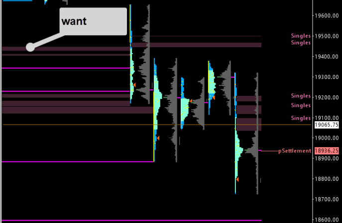

I would like to see the gaps between RTH sessions, as drawn background until further intersection (similar to how TPO can draw singles).
- This basically drew a line, which is a good start: Gap up Gap down
- #22 on this thread might help, alert when gap, but idk how to use this info: Gap up Gap down
I've been trying for a long time, but couldn't figure it out & having to manually draw the gap high & low manually "/
imagegapwant.png / V - Attached On 2024-08-04 17:21:36 UTC - Size: 35.52 KB - 493 views
imagetposingles.png / V - Attached On 2024-08-04 17:22:29 UTC - Size: 47.24 KB - 300 views

In order to get the background coloring in the way you want, you would have to either use the Spreadsheet Study and put in all the logic for where the coloring starts and stops, or you would have to create a custom study. The only built-in option that comes close to what you want is the "Extend Bar Gap Until Future Intersection", which you have already found only draws the line.
