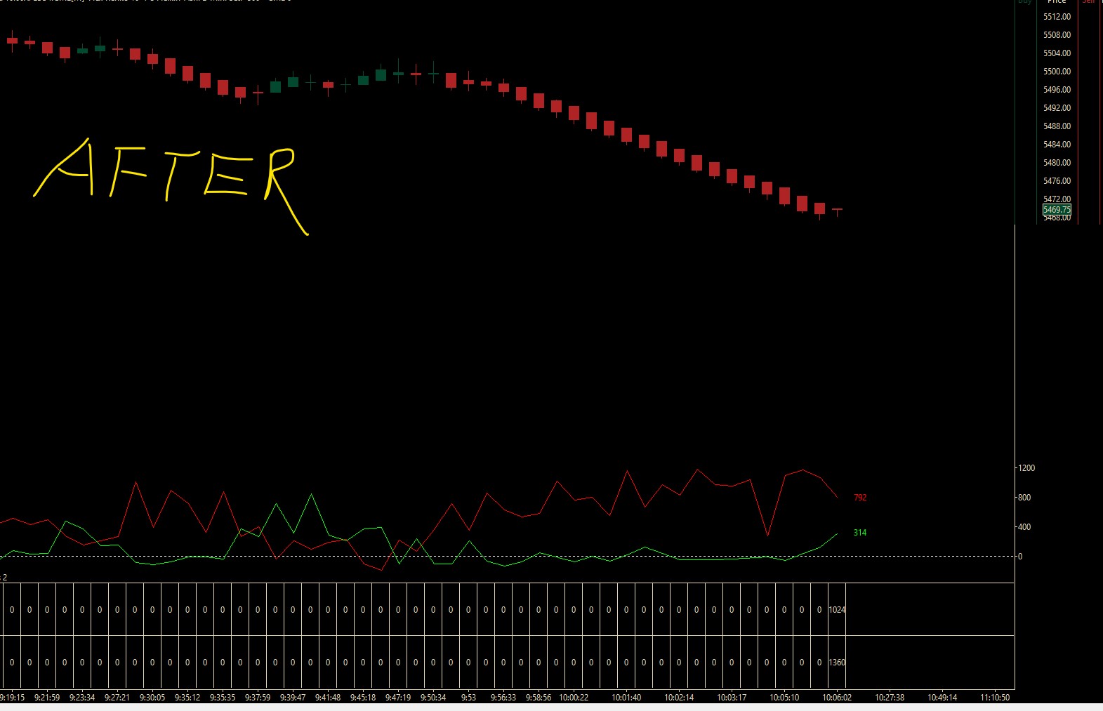

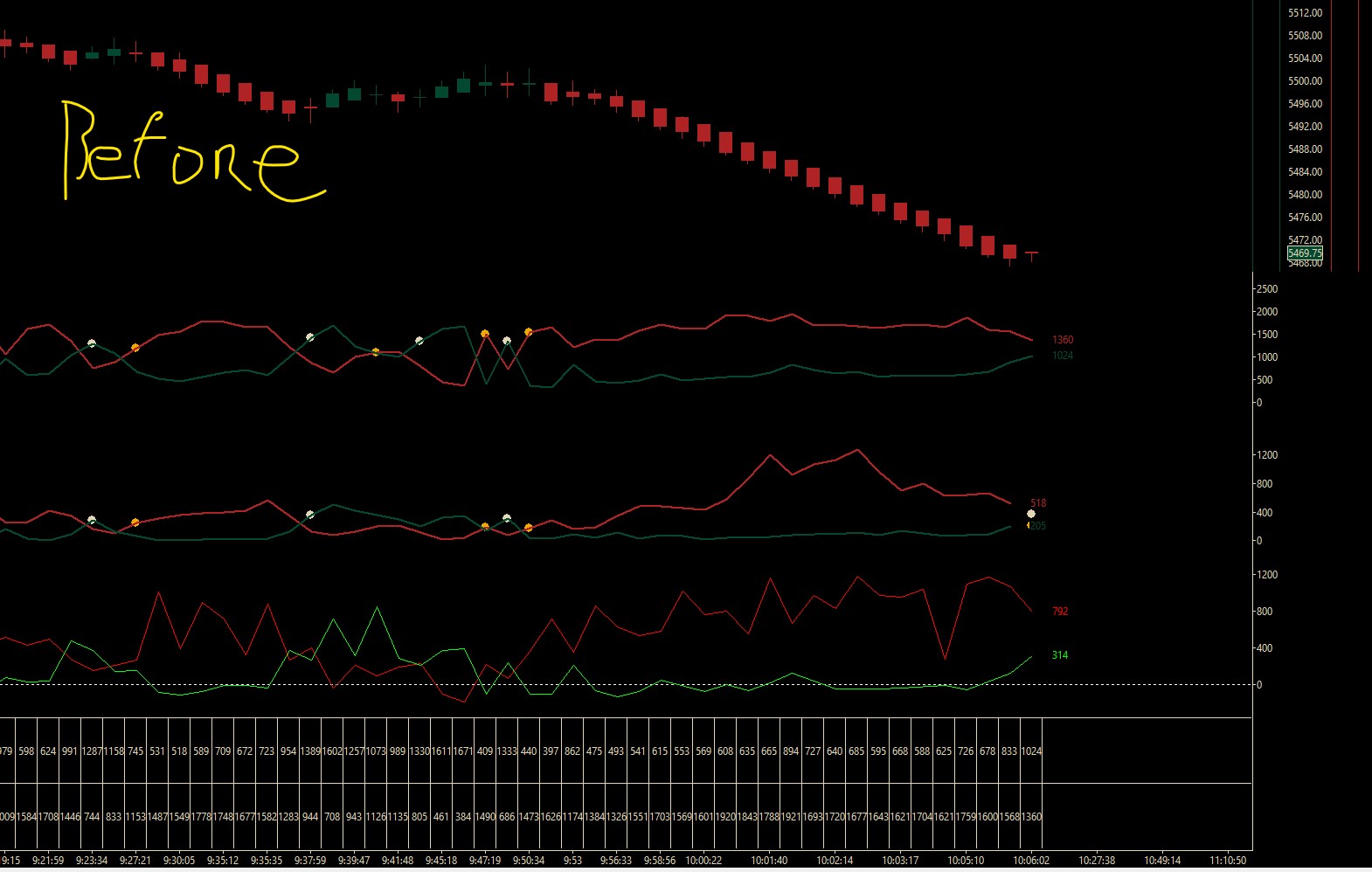

I have a study to track DOM Stacking/Pulling and a study to track DOM Recent Bid Ask. The challenge I have is preserving the DOM data on screen refresh. I am using sc.IsFullRecalculation to not wipe out the subgraphs on a recalc of the chart. However, if for example, I access the Studies window and hit Apply or OK the subgraphs zero out and start over and the previously displayed subgraphs are gone. I have attached a before and after picture of the same chart. Preserving the previously displayed values must be able to be done since a third party study in Region4 does just that. I noticed the Numbers Bars Calculated Values v2 also resets the values. Any ideas anyone? Thanks! Mike

[2024-07-31 01:13:40]
ondafringe - Posts: 343
It might be helpful to know why you are going into Studies and hitting "Apply/OK"
[2024-07-31 04:03:07]
TriStar Trading - Posts: 201
Because for example, a different study needs a tweak. The point is, when the chart completely refreshes, the currently displayed data is lost. I'm trying preserve the data already displayed as the third-party does. Thanks
