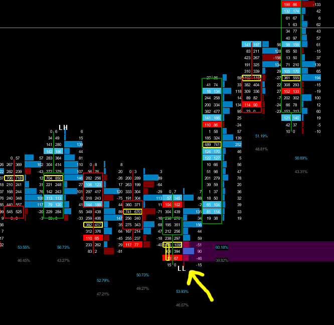

Thanks for the reply. But maybe I should be more clear with what I'm looking for. See attached.
I'm using footprint(Number Bars) and I would like to set a bar alert condition when a green bar opens/closes above the POC and vice versa.

The more I think about it, a bar cannot open above the POC because on the opening tick it is the POC. So you can really only deal with closes above/below the POC. Even though the numbers bars are being used, I did not see a way to access the POC value from the numbers bar study. That's why I thought to use the SC Volume Point of Control for Bars. I have done this in the past. You could use the numbers bars calculated values study but I think there is more overhead in that study. Do you want know if, at close, the POC is above/below the Open? Otherwise the close being GT or LT the POC is relatively straightforward.
Maybe we need to determine the conditions first?
POC GT Open?
POC LT Open?
Close(Last) GT POC?
Close(last) LT POC?
How did I do?
Example attached.
attachmentOCabPOC.Cht - Attached On 2024-07-31 08:13:39 UTC - Size: 5.11 KB - 393 views
[2024-07-31 14:16:09]
hdanng221 - Posts: 6
Amazing!! Thank you kind sir!
