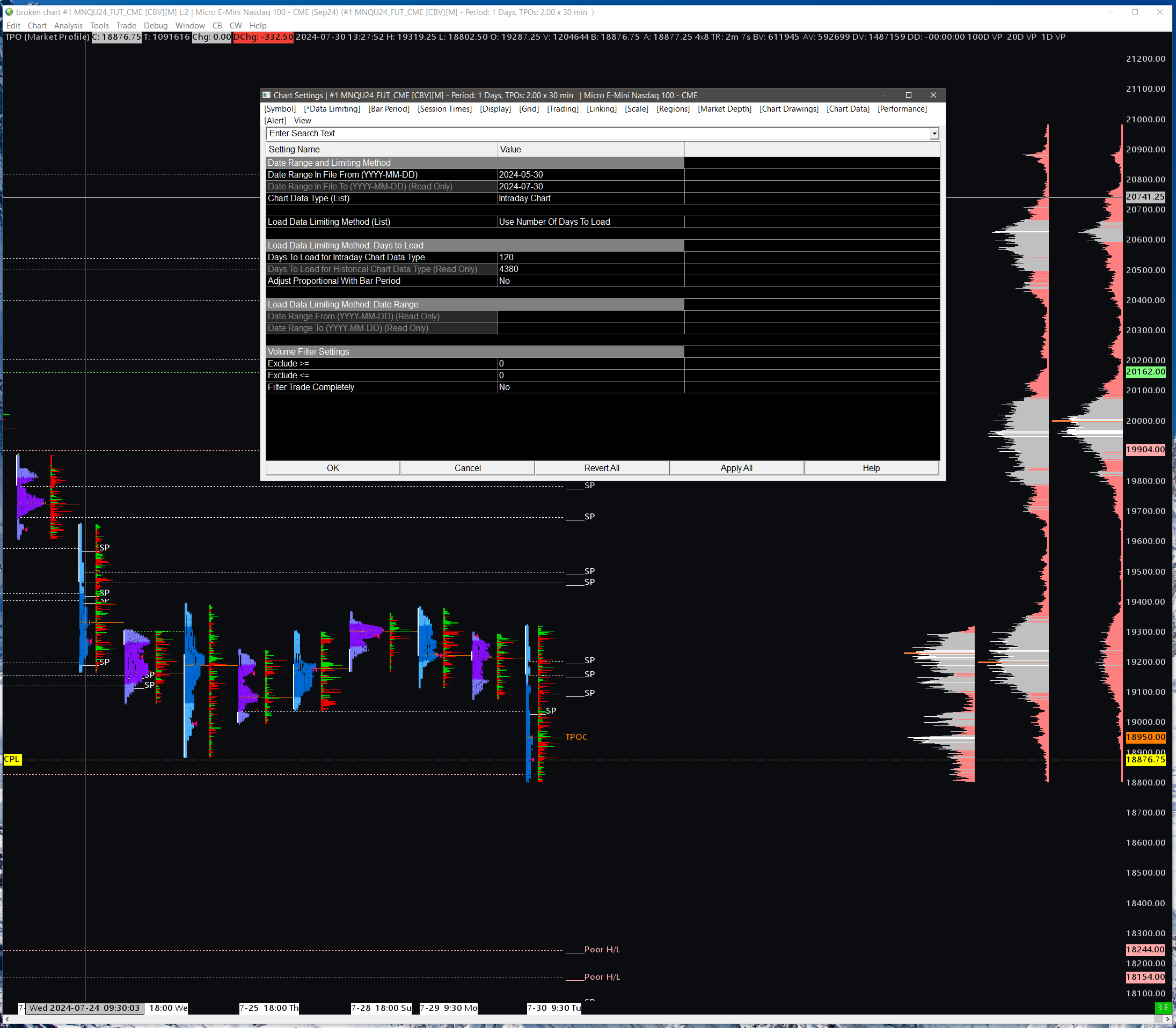

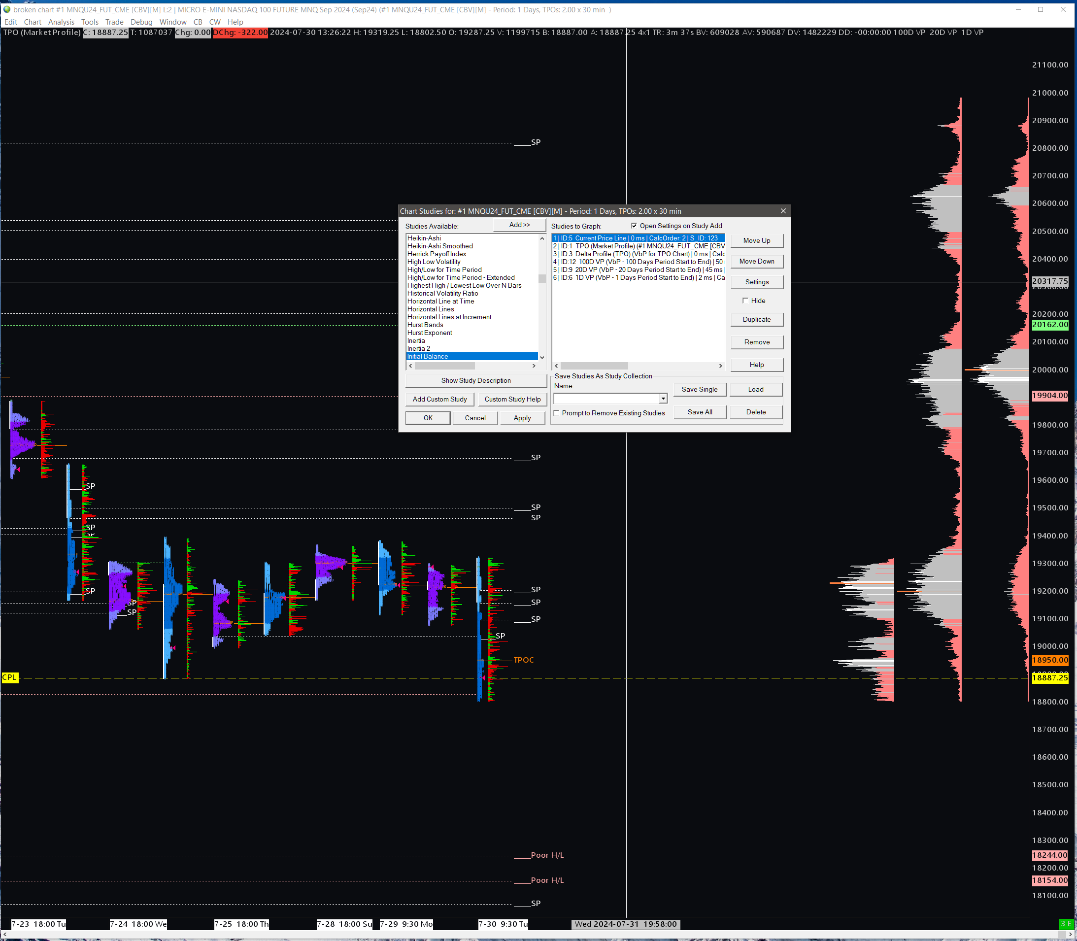

The attached chartbook has a fairly common Daily TPO with a Delta Distribution showing both ETH and RTH for MNQ. One the right you will see 1, 20, and 100 Day Volume by Price Study. You can see the studies in the screen shot and also that I have 180 days of data loading. BUT, the 100 day volume profile is NOT correct. As you can see if it range limited to the same as the 20 day which is really odd. Not sure what is going on...
Please help,
Anthony
image2024-07-30_102802.png / V - Attached On 2024-07-30 17:30:43 UTC - Size: 369.15 KB - 174 views
image2024-07-30_102632.png / V - Attached On 2024-07-30 17:30:51 UTC - Size: 324.07 KB - 192 views

[2024-07-30 18:08:59]
We need to look into why the option for "One Period from Most Recent Period Start to End" is not working as it states it should.
Change the "Volume Graph Period Type" to "One Period at End of Fixed Time Length" for these profiles and you will then get what you are expecting. For now, do not use the option of "One Period from Most Recent Period Start to End".
