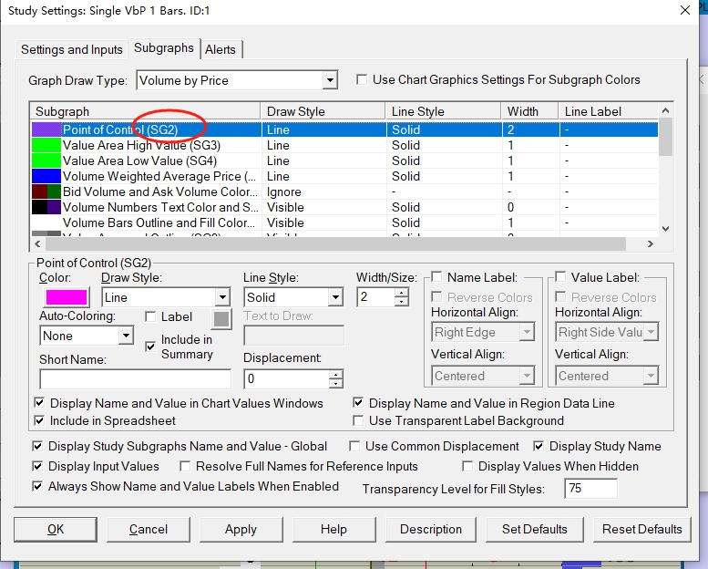

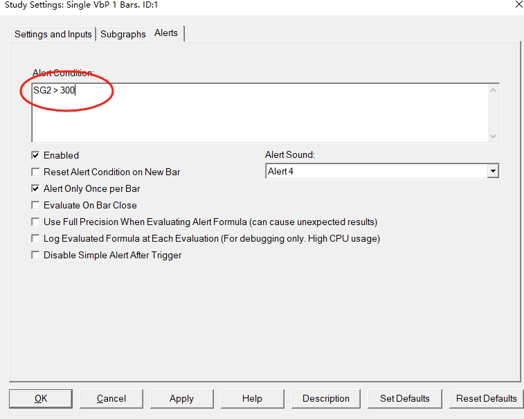

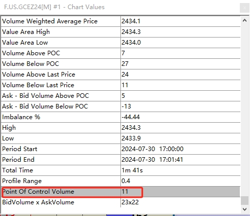

How to set an alert when the trading volume exceeds a certain value.
I want to set an alert when POINT OF CONTROL VOLUME > 300

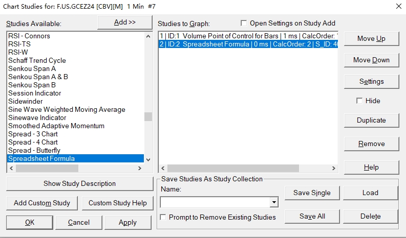

[2024-07-31 02:21:53]

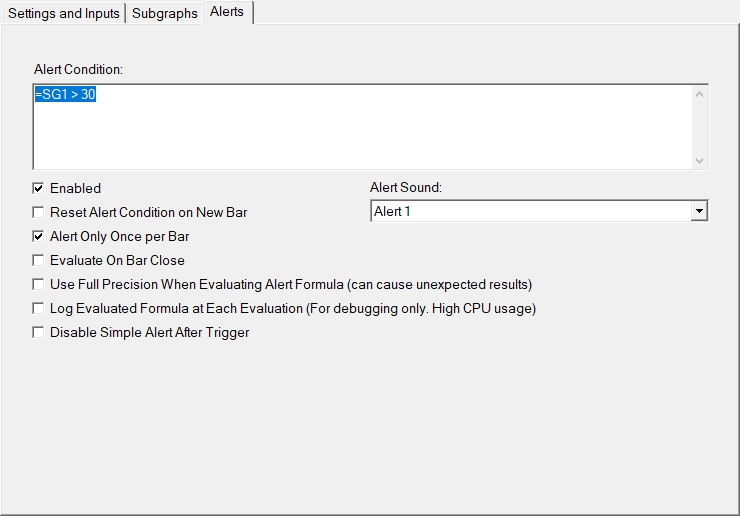

User1989 - Posts: 7
After setting it up this way, there are no alarm notifications. Did I set it up incorrectly?"

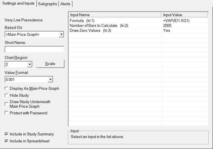

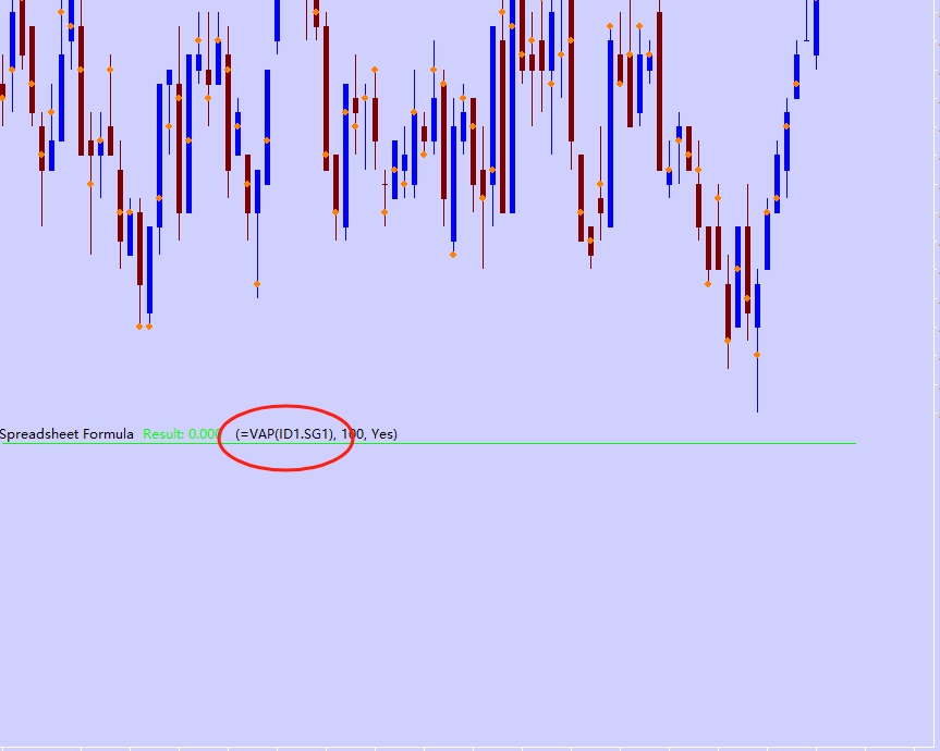

User1989 - Posts: 7
File attached

[2024-07-31 21:01:43]
Sawtooth - Posts: 4361
Use this formula in the Formula field of the Spreadsheet Formula study:
=VAP(ID1.SG1,0)
Study/Chart Alerts And Scanning: VAP
Suggestion:
To see a visual where the alert is TRUE, add the Color Bar Based On Alert Condition study, with a formula like this on its Alerts tab:
=ID2.SG1 > 300
where ID2 is the Spreadsheet Formula study.
