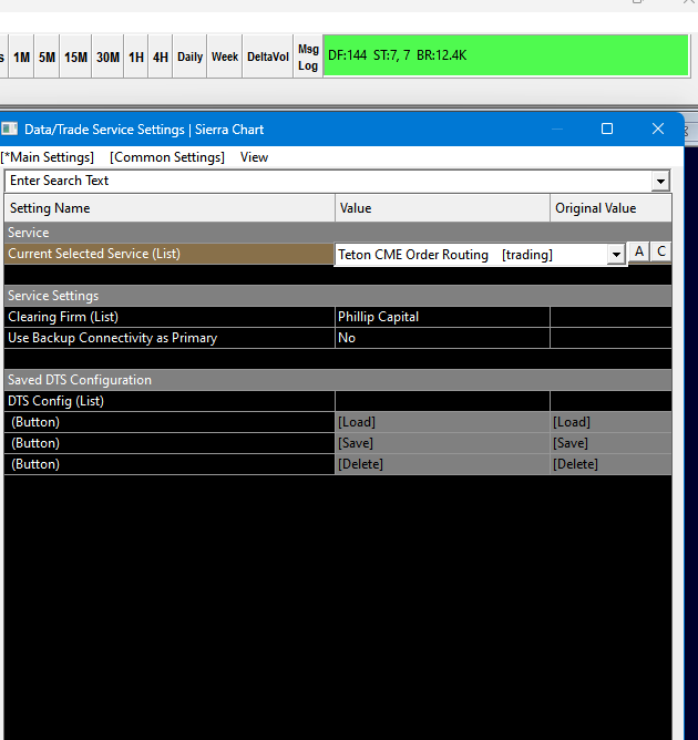

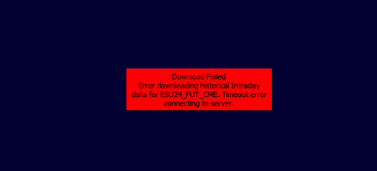

This morning my charts stopped working at 7am Pacific Time. I have tried many things ranging from deleting old intraday and daily data, restarting machine, connecting and disconnecting, etc.
See attached screenshots. I'm also attaching trading service configuration
Miguel Hidalgo
imageImage 007.png / V - Attached On 2024-07-16 15:37:15 UTC - Size: 18.82 KB - 252 views
imageImage 008.png / V - Attached On 2024-07-16 15:37:20 UTC - Size: 3.08 KB - 224 views
