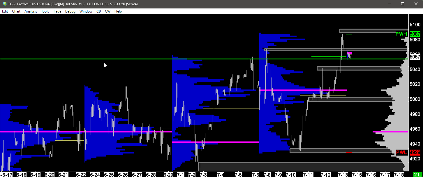

Some days tools, such as horizontal line, draw at the cursor point. Other days they do not. I can not work out why. The chart has title bar enabled. See image: my cursor where I clicked vs position of the green horizontal line

This problem persists. The cross hairs are not even at the cursor point, let alone drawings. Some observations:
- At the bottom of a chart window, the problem does not exist (see image bottom)
- At the top of a chart window, the problem is worse (see image top)
- This happens even with menu and title bar enabled, though the problem isn't as bad with these elements enabled
- It doesnt matter of a chart is attached or detached.
- If I make a duplication of the chartbook (duplicate all charts to chartbook) then the problem does not exist in the new chartbook, which to me rules out the operating system being at fault.

There may not be a problem here and only a misunderstanding. The Chart Values lines are not going to match the system cursor exactly because the vertical line is aligned to a chart bar and the horizontal line is going to be aligned to the Tick Size. The chart values lines do not match the cursor exactly. Most often they are not going to do that.
Date Time Of Last Edit: 2024-08-08 11:27:39
[2024-08-08 11:40:49]
User745789 - Posts: 402
I understand what you are saying.
But in this case, drawing objects draw well above the cursor. And selecting them with the cursor is almost impossible as you have no aim-off.
I do not believe it is what you have described.
Why would the gap change depending on the vertical position of the cursor? We talking half and inch on tbe screen
Date Time Of Last Edit: 2024-08-08 11:45:06
