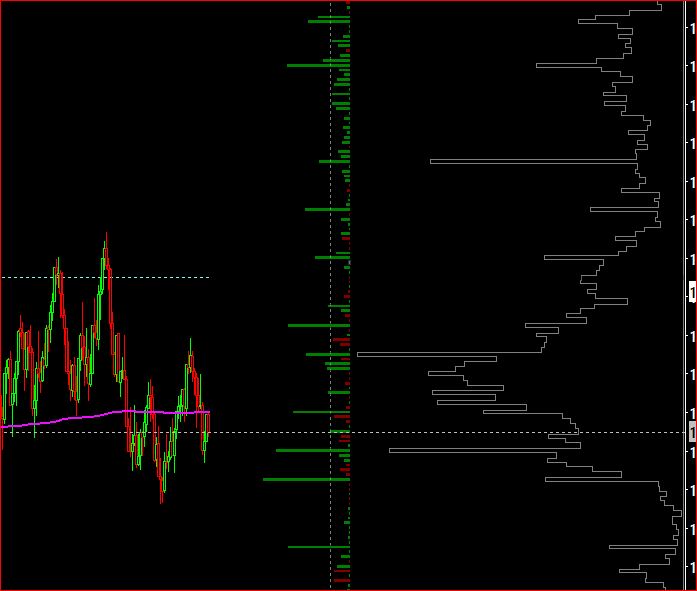

Hi I have 2 volume profiles (1 for total volume, 1 for delta) at the right side of the window. However they don't start from the same location, does anyone have similar problem?
imageCapture.JPG / V - Attached On 2024-07-10 19:32:13 UTC - Size: 42.59 KB - 197 views

We assume that you are wanting the profiles to overlap one another. If this is the case, then on the Volume by Price studies set the Input for "Allow Side-by-Side Profiles on Right Side" to "No". You need to change this for all the profiles that you want to overlap. Refer to the following:
Volume By Price Study: Allow Side-By-Side Profiles on Right Side
[2024-07-11 02:05:18]
User556806 - Posts: 28
Yes, it works!
