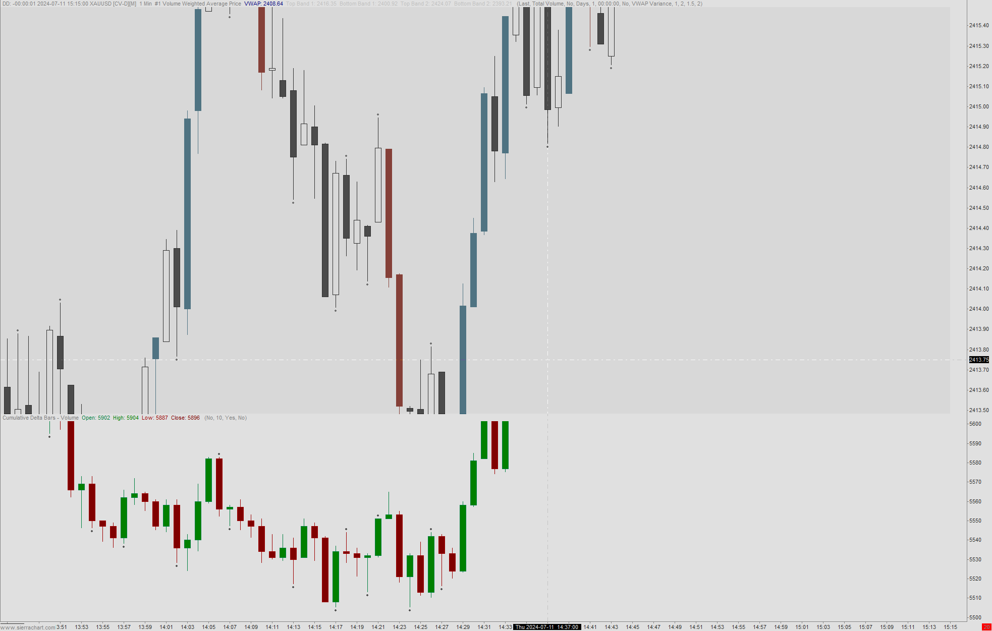

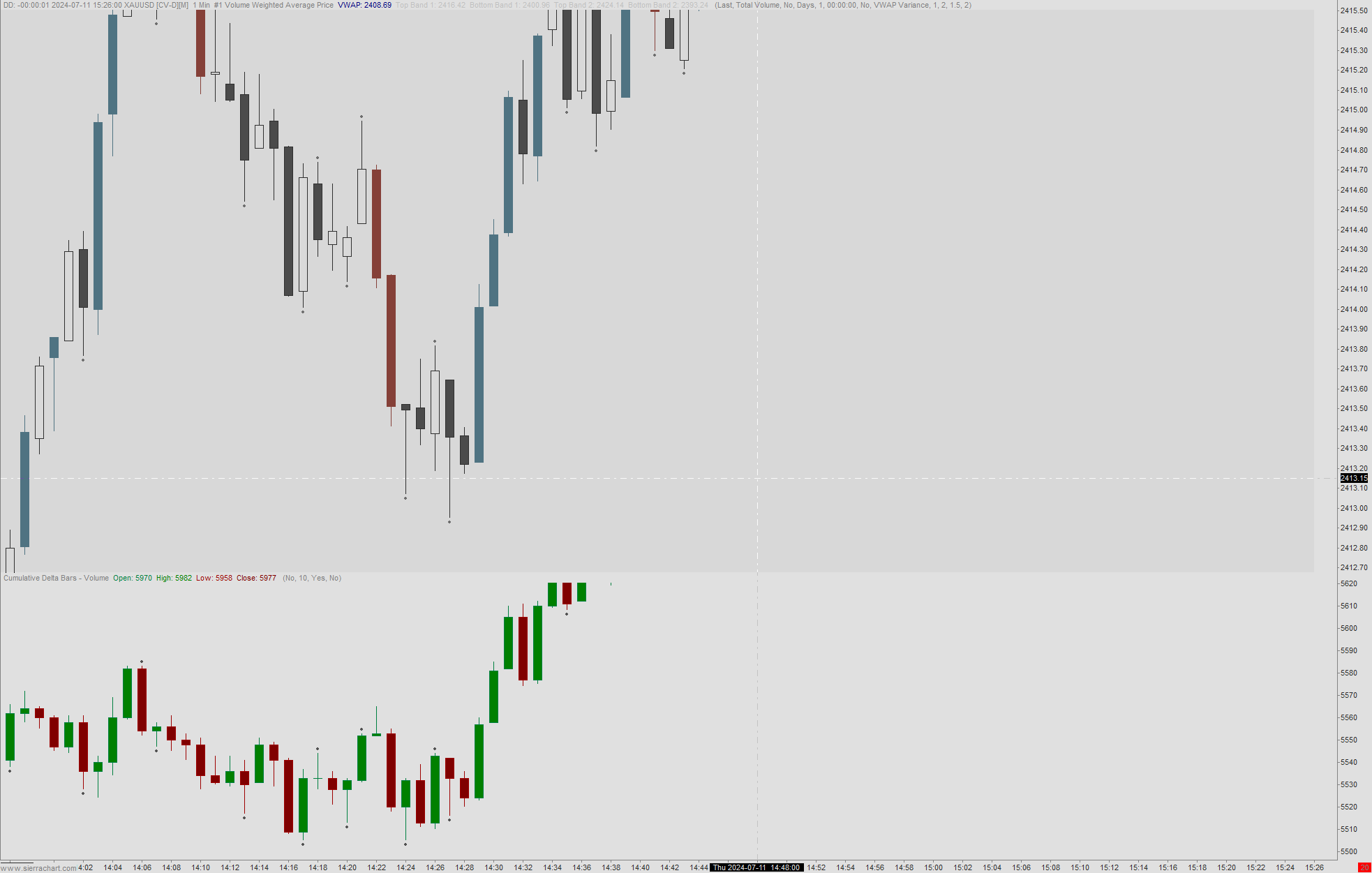

Kianxim - Posts: 7
It happened again yesterday on Gold FXCM, 1m chart, 14:20 Candle, candle close and it's CVD changed.
here is before, after re downloading data.
Before:
https://www.sierrachart.com/image.php?Image=1720790408186.png
After:
https://www.sierrachart.com/image.php?Image=1720790348235.png

[2024-07-13 16:01:15]
Kianxim - Posts: 7
The XAUUSD 1 minute data candle difference as I mentioned above is at 14:20 New York time , 11/7/2024. in screenshot you can notice that 14:20 candle was bullish and after I redownload the data it changed to a bearish candle. this problem keeps happening on random candles almost every day this is just one example.
