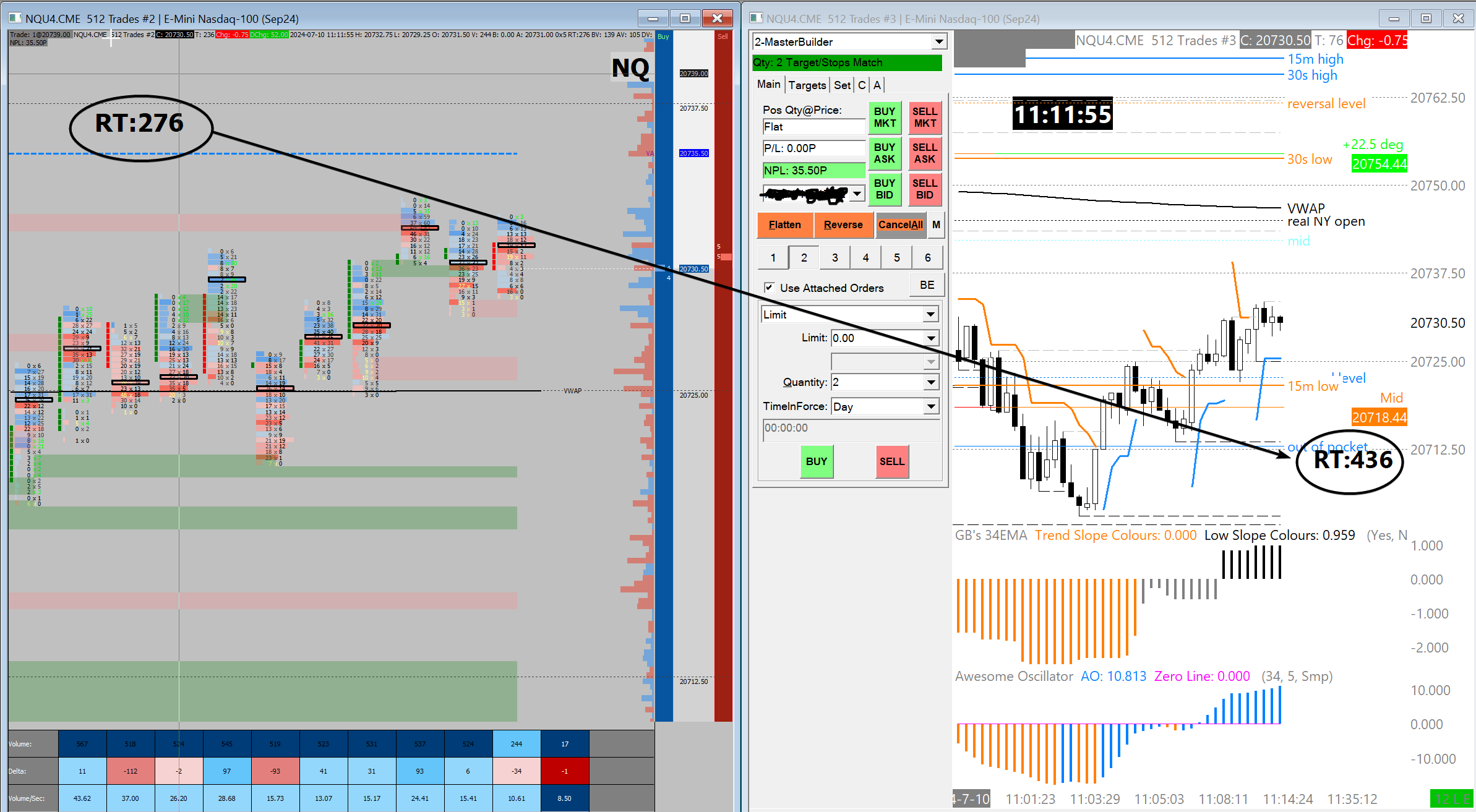

TheMatadorTrader - Posts: 23
I have 2 512 tick charts side by side but the countdown timer is different on each chart. Is there any way to sink the two charts?
imageHG1Xz4mLA6.png / V - Attached On 2024-07-10 15:14:28 UTC - Size: 240.46 KB - 477 views
[2024-07-10 15:38:44]
Make sure that the Countdown Timer is setup the same in both charts.
Also check the "Chart Update Interval" for both charts and make sure it is set the same for both. Refer to the following:
Chart Settings: Chart Update Interval in Milliseconds (Chart >> Chart Settings >> Display >> Chart Update Interval menu)
It would not be unusual for you to see small differences in the timer, but values you are seeing are far too different, so there has to be something that is causing this.
[2024-07-12 09:45:57]
Well - every setting check out the same. Over time the two charts are starting to come closer and now differ by just 20 ticks.

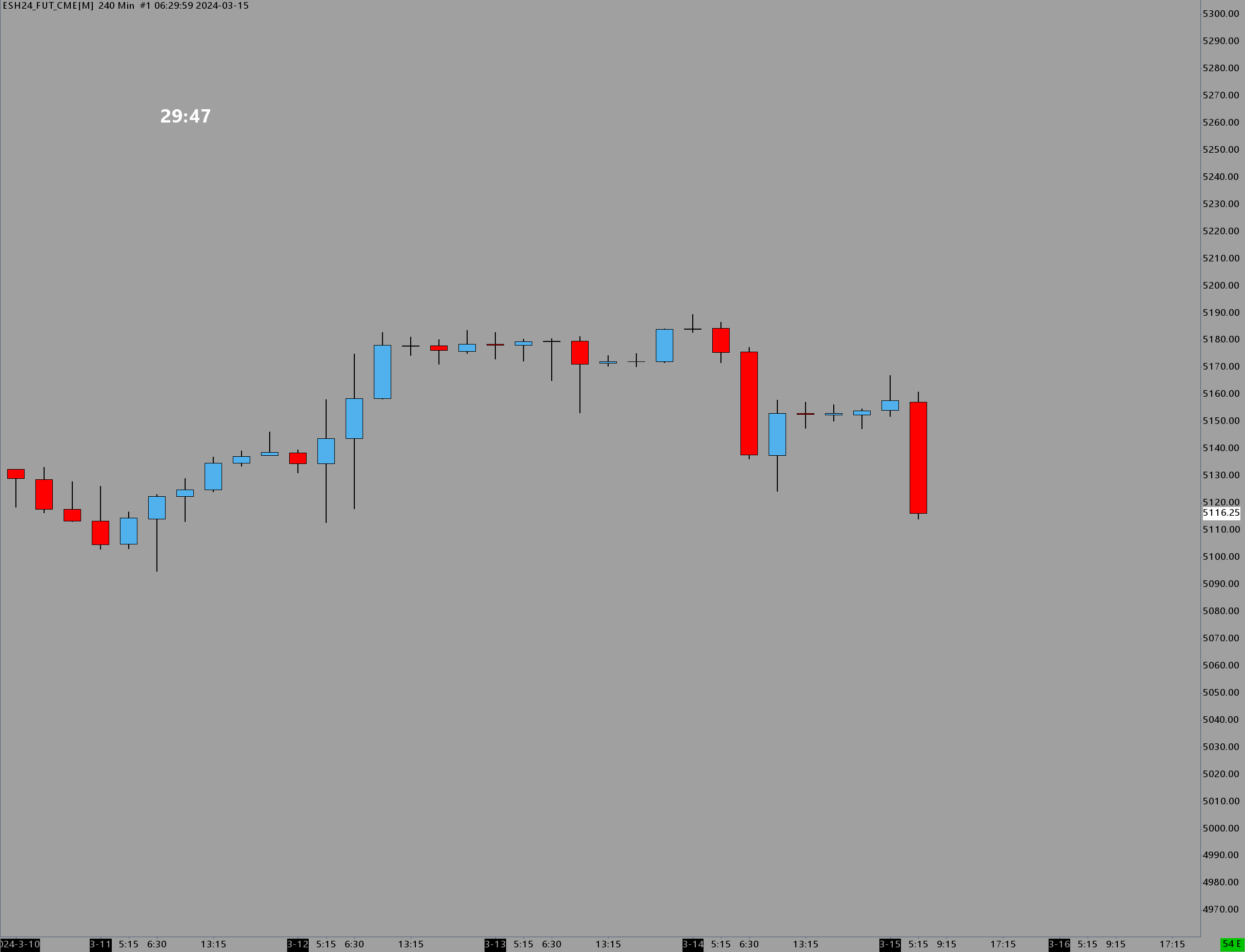

cmet - Posts: 747
Seems something may be wrong with countdown timer.
My 4 hour only shows a 60 min timer and the settings cannot be changed (font, text size, etc).
Deleted, reapplied, same result.
v2655.
[2024-07-12 15:33:34]
We are not understanding what you are seeing. Please give us an image by following these instructions:
You can only change the size of the font through the "Width/Size" option on the Subgraphs tab for the study. Otherwise the font it uses is the general Text font you have set for Sierra Chart.
[2024-07-12 15:47:02]
cmet - Posts: 747
4 hour chart with 60 min countdown timer. Didn't realize you could only use subgraph tab. Only issue is time shown.
https://www.sierrachart.com/image.php?Image=1720799112442.png

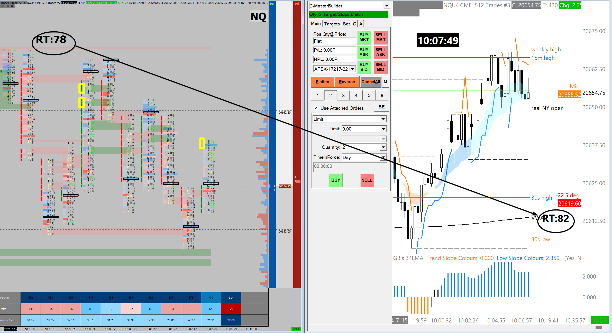

[2024-07-15 14:10:57]
To start the new week the tick countdown is very close - it seems to be syncing itself over time.
imageHak0W2W2Gw.png / V - Attached On 2024-07-15 14:10:45 UTC - Size: 267.36 KB - 394 views
