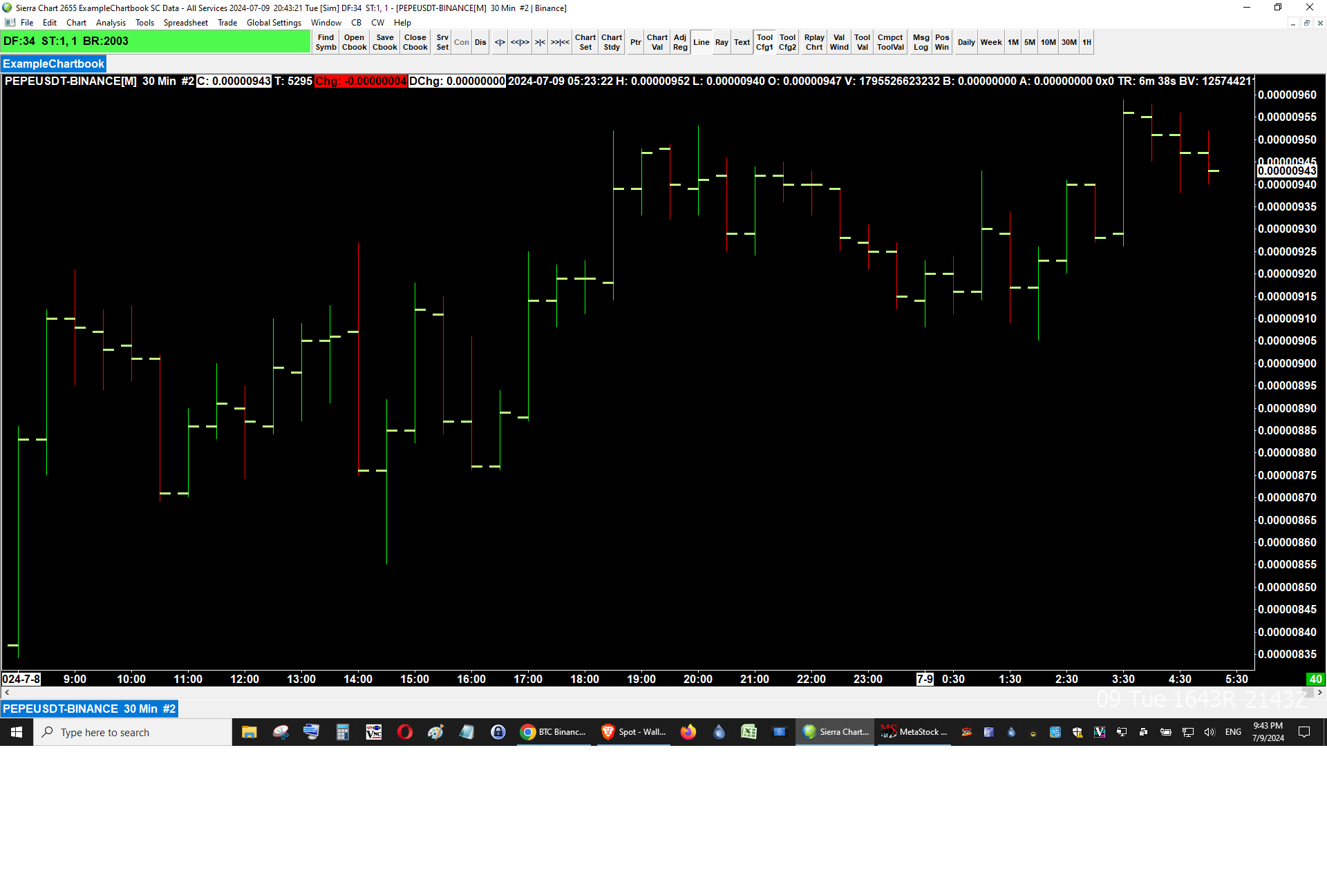

Correct the binance feed for BTCPEPEUSDT has stopped at 530AM for me as well and has not resumed for about 12 hours.
anyone else have this problem?
[2024-07-09 20:53:22]
xrpSWAN.com - Posts: 9
To upload the screenshot is streamllined but complicated and, last minute, I dont have time to figure out how to upload. Hopefully support can fix this. If not I will take time out tomorrow ti figure out the instruction set and upload. Then the binance feed might be fixed. If not ill make a phone call and hopefully get this solved

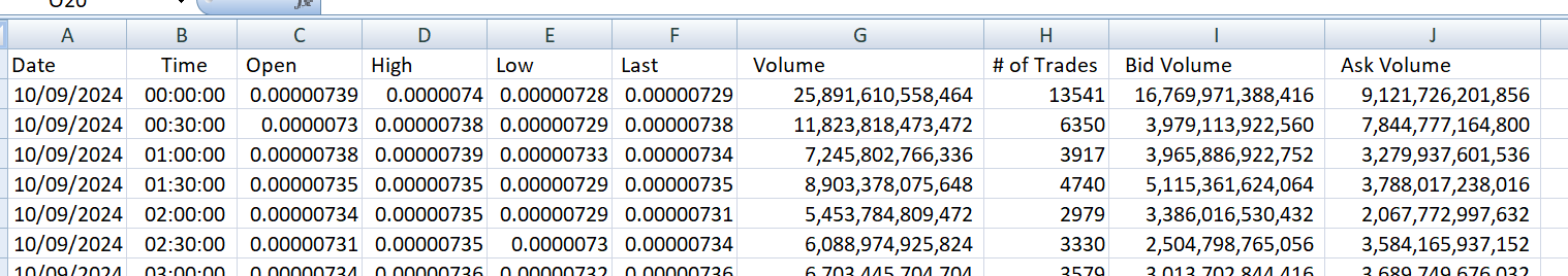

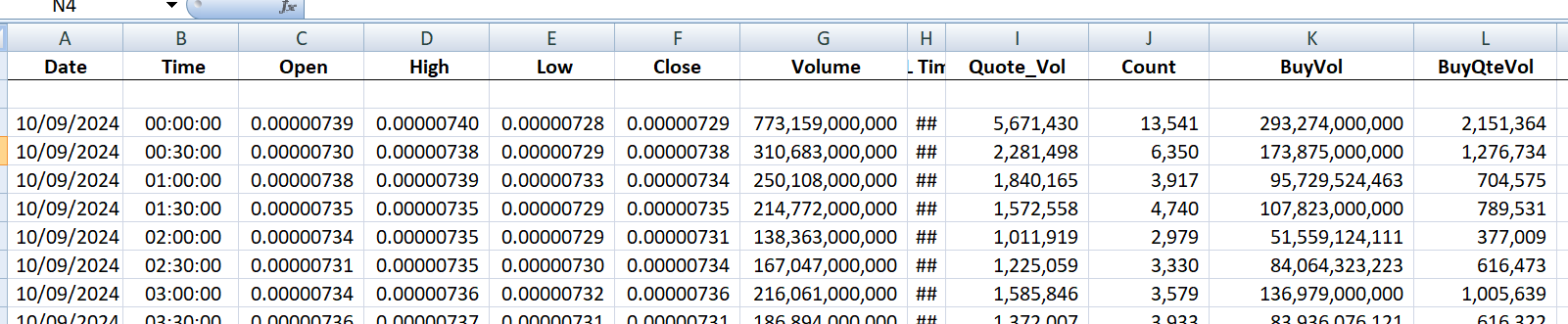

I decided to try to manually download the missing data from Binance in the meantime, and noticed that the Volume data is incorrect and has been incorrect since the beggining. It might be a mapping issue of some sort
I have attached the xls file which compared the Binance download versus the SC Write too Data file
Interestingly the Trade Count is correct on both files, buy the volume is way off and I can find no correlation whatsoever.
I think the whole data set might have to be fixed or remapped

Secondly, just going back to the Volume figures for PEPEUSDT-BINANCE[M] they are actually incorrect, I think you are pulling the Volume Data from another field on the Binance API and something else is coming out.
I am trying to attach an excel sheet examination of the actual Binance volume versus what Sierra is downloading, you can see the massive non-correlation.
Incidentally, I have tried downloading the PEPEUSDT data from the two other crypto providers as an alternative and nothing actually loads. Binance is unreliable, but I think they are the best source of data for crypto out there at the moment.

The volume data for Binance is always going to be incorrect. Do not rely on it and we are not going to spend any time looking at this. The volume data for crypto currencies from Binance, are in a fractional format and they are all multiplied by 10000. Any digits to the right of the decimal place which continue to exist are dropped.
