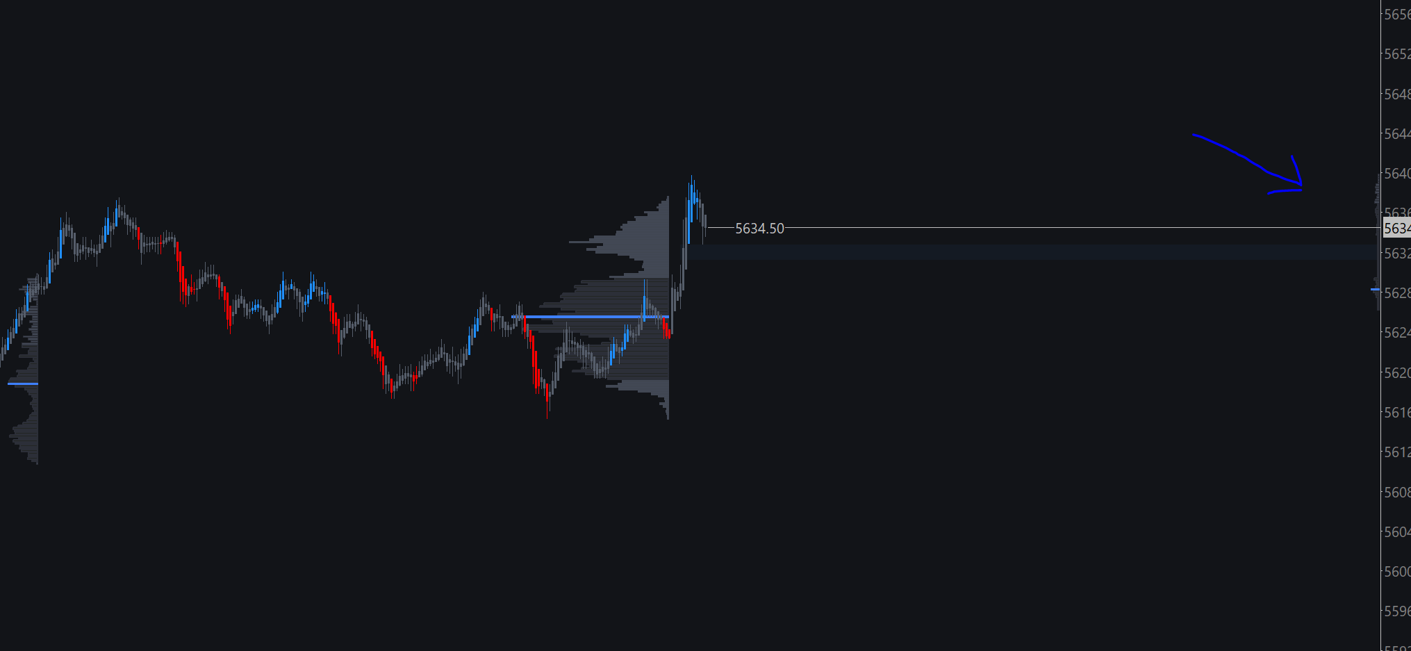

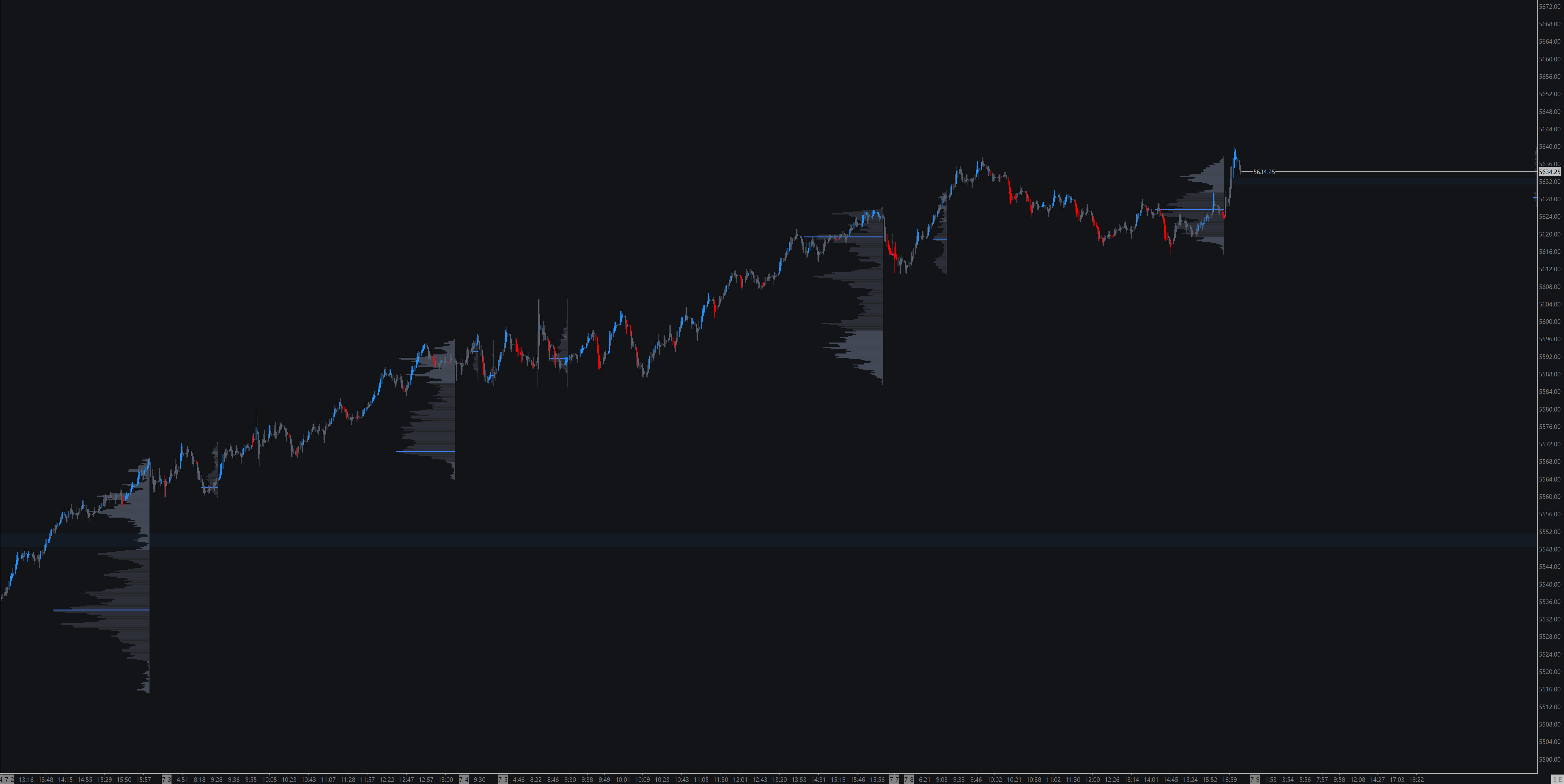

hello,
I have a daily profile chart setup but I'm running into a issue. I'm setting the last vp to always view. The problem I'm having is it's barely visable.
I had to minimize the settings for width on the other profiles so that my charts would not be nearly covered by volume profiles. It's just the last one that I can barely view. See the image below. The vp on the right axis can barely be seen.
Any suggestions for better/wider view of the last profile?
https://www.sierrachart.com/image.php?Image=1720493384669.png
image7-8 vp.PNG / V - Attached On 2024-07-09 02:44:28 UTC - Size: 43.15 KB - 257 views
[2024-07-09 15:26:04]
Rather than use the option for "Always Display Last Profile Within View", add a separate Volume by Price study and set it to be a single profile for the current day aligned to the far right, and then adjust the Volume Bar Width as needed for this one profile.
